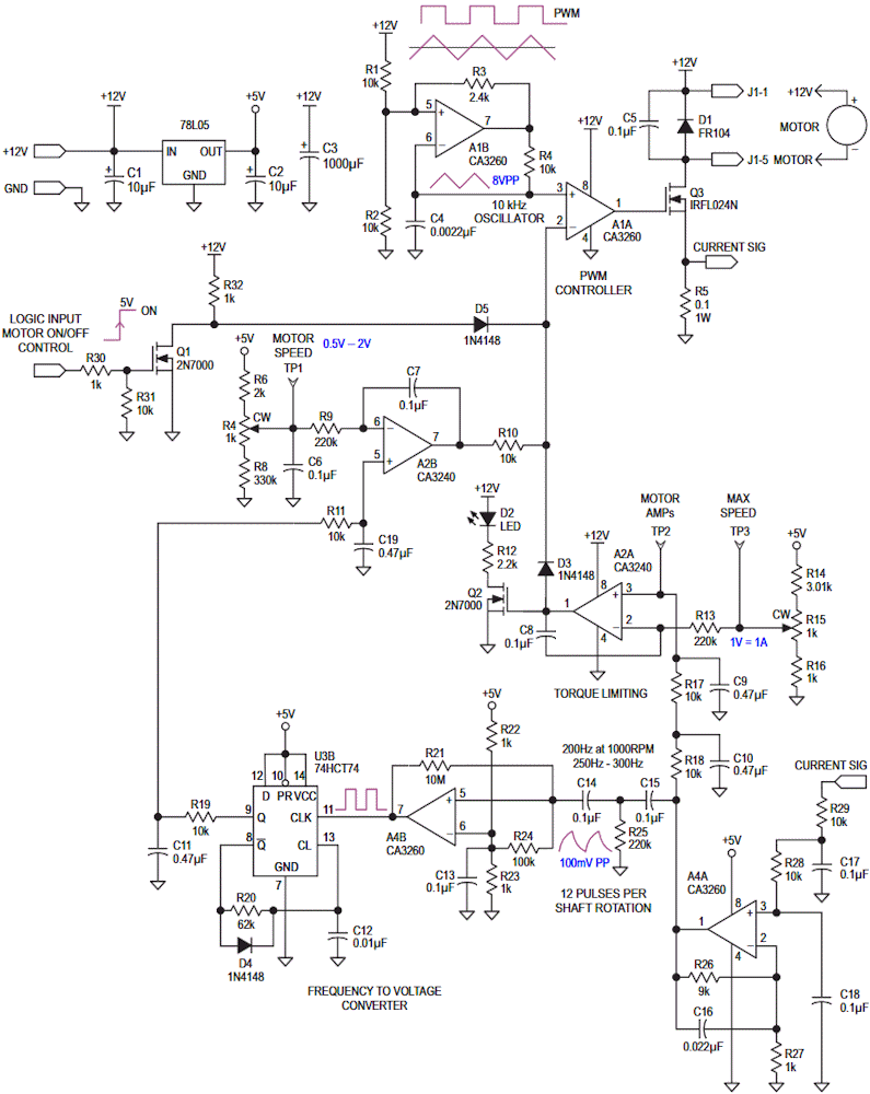

The circuit in Figure 1 is a speed control for a medium power 12 V DC operated single phase brush motor. It uses the brush current pulse method to monitor the motor speed. It includes a method to limit the average motor current. I have also included a means to turn on and off the motor from a simple TTL logic signal.
Schematic diagram of a 12 V brush motor speed controller.
Figure 1. Schematic diagram of a 12 V brush motor speed controller.
The circuit uses some rather old op Amp ICs I had laying around. Other op Amps and voltage comparators could also be used. The circuit uses a pulse width modulation (PWM) scheme to control both the motor speed and the maximum average current. The current control is handy when you want to limit the motor torque, since motor current and torque are directly related.
The circuit uses the current pulses from the motor brushes to extract the motor speed. For the motor I used, there were exactly 12 pulses per shaft rotation. The typical average motor current was about 1.2 Amps with a speed of about 1000 RPM. At 1000 RPM, the pulse frequency works out to be 200 Hz.
A 10 kHz ramp generating oscillator is used as the timing generator for the PWM circuit. An op amp compares the ramp voltage with the control voltage from either the current limiting circuit or the speed control circuit. When in current limit, the speed control part of the circuit is pushed out of the way. A multi-pole low pass filter, removes the brush current pulses from the motor, which appear across a small 0.1 ohm resistor. The pulses are amplified by a factor of X10 using A4. The signal from the pulse amplifier is then routed to a comparator circuit, which generates a square wave type signal. That signal is then connected to a one-shot circuit, which uses one half of a dual D-flip/flop IC. The output of the one shot is then filtered, to produce a voltage, proportional to the pulse frequency. An op amp then compares the speed signal to an adjustable reference signal. The output of the speed error amp, then is connected to the PWM circuit, to maintain a constant motor speed.
In a second circuit, the average DC current is monitored using the DC voltage across the 0.1 ohm shunt resistor. It too has an adjustable reference, so the limiting current (torque) can be controlled. A diode isolates the two control circuits from the PWM circuit. A second diode routes +5 V to the PWM control input, when the on/off input logic control signal is low. This pushes the PWM output signal low, keeping the motor turned off. A 5 V voltage regulator is used to provide a stable +5 V voltage to the speed and torque reference circuits.
