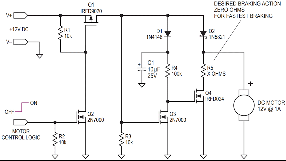

There are times when you would like to control a DC motor using a simple +5 V logic swing signal. The circuit below performs this feat and also includes an automatic motor braking circuit.
Logic controlled 12V DC motor with automatic brake
When the input logic signal swings from 0 V to +5 V, the n-channel MOSFET Q2 turns on, which turns on the p-channel MOSFET Q1. Current flows into the motor through the schottky diode D2. When the control logic swings back 0 V, Q1 turns off. This activates the braking action of Q4, which applies a short across the motor. The sudden stop is often desired in some motor controlled systems.
