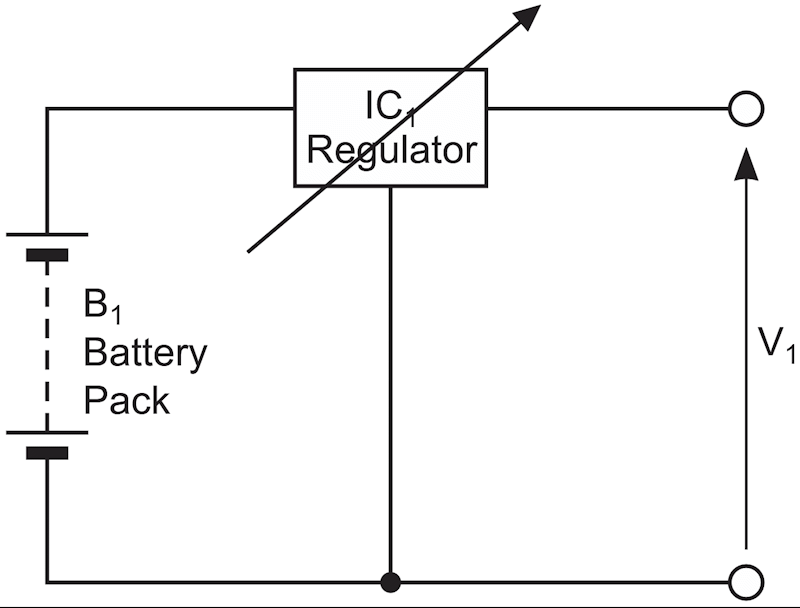

One solution is to eliminate the DC/DC converter and string together three or more Li-ion cells in a battery pack (B1) with a variable linear regulator (IC1) to generate the required 9 V (V1) as shown in Figure 1. Li-ion cells, like all electronic components, have tolerances. The two most important parameters are cell capacity and open circuit voltage. Differences in these parameters between cells in series lead to uneven charging and ultimately stressing of some cells, leading to their eventual degradation [2].
Li-ion battery pack, with 3 or more Li-ion cells, and a variable linear regulator to generate the required 9 V.
Figure 1. Li-ion battery pack, with 3 or more Li-ion cells, and a variable
To even out these differences, Li-ion battery packs often contain a battery management system (BMS) to ensure that cells charge evenly.

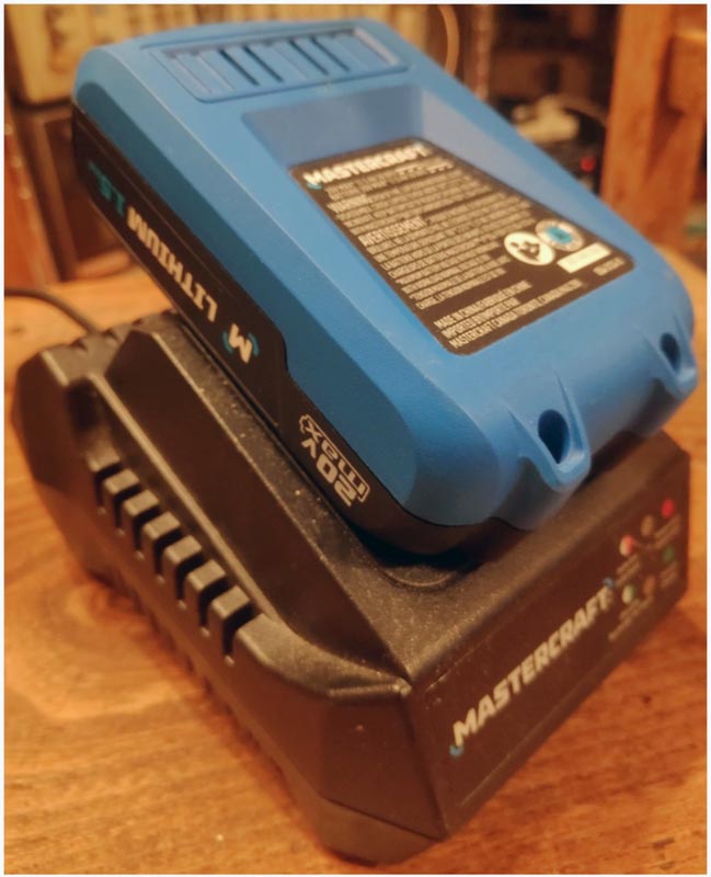

As luck would have it, on the local buy-nothing group in Ottawa, Canada, where I live, someone was giving away a Mastercraft 18-V Li-ion battery with charger as shown in Figure 2. The person offering it had misplaced the drill, so there was little expense for me. Upon opening the battery pack, it was indeed found to contain a battery management system (BMS). This seemed like an ideal solution.
The Mastercraft 18-V Li-ion battery and charger obtained locally.
Figure 2. The Mastercraft 18-V Li-ion battery and charger obtained locally.

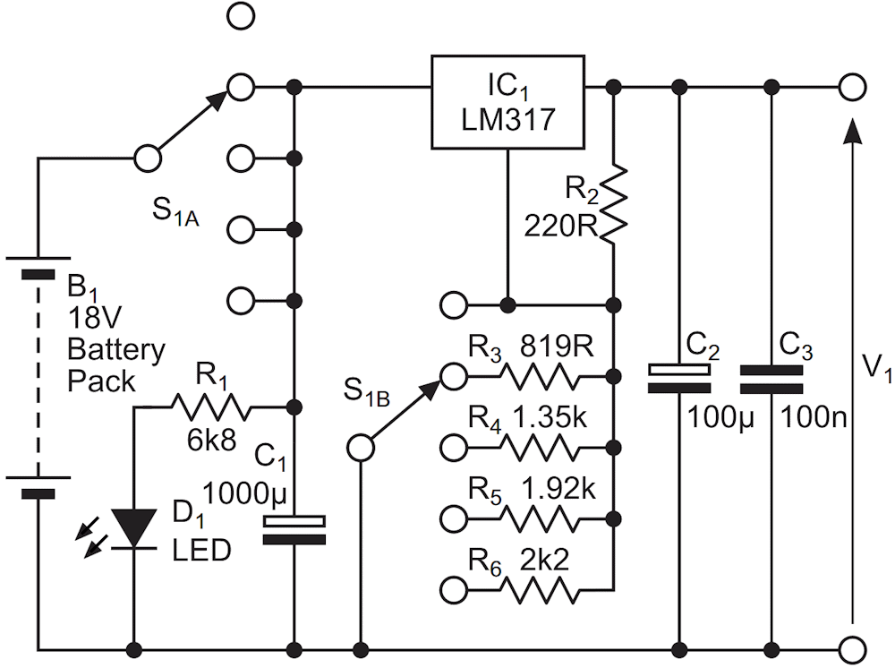

In one of my boxes of old projects, I found a constant current nickel-cadmium (NiCd) battery charger. It was based around an LM317 linear voltage regulator in a nice black plastic enclosure sold by Maplin Electronics as a “power supply” box. The NiCd battery hadn’t been used for over 20 years, so this project would be a repurpose. A schematic of the rewired power supply is shown in Figure 3.
The power supply schematic with four selectable output voltages - 6, 9, 12, and 13.8 V.
Figure 3. The power supply schematic with four selectable output voltages – 6, 9, 12, and 13.8 V.
In Figure 3, switch S1 functions as both the power switch and selects the output voltage. Four different output voltages are selectable based on current needs: 6 V, 9 V, 12 V, and 13.8 V can be chosen by adjusting the ratio of R2 and R3-R6 as shown in the LM317 datasheet. R2 is usually 220 Ω and develops 1.23 V across it, the remaining output voltage is developed across R3-R6. To get the exact values, parallel combinations are used as shown in Table 1.
Table 1. Different values of paralleled R3 to R6 resistors
and their combined value.
Resistor Resistors
(Ω)
Combined Value
(Ω)
R3 910, 18k, 15k 819
R4 1.5k, 22k, 33k 1.35k
R5 2.2k, 15k 1.92k
R6 2.2k 2.2k

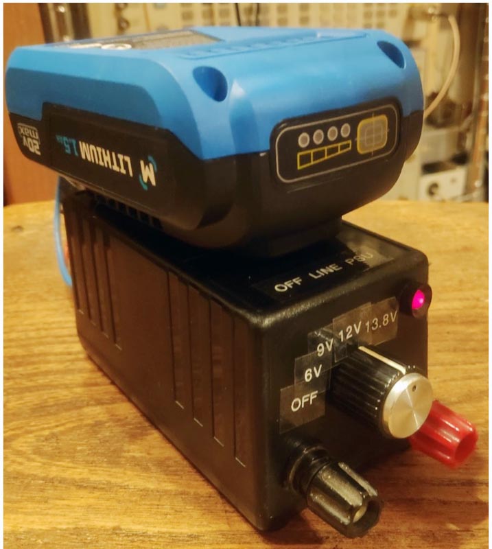

A photograph of the finished power supply with a Li-ion battery attached is shown in Figure 4.
A photograph of the finished power supply with four selectable output voltages that can be adjusted via a knob.
Figure 4. A photograph of the finished power supply with four selectable output
Results
Crimp-type spade connectors were fitted to the two input wires, which mated well with the terminals of the Li-ion battery. Maybe at some point, I will 3D-print a full connector for the battery. With the resistor values shown in Figure 3, the actual output voltages produced are: 5.96 V, 9.03 V, 12.15 V and 13.8 V. While these are not the actual designed values due to the use of preferred resistor values, it is of little consequence as the output voltage of disposable batteries varies over their operating time and there is of course a voltage drop due to cables. With this power supply, though, the output voltage of the power supply will remain constant during this time, even as the output voltage of the Li-ion drops due to its discharging.
