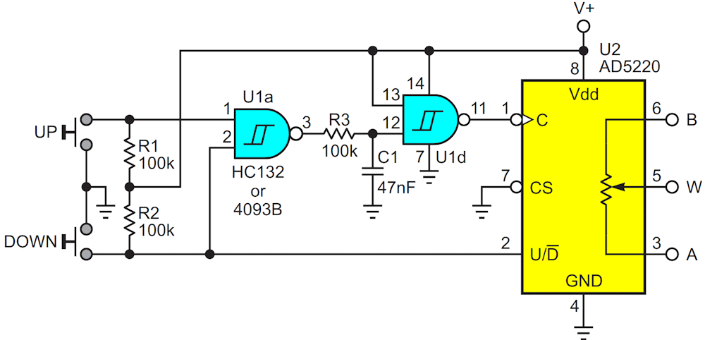

The basic (and obvious) way to interface people with DPOTs is illustrated in Figure 1, using push buttons to increment or decrement the setting, one pulse per push. It works. But it’s work!
In this reference circuit, Schmidt trigger U1 senses and de-bounces UP/DOWN momentary contact pushbuttons to (tediously) move the U2 setting by one position per push.
Figure 1. In this reference circuit, Schmidt trigger U1 senses and de-bounces UP/DOWN momentary contact

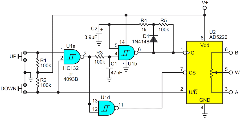

Figure 2 suggests a simple labor-saving remedy comprising just four added passive parts.
When a button is pushed down and held, the R5C2 time constant begins running. About a half second later, if the hold is still being held, the U1b multivibrator starts up, generating auto-repeating pulses at roughly 4 Hz for as long as the hold-down continues.
Figure 2. When a button is pushed down and held, the R5C2 time constant begins running. About a half second later, if the hold
If we add the illustrated components to U1b, its basic function of contact bounce filter will be unaffected. That’s unless a button-down condition lasts longer than about a half second. If that happens, then C2 will discharge to below the pin 5 low-going Schmidt trigger threshold of V+/3, driving pin 6 high.
Now C2 will be quickly recharged through D1 and R4 (this takes ~3 ms), generating another clock pulse to the pot that will duplicate the initial actuation. And so on and so forth, at 4 Hz or so, until the button is released. Note that C2’s timeout between auto-repeats is shorter than the initial delay before they start. That’s because auto-repeat recharge ends at the Schmidt high-going threshold of only ~(2/3)V+ instead of running all the way up to V+ like it does between button pushes.
So what’s U1d for? Well, when the pot arrives at the desired setting and the button is released, the R3C1 debounce time constant prevents the news from instantly arriving at U1b. Therefore, depending on how close C2 was to completing an autorepeat cycle, it’s possible that it will timeout before C1 does. If so, a bogus clock pulse and unintended pot increment could then theoretically occur.
To prevent this, U1d does a fast end-run around the auto-repeat oscillator to disable U2’s CS input. So even if the spurious pulse happens, the pot won’t see it. Not a big thing, but the gate was going to go to waste, anyway.
