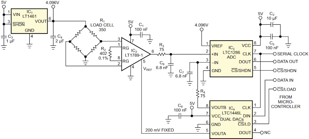

This Design Idea shows how to achieve hardware compensation using a microcontroller that, on power-up, starts a software routine to reset the system offset. The solution is a simple circuit based on four ICs from Linear Technology in Figure 1. A precision voltage reference, IC1, has a high minimum output current of 50 mA. It provides an output voltage of 4.096 V to power the load cell and to set the full-scale of the 12-bit ADC, IC3. The highly accurate LT1789-1 instrumentation amplifier, IC2, features maximum input-offset voltage of 150 µV over the temperature range of 0 to 70 °C and maximum input-drift-offset voltage of 0.5 µV/°C over the temperature range of 0 to 70 °C with rail-to-rail output that swings within 110 mV of ground. You set the gain through precision resistor R2 to a nominal value of 500 Ω to give an output span of 4.096 V when the load is 5 kg and its maximum input signal is
VCC × S = 4.096 V × 2 mV/V = 8.192 mV,
where S is the sensor’s sensitivity.
The serial dual DAC in this circuit gets an offset voltage from the microprocessor (not shown) during a power-on calibration routine.
Figure 1. The serial dual DAC in this circuit gets an offset voltage from the microprocessor (not shown) during a power-on calibration routine.
The output of DAC_A of dual-DAC IC4 provides a reference voltage of 200 mV at the reference pin of the instrumentation amp to avoid saturation near ground of the amplifier itself, where its transfer characteristic is not quite linear. The amplifier’s total worst-case output offset is:
VREF + VPAN ± VOFFSET = 200 mV + 125 mV ± 500 × 150 µV = 325 mV ± 75 mV = 250 mV/400 mV,
where VPAN = 125 mV and is the voltage that the pan’s weight produces.
The system-output offset is thus 250 to 400 mV. On power-up, the microcontroller starts a routine that sets the output of the DAC_A equal to 200 mV, while it increases the output of the DAC_B of dual-DAC IC4 until it is equal to the system offset on Pin 2 of ADC IC3, and the result of the conversion is 000h. This result is possible because IC4 contains two 12-bit DACs with the same full-scale voltage of 2.5 V, making 1 LSB equal to 0.61 mV, which is smaller than IC3’s resolution of 1 mV. This figure corresponds to the resolution of the balance: 5000 g/4096 = 1.22 g. The maximum output voltage of the instrumentation amp with a maximum load of 5 kg is
4.096 V + VTOT = 4.346 V/4.496 V,
which is less than the minimum worst case over temperature of 4.62 V high saturation.
Here VTOT is the total offset voltage of the instrumentation amp.
IC3 has a single unipolar differential input, so you can subtract from the +IN input voltage a constant voltage of value equal to the system offset that that DAC_B of IC4 provides. During the first one and a half clock cycles, the ADC samples and holds the positive input. At the end of this phase, or acquisition time, the input capacitor switches to the negative input, and the conversion starts. The RC-input filters on the inputs of IC3 have a time constant of 0.5 µsec to permit the negative and positive input voltages to settle to a 12-bit accuracy during the first clock cycle of the conversion time, using the maximum clock frequency, which is 200 kHz. If you want to increase the time constant, then you must use a lower clock frequency.
Furthermore, the DAC and ADC have a three-wire serial interface that easily permits transferring data to a wide range of microcontrollers with a maximum sampling rate of 12.5k samples/sec. When the ADC performs no conversions, it automatically powers down to 1 nA of supply current, and, if the microcontroller shuts down IC1 through its Pin 3, the circuit draws a worst-case supply current of just 1 mA, because all the ICs are micropower.
