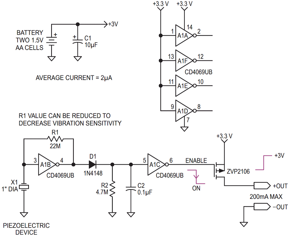

Piezoelectric vibration sensor activates …
Piezoelectric vibration sensor activates switch
Sep 7, 2026
Texas Instruments CD4069UB
David A. Johnson
An inexpensive piezoelectric wafer is used to detect vibration and when the vibration is sufficient a switch is activated.
