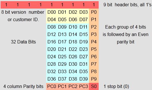

The RFID tag content (Figure 6).
Внешний вид модуля RFID считывателя
Figure 6. 125kHz RFID tag transmits 64 bits.
    The 125kHz RFID tag transmits 64 bits.
  1. The first 9 bits are the start communication bits ( always '1' ).
  2. The next 4 bits are the Low Significant Bits of the customer ID(D00,...,D03).
  3. The next 1 bit (P0) is the Even parity bit of the previous 4 bits .
  4. The next 4 bits are the High Significant Bits of the customer ID (D04,...,D07).
  5. The next 1 bit (P1) is the Even parity bit of the previous 4 bits.
  6. The next 4 bits are first part of the 32-bit Tag's serial number (D08,...,D11).
  7.  ...
  8. The PC0 bit is the Even parity bit of bits D00, D04, D08, D12, D16, D20, D24, D28, D32 and D36 (the bits on the same column).
  9. The PC1, PC2, PC3 bits represent the parity bits of the next 3 columns.
The data verification is been done from ATtiny13 by calculating the Even parity bit of each line and each column with the parity bits that had been received form the RFID Tag transmitted data.

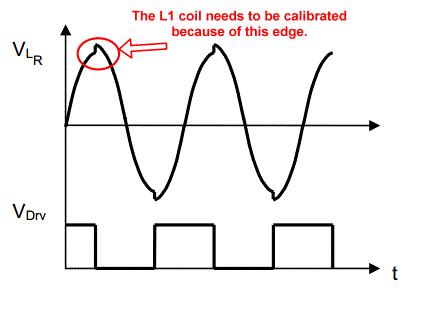

The coil has 120 mm diameter and 58 turns. Just in case leave more copper wire for additional 2-3 turns (60-61 turns total). To achieve maximum distance between the RFID Tag and reader (between Tag and reader's antenna-coil) you need to calibrate the coil. If you connect an oscilloscope to the point that R1 and L1 are connected you will see the red marked spot of noising on the left picture. That is  a sign that L1 must be calibrated (Figure 7).
Принципиальная схема RFID считывателя.
Figure 7. To achieve maximum distance between the RFID Tag and reader you need to calibrate the coil.
How can you calibrate the L1 ?
    Power on the RFID reader and:
  1. After you connect an oscilloscope probe to the R1, L1 connection point try slowly to remove or add more cooper wire (more or less turns) to the coil until the noise will be eliminated.
  2. If you don't have an oscilloscope then try to move your RFID tag close to the L1 until the tag will be recognized by the reader. If your Tag will be recognized to the distance of 2 cm from the L1, try to add more turns (more cooper wire) to L1 to see if this time your Tag will be recognized from longer distance (3 cm for example).
Try the same by removing turns (cooper wire) from the L1. Finally you will achieve the maximum range between your Tags and the L1.
I made the (L1) 120 mm diameter and 58 turns but afterward I wanted to make it in smaller size. So, I folded the coil to the half to make it as a "figure eight" (the shape seems like the 8 number ) and I did again the calibration. That's why the coil L1 on the pictures seems smaller than 120 mm.
