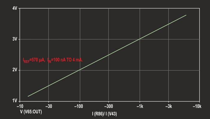

VOUT has IREF programmed to full scale of 570 µA.
Figure 2. VOUT has IREF programmed to full scale of 570 µA.

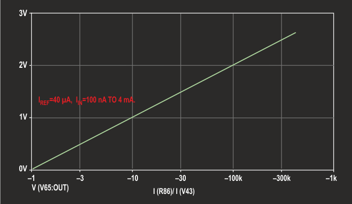

VOUT has IREF programmed to zero scale of 40 µA.
Figure 3. VOUT has IREF programmed to zero scale of 40 µA.
The combination of the REF191 and the AD5201 provides a current source that is stable with respect to time and temperature. For higher resolution, you can use the 1024-position AD5231. The AD8626 is a dual precision-JFET-input amplifier with true single-supply operation to 26 V, low power consumption, and rail-to-rail output swing, allowing a wide dynamic range. Its output is stable with capacitive loads in excess of 500 pF. Figure 2 and Figure 3 show the transfer function of the log-ratio amplifier at the input of the ADC. The output is limited to 0 to 4 V to match the unipolar input-voltage range of the AD7810 ADC.
