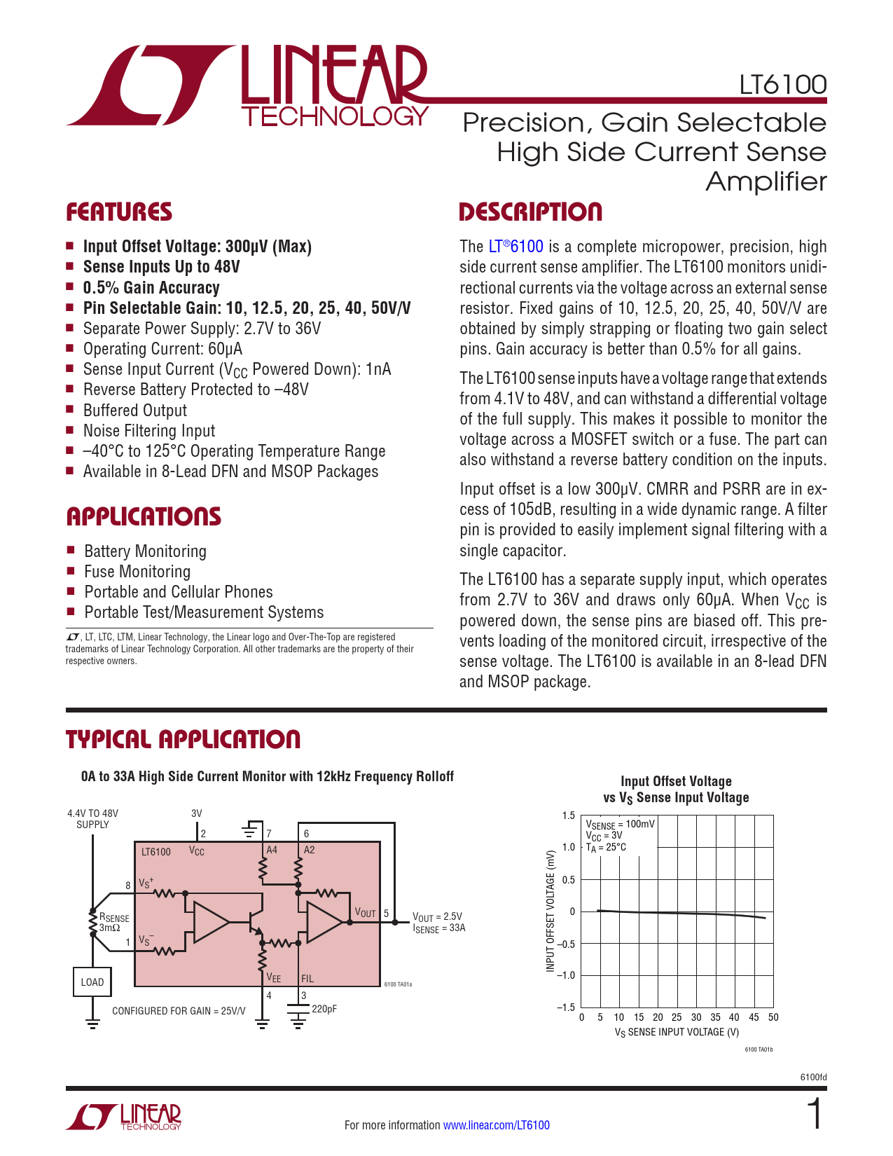

TYPICAL APPLICATION 0A to 33A High Side Current Monitor with 12kHz Frequency Rolloff Input Offset Voltage vs VS Sense Input Voltage
4.4V TO 48V 3V 1.5 SUPPLY VSENSE = 100mV 2 7 6 VCC = 3V LT6100 V 1.0 T CC A4 A2 A = 25°C V + 8 S 0.5 TAGE (mV) VOUT R 0 SENSE 5 VOUT = 2.5V 3mΩ ISENSE = 33A V – 1 S –0.5 INPUT OFFSET VOL VEE FIL –1.0 LOAD 6100 TA01a 4 3 CONFIGURED FOR GAIN = 25V/V 220pF –1.5 0 5 10 15 20 25 30 35 40 45 50 VS SENSE INPUT VOLTAGE (V) 6100 TA01b 6100fd For more information www.linear.com/LT6100 1
