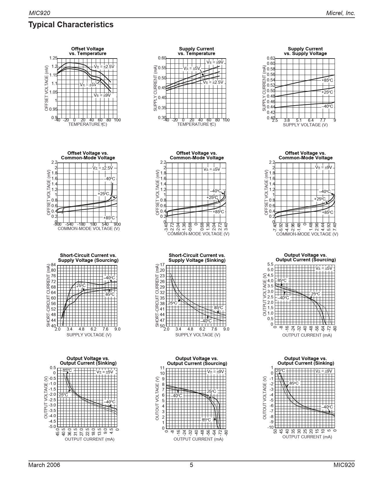

Pages / Page11 / 5 — Typical Characteristics. Offset Voltage. Supply Current. vs. Temperature. …
Typical Characteristics. Offset Voltage. Supply Current. vs. Temperature. vs. Supply Voltage. Offset Voltage vs
Typical Characteristics Offset Voltage Supply Current vs Temperature vs Supply Voltage Offset Voltage vs
MIC920 Micrel, Inc.
Typical Characteristics Offset Voltage Supply Current Supply Current vs. Temperature vs. Temperature vs. Supply Voltage
1.25 0.60 0.62 V± = ±9V ) 0.60 1.2 ) V V± = ±2.5V A 0.55 V± = ±5V A m 0.58 ( m m 1.15 ( E T 0.56 T G N 0.50 N A 0.54 +85°C 1.1 E E T V± = ±2.5V L V± = ±5V R R 0.52 O R 0.45 R V 1.05 U U C 0.50 C +25°C T V± = ±9V E Y 0.40 Y 0.48 S 1 L L F P P 0.46 F P P –40°C O 0.95 U 0.35 U 0.44 S S 0.42 0.9 -40 -20 0 20 40 60 80 100 0.30 -40 -20 0 20 40 60 80 100 0.40 2.5 3.8 5.1 6.4 7.7 9 TEMPERATURE (°C) TEMPERATURE (°C) SUPPLY VOLTAGE (V)
Offset Voltage vs. Offset Voltage vs. Offset Voltage vs. Common-Mode Voltage Common-Mode Voltage Common-Mode Voltage
2.2 2.2 2.2 2 ) V± = ±2.5V 2 V± = ±5V 2 V± = ±9V V ) 1.8 V V m 1.8 1.8 ( 1.6 m( m( E –40°C 1.6 E 1.6 E G 1.4 A G 1.4 G 1.4 T A A 1.2 L T 1.2 L –40°C T 1.2 L O –40°C 1 +25°C V O 1 V O +25°C 1 V T 0.8 T 0.8 T 0.8 +25°C ES 0.6 E E F S 0.6 S 0.6 F F F 0.4 F F O 0.4 +85°C 0.4 +85°C 0.2 O O +85°C 0.2 0.2 0 -900 -540 -180 180 540 900 0 0 2 4 6 8 0 8 6 4 2 0 0 0 2 4 6 8 0 8 6 4 2 0 COMMON-MODE VOLTAGE (V) .4 .7 .0 .3 6 6 3 0 7 4 4 9 .4 .9 4 4 9 4 9 4 3 . - 2- 2- 1- 0- 0 1 2 2 3 7- 5- 4- 2- 1- 1 2 4 5 7 COMMON-MODE VOLTAGE (V) COMMON-MODE VOLTAGE (V)
Short-Circuit Current vs. Short-Circuit Current vs. Output Voltage vs. Supply Voltage (Sourcing) Supply Voltage (Sinking) Output Current (Sourcing)
) 84 A ) 17 A 5.5 m V± = ±5V ( 80 m( 20 5.0 T 76 T )V 4.5 N –40°C 23 ( E N 72 E E 4.0 85°C R 26 R R G 68 25°C R A 3.5 U 29 U T C 64 C 32 L 3.0 T 85°C O 25°C I 60 TI V 2.5 U 35 U –40°C C T 56 C 38 25°C U 2.0 IR IR P C 52 85°C T 1.5 - C 41 T - U 48 T 1.0 R 44 R O O 44 O 0.5 H 47 –40°C S 40 HS 50 0 2.0 3.4 4.8 6.2 7.6 9.0 2.0 3.4 4.8 6.2 7.6 9.0 0 8- 61 4 2 0 8 6 4 2 0 - 2- 3- 4- 4- 5- 6- 7- 8- SUPPLY VOLTAGE (V) SUPPLY VOLTAGE (V) OUTPUT CURRENT (mA)
Output Voltage vs. Output Voltage vs. Output Voltage vs. Output Current (Sinking) Output Current (Sourcing) Output Current (Sinking)
0.5 11 1 0 85°C V± = ±5V 10 V± = ±9V 0 25°C V± = ±9V ) V -0.5 ( V 9 ( V -1 ( E -1.0 E 8 E -2 85°C G G G A -1.5 A 7 A -3 T T 25°C L -2.0 25°C L T 6 L -4 O O –40°C O V -2.5 –40°C V 5 V -5 TU -3.0 T T U 4 U -6 –40°C PT -3.5 O O T 3 T -7 U -4.0 U O 2 U O -8 85°C O -4.5 1 -9 -5.0 0 5 0 5 0 5 0 .5 0 .5 0 0 -10 . 0 8 5 0 6 1 7 2 8 3 9 4 - 6 0 1 4 2 0 8 6 4 2 0 4 4 3 3 2 2 1 1 - 2- 3- 4- 4- 5- 6- 7- 8- 5 54 04 53 03 52 02 51 01 5 0 OUTPUT CURRENT (mA) OUTPUT CURRENT (mA) OUTPUT CURRENT (mA) March 2006 5 MIC920
