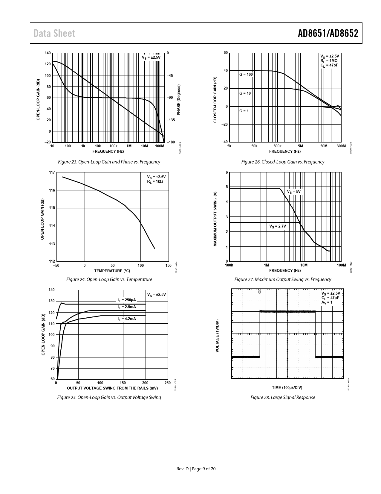

Data Sheet. AD8651/AD8652. 140. S = ±2.5V. 120. L = 1MΩ. CL = 47pF. 100. –45. G = 100. B d. rees). G = 10. –90. D (. O O. G = 1. HAS P. S O. –135. L C. –20. –180
Data Sheet AD8651/AD8652 140 S = ±2.5V 120 L = 1MΩ CL = 47pF 100 –45 G = 100 B d rees) G = 10 –90 D ( O O G = 1 HAS P S O –135 L C –20 –180
Data Sheet AD8651/AD8652 140 0 60 V V S = ±2.5V S = ±2.5V R 120 L = 1MΩ CL = 47pF 40 100 –45 G = 100 ) ) B B d (d ( 80 IN IN 20 rees) A G = 10 G GA eg P P 60 –90 D ( O O OO E -L -L 0 40 D N E G = 1 E HAS P S O OP 20 –135 L C –20 0 –20 –180

33 03 0 Figure 23. Open-Loop Gain and Phase vs. Frequency Figure 26. Closed-Loop Gain vs. Frequency
117 6 VS = ±2.5V RL = 1kΩ 5 116 ) V V S = 5V ) ( B G d IN 4 ( IN 115 SW T GA P 3 TPU OO U 114 -L VS = 2.7V N M O E 2 P O IMU X 113 MA 1 112

33 03 0 Figure 24. Open-Loop Gain vs. Temperature Figure 27. Maximum Output Swing vs. Frequency
140 V V S = ±2.5V S = ±2.5V C 130 I L = 47pF L = 250µA AV = 1 IL = 2.5mA 120 ) B I (d L = 4.2mA ) 110 IN IV A D G 1V/ 100 ( E OOP G -L TA N 90 E VOL OP 80 70 60

33 03 0 Figure 25. Open-Loop Gain vs. Output Voltage Swing Figure 28. Large Signal Response Rev. D | Page 9 of 20 Document Outline Features Applications Pin Configurations General Description Table of Contents Revision History Specifications Electrical Characteristics Absolute Maximum Ratings ESD Caution Thermal Resistance Typical Performance Characteristics Applications Theory of Operation Rail-to-Rail Output Stage Rail-to-Rail Input Stage Input Protection Overdrive Recovery Layout, Grounding, and Bypassing Considerations Power Supply Bypassing Grounding Leakage Currents Input Capacitance Output Capacitance Settling Time THD Readings vs. Common-Mode Voltage Driving a 16-Bit ADC Outline Dimensions Ordering Guide
