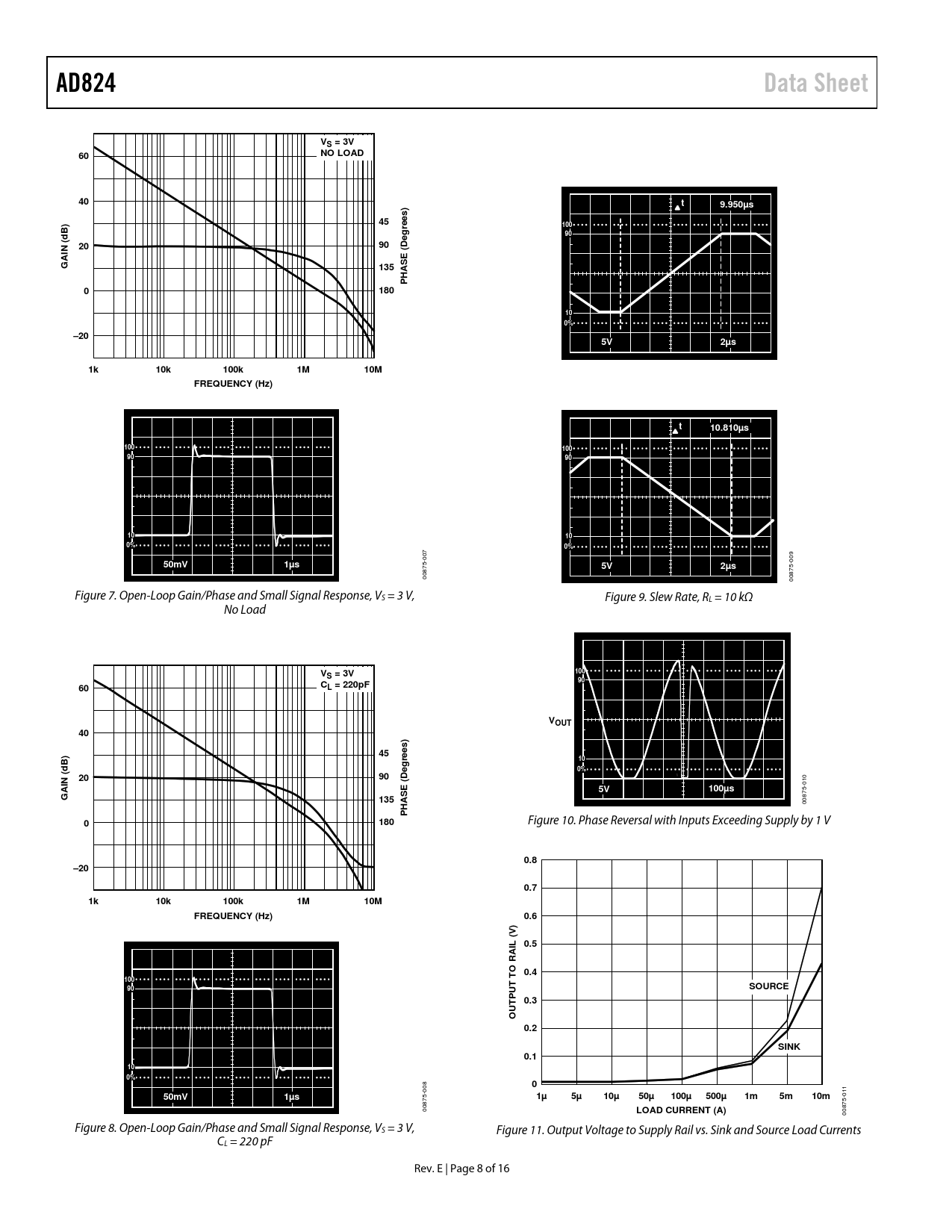

AD824. Data Sheet. VS = 3V. NO LOAD. 9.950µs. 100. rees). Deg. N (. 135. HAS P. 180. –20. 2µs. 10k. 100k. 10M. FREQUENCY (Hz). 10.810µs. 50mV. 1µs. S = 3V
AD824 Data Sheet VS = 3V NO LOAD 9.950µs 100 rees) Deg N ( 135 HAS P 180 –20 2µs 10k 100k 10M FREQUENCY (Hz) 10.810µs 50mV 1µs S = 3V
AD824 Data Sheet VS = 3V 60 NO LOAD 40 t 9.950µs 45 100 B) rees) d 90 20 90 Deg N ( ( AI E G 135 HAS P 0 180 10 0% –20 5V 2µs 1k 10k 100k 1M 10M FREQUENCY (Hz) t 10.810µs 100 100 90 90 10 10 0% 0%
007 009
50mV 1µs 5V 2µs
00875- 00875- Figure 7. Open-Loop Gain/Phase and Small Signal Response, VS = 3 V, Figure 9. Slew Rate, RL = 10 kΩ No Load
V 100 S = 3V 90 60 CL = 220pF VOUT 40 45 B) rees) 10 d 0% 20 90 Deg N ( (
010
AI E 5V 100µs G 135
00875-
HAS P 0 180
Figure 10. Phase Reversal with Inputs Exceeding Supply by 1 V
0.8 –20 0.7 1k 10k 100k 1M 10M FREQUENCY (Hz) 0.6 ) V IL ( 0.5 A 0.4 100 T TO R 90 U SOURCE 0.3 TP OU 0.2 SINK 0.1 10 0% 0
1 008 1
50mV 1µs 10µ 50µ 100µ 500µ 1m 5m 10m
0 00875-
LOAD CURRENT (A)
00875- Figure 8. Open-Loop Gain/Phase and Small Signal Response, VS = 3 V, Figure 11. Output Voltage to Supply Rail vs. Sink and Source Load Currents CL = 220 pF Rev. E | Page 8 of 16 Document Outline FEATURES APPLICATIONS PIN CONFIGURATION GENERAL DESCRIPTION TABLE OF CONTENTS REVISION HISTORY SPECIFICATIONS ELECTRICAL SPECIFICATIONS ABSOLUTE MAXIMUM RATINGS THERMAL RESISTANCE ESD CAUTION TYPICAL PERFORMANCE CHARACTERISTICS THEORY OF OPERATION INPUT CHARACTERISTICS OUTPUT CHARACTERISTICS APPLICATIONS INFORMATION SINGLE SUPPLY VOLTAGE-TO-FREQUENCY CONVERTER SINGLE SUPPLY PROGRAMMABLE GAIN INSTRUMENTATION AMPLIFIER 3 V, SINGLE SUPPLY STEREO HEADPHONE DRIVER LOW DROPOUT BIPOLAR BRIDGE DRIVER A 3.3 V/5 V PRECISION SAMPLE-AND-HOLD AMPLIFIER OUTLINE DIMENSIONS ORDERING GUIDE
