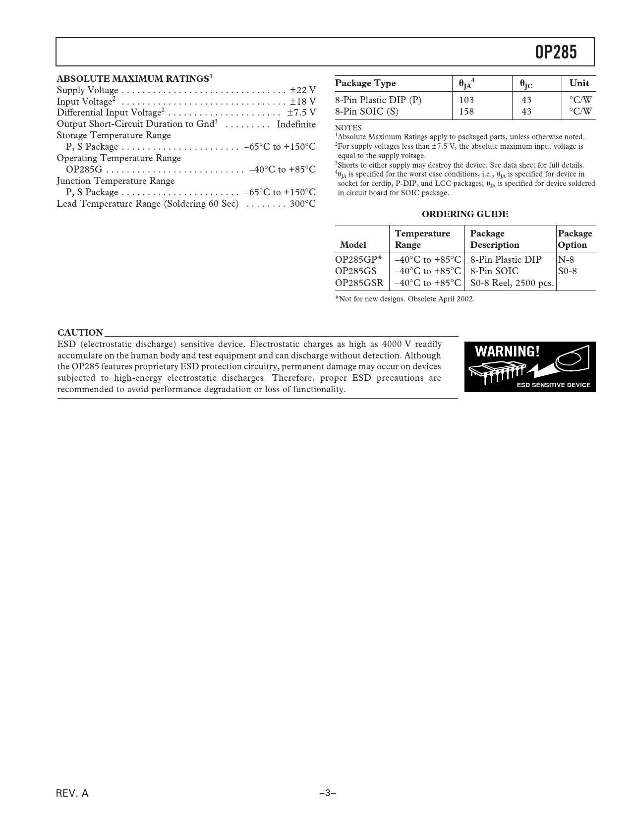

OP285. ABSOLUTE MAXIMUM RATINGS1. Package Type. Unit. ORDERING GUIDE. Temperature. Package. Model. Range. Description Option. CAUTION
OP285 ABSOLUTE MAXIMUM RATINGS1 Package Type Unit ORDERING GUIDE Temperature Package Model Range Description Option CAUTION
OP285 ABSOLUTE MAXIMUM RATINGS1 Package Type 4
Supply Voltage . ± 22 V
JA JC Unit
Input Voltage2 . ± 18 V 8-Pin Plastic DIP (P) 103 43 °C/W Differential Input Voltage2 . ± 7.5 V 8-Pin SOIC (S) 158 43 °C/W Output Short-Circuit Duration to Gnd3 . Indefinite NOTES Storage Temperature Range 1Absolute Maximum Ratings apply to packaged parts, unless otherwise noted. P, S Package . –65°C to +150°C 2For supply voltages less than ±7.5 V, the absolute maximum input voltage is Operating Temperature Range equal to the supply voltage. 3Shorts to either supply may destroy the device. See data sheet for full details. OP285G . –40°C to +85°C 4␪JA is specified for the worst case conditions, i.e., ␪JA is specified for device in Junction Temperature Range socket for cerdip, P-DIP, and LCC packages; ␪JA is specified for device soldered P, S Package . –65°C to +150°C in circuit board for SOIC package. Lead Temperature Range (Soldering 60 Sec) . 300°C
ORDERING GUIDE Temperature Package Package Model Range Description Option
OP285GP* –40°C to +85°C 8-Pin Plastic DIP N-8 OP285GS –40°C to +85°C 8-Pin SOIC S0-8 OP285GSR –40°C to +85°C S0-8 Reel, 2500 pcs. *Not for new designs. Obsolete April 2002.
CAUTION
ESD (electrostatic discharge) sensitive device. Electrostatic charges as high as 4000 V readily accumulate on the human body and test equipment and can discharge without detection. Although
WARNING!
the OP285 features proprietary ESD protection circuitry, permanent damage may occur on devices subjected to high-energy electrostatic discharges. Therefore, proper ESD precautions are
ESD SENSITIVE DEVICE
recommended to avoid performance degradation or loss of functionality. REV. A –3–
