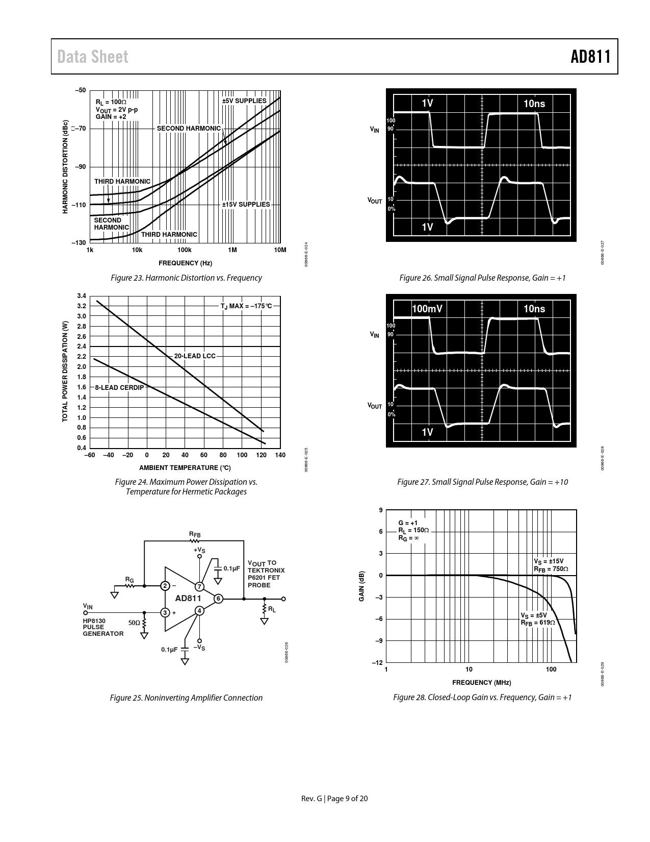

Data Sheet. AD811. –50. ±5V SUPPLIES. L = 100. 10ns. VOUT = 2V p-p GAIN = +2. 100. �–70. SECOND HARMONIC. –90. THIRD HARMONIC. OUT. –110
Data Sheet AD811 –50 ±5V SUPPLIES L = 100 10ns VOUT = 2V p-p GAIN = +2 100 �–70 SECOND HARMONIC –90 THIRD HARMONIC OUT –110
AD811
Data Sheet AD811 –50 R ±5V SUPPLIES L = 100
1V 10ns VOUT = 2V p-p GAIN = +2 100 �–70 SECOND HARMONIC V 90 IN –90 THIRD HARMONIC V 10 OUT –110 ±15V SUPPLIES HARMONIC DISTORTION (dBc) 0% SECOND HARMONIC 1V THIRD HARMONIC –130 1k 10k 100k 1M 10M FREQUENCY (Hz)
00866-E-024 00866-E-027 Figure 23. Harmonic Distortion vs. Frequency Figure 26. Small Signal Pulse Response, Gain = +1
3.4 3.2 TJ MAX = –175°C 100mV 10ns 3.0 2.8 100 2.6 V 90 IN 2.4 2.2 20-LEAD LCC 2.0 1.8 1.6 8-LEAD CERDIP 1.4 1.2 V 10 OUT 0% 1.0 TOTAL POWER DISSIPATION (W) 0.8 1V 0.6 0.4 –60 –40 –20 0 20 40 60 80 100 120 140 AMBIENT TEMPERATURE (°C)
00866-E-025 00866-E-028 Figure 24. Maximum Power Dissipation vs. Figure 27. Small Signal Pulse Response, Gain = +10 Temperature for Hermetic Packages
9 G = +1 R R 6 L = 150
FB RG =
+VS 3 V V OUT TO S = ±15V 0.1µF TEKTRONIX RFB = 750
P6201 FET 0 RG 2 – PROBE 7 AD811 6 –3 GAIN (dB) VIN R 4 L 3 + VS = ±5V HP8130 50Ω –6 R PULSE FB = 619
GENERATOR –9 0.1µF –VS
026 00866-
–12 1 10 100 FREQUENCY (MHz)
00866-E-029 Figure 25. Noninverting Amplifier Connection Figure 28. Closed-Loop Gain vs. Frequency, Gain = +1 Rev. G | Page 9 of 20 Document Outline FEATURES APPLICATIONS CONNECTION DIAGRAMS GENERAL DESCRIPTION TABLE OF CONTENTS REVISION HISTORY SPECIFICATIONS ABSOLUTE MAXIMUM RATINGS MAXIMUM POWER DISSIPATION METALIZATION PHOTOGRAPH ESD CAUTION TYPICAL PERFORMANCE CHARACTERISTICS APPLICATIONS INFORMATION GENERAL DESIGN CONSIDERATIONS ACHIEVING THE FLATTEST GAIN RESPONSE AT HIGH FREQUENCY Choice of Feedback and Gain Resistors Printed Circuit Board Layout Considerations Quality of Coaxial Cable Power Supply Bypassing Driving Capacitive Loads OPERATION AS A VIDEO LINE DRIVER AN 80 MHZ VOLTAGE-CONTROLLED AMPLIFIER CIRCUIT A VIDEO KEYER CIRCUIT OUTLINE DIMENSIONS ORDERING GUIDE
