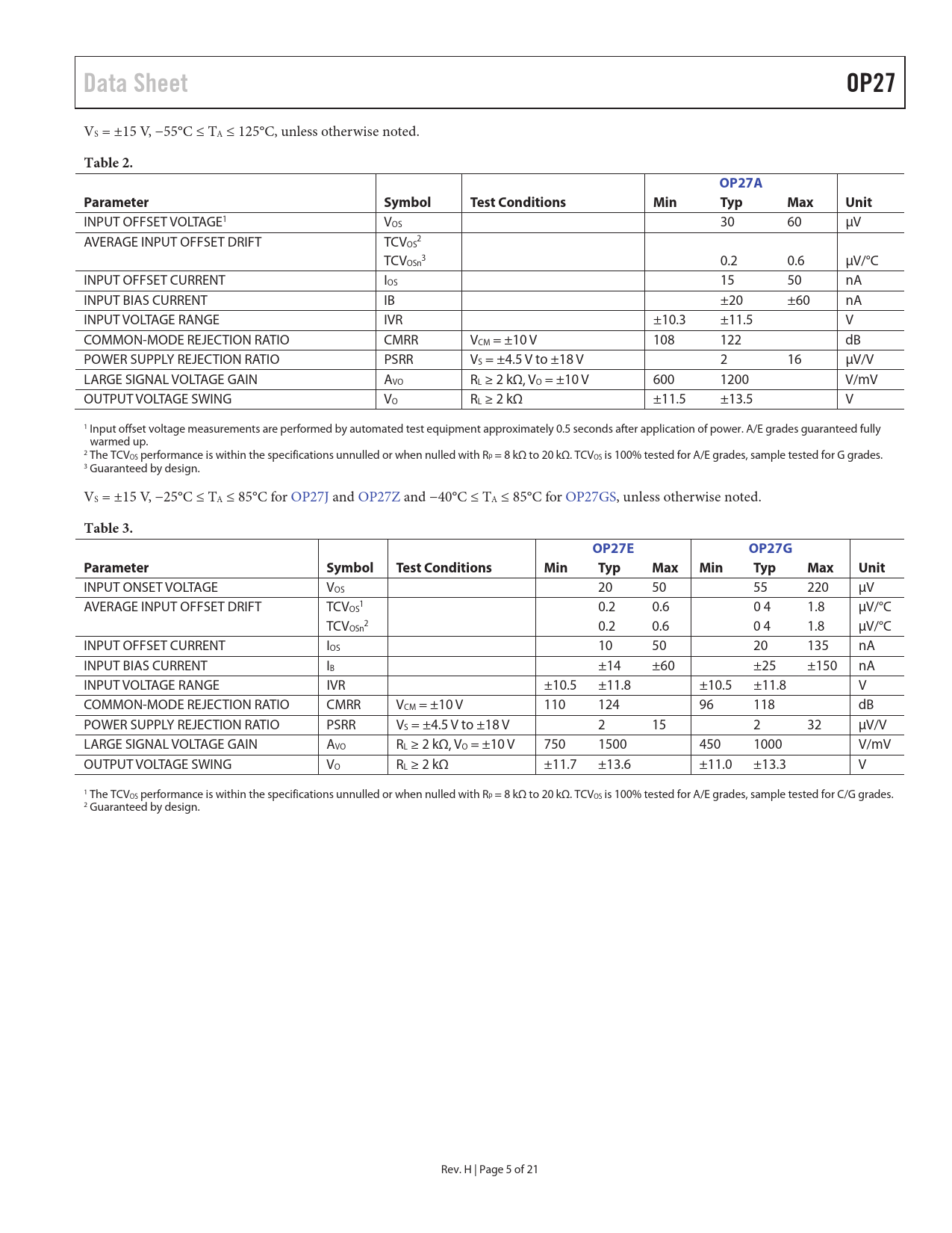

Data Sheet OP27 VS = ±15 V, −55°C ≤ TA ≤ 125°C, unless otherwise noted.
Table 2. OP27A Parameter Symbol Test Conditions Min Typ Max Unit
INPUT OFFSET VOLTAGE1 VOS 30 60 µV AVERAGE INPUT OFFSET DRIFT TCV 2 OS TCV 3 OSn 0.2 0.6 µV/°C INPUT OFFSET CURRENT IOS 15 50 nA INPUT BIAS CURRENT IB ±20 ±60 nA INPUT VOLTAGE RANGE IVR ±10.3 ±11.5 V COMMON-MODE REJECTION RATIO CMRR VCM = ±10 V 108 122 dB POWER SUPPLY REJECTION RATIO PSRR VS = ±4.5 V to ±18 V 2 16 µV/V LARGE SIGNAL VOLTAGE GAIN AVO RL ≥ 2 kΩ, VO = ±10 V 600 1200 V/mV OUTPUT VOLTAGE SWING VO RL ≥ 2 kΩ ±11.5 ±13.5 V 1 Input offset voltage measurements are performed by automated test equipment approximately 0.5 seconds after application of power. A/E grades guaranteed fully warmed up. 2 The TCVOS performance is within the specifications unnulled or when nulled with RP = 8 kΩ to 20 kΩ. TCVOS is 100% tested for A/E grades, sample tested for G grades. 3 Guaranteed by design. VS = ±15 V, −25°C ≤ TA ≤ 85°C for OP27J and OP27Z and −40°C ≤ TA ≤ 85°C for OP27GS, unless otherwise noted.
Table 3. OP27E OP27G Parameter Symbol Test Conditions Min Typ Max Min Typ Max Unit
INPUT ONSET VOLTAGE VOS 20 50 55 220 µV AVERAGE INPUT OFFSET DRIFT TCV 1 OS 0.2 0.6 0 4 1.8 µV/°C TCV 2 OSn 0.2 0.6 0 4 1.8 µV/°C INPUT OFFSET CURRENT IOS 10 50 20 135 nA INPUT BIAS CURRENT IB ±14 ±60 ±25 ±150 nA INPUT VOLTAGE RANGE IVR ±10.5 ±11.8 ±10.5 ±11.8 V COMMON-MODE REJECTION RATIO CMRR VCM = ±10 V 110 124 96 118 dB POWER SUPPLY REJECTION RATIO PSRR VS = ±4.5 V to ±18 V 2 15 2 32 µV/V LARGE SIGNAL VOLTAGE GAIN AVO RL ≥ 2 kΩ, VO = ±10 V 750 1500 450 1000 V/mV OUTPUT VOLTAGE SWING VO RL ≥ 2 kΩ ±11.7 ±13.6 ±11.0 ±13.3 V 1 The TCVOS performance is within the specifications unnulled or when nulled with RP = 8 kΩ to 20 kΩ. TCVOS is 100% tested for A/E grades, sample tested for C/G grades. 2 Guaranteed by design. Rev. H | Page 5 of 21
