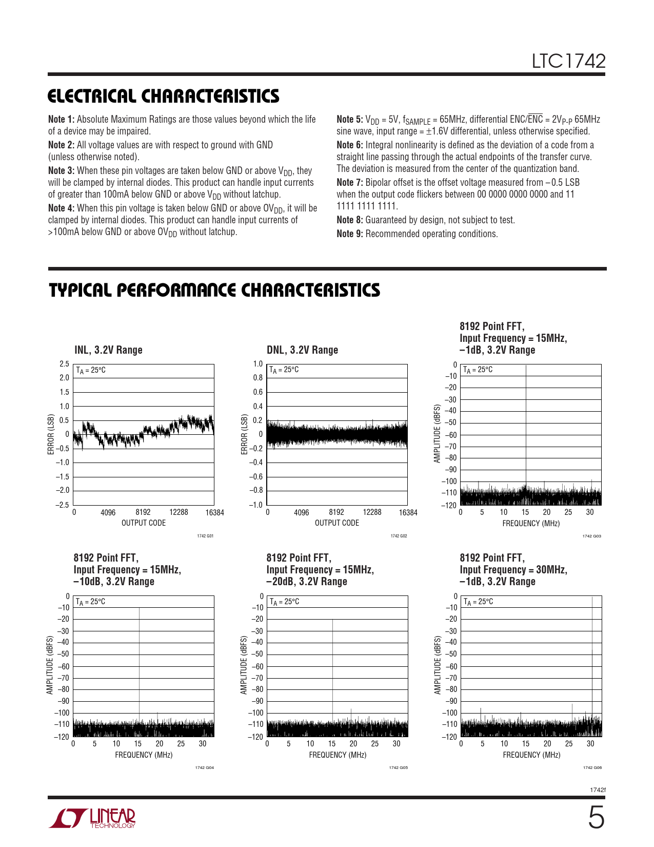

ELECTRICAL CHARACTERISTICS. Note 1:. Note 5:. Note 2:. Note 6:. Note 3:. Note 7:. Note 4:. Note 8:. Note 9:
ELECTRICAL CHARACTERISTICS Note 1: Note 5: Note 2: Note 6: Note 3: Note 7: Note 4: Note 8: Note 9:
LTC1742
Absolute Maximum Ratings are those values beyond which the life
Note 5:
VDD = 5V, fSAMPLE = 65MHz, differential ENC/ENC = 2VP-P 65MHz of a device may be impaired. sine wave, input range = ±1.6V differential, unless otherwise specified.
Note 2:
All voltage values are with respect to ground with GND
Note 6:
Integral nonlinearity is defined as the deviation of a code from a (unless otherwise noted). straight line passing through the actual endpoints of the transfer curve.
Note 3:
When these pin voltages are taken below GND or above V The deviation is measured from the center of the quantization band. DD, they will be clamped by internal diodes. This product can handle input currents
Note 7:
Bipolar offset is the offset voltage measured from – 0.5 LSB of greater than 100mA below GND or above VDD without latchup. when the output code flickers between 00 0000 0000 0000 and 11
Note 4:
When this pin voltage is taken below GND or above OV 1111 1111 1111. DD, it will be clamped by internal diodes. This product can handle input currents of
Note 8:
Guaranteed by design, not subject to test. >100mA below GND or above OVDD without latchup.
Note 9:
Recommended operating conditions.
W U TYPICAL PERFOR A CE CHARACTERISTICS 8192 Point FFT, Input Frequency = 15MHz, INL, 3.2V Range DNL, 3.2V Range –1dB, 3.2V Range
2.5 1.0 0 TA = 25°C TA = 25°C TA = 25°C 2.0 0.8 –10 –20 1.5 0.6 –30 1.0 0.4 –40 0.5 0.2 –50 0 0 –60 –0.5 –0.2 –70 ERROR (LSB) ERROR (LSB) –80 –1.0 –0.4 AMPLITUDE (dBFS) –90 –1.5 –0.6 –100 –2.0 –0.8 –110 –2.5 –1.0 –120 0 4096 8192 12288 16384 0 4096 8192 12288 16384 0 5 10 15 20 25 30 OUTPUT CODE OUTPUT CODE FREQUENCY (MHz) 1742 G01 1742 G02 1742 G03
8192 Point FFT, 8192 Point FFT, 8192 Point FFT, Input Frequency = 15MHz, Input Frequency = 15MHz, Input Frequency = 30MHz, –10dB, 3.2V Range –20dB, 3.2V Range –1dB, 3.2V Range
0 0 0 TA = 25°C TA = 25°C TA = 25°C –10 –10 –10 –20 –20 –20 –30 –30 –30 –40 –40 –40 –50 –50 –50 –60 –60 –60 –70 –70 –70 AMPLITUDE (dBFS) –80 AMPLITUDE (dBFS) –80 AMPLITUDE (dBFS) –80 –90 –90 –90 –100 –100 –100 –110 –110 –110 –120 –120 –120 0 5 10 15 20 25 30 0 5 10 15 20 25 30 0 5 10 15 20 25 30 FREQUENCY (MHz) FREQUENCY (MHz) FREQUENCY (MHz) 1742 G04 1742 G05 1742 G06 1742f 5
