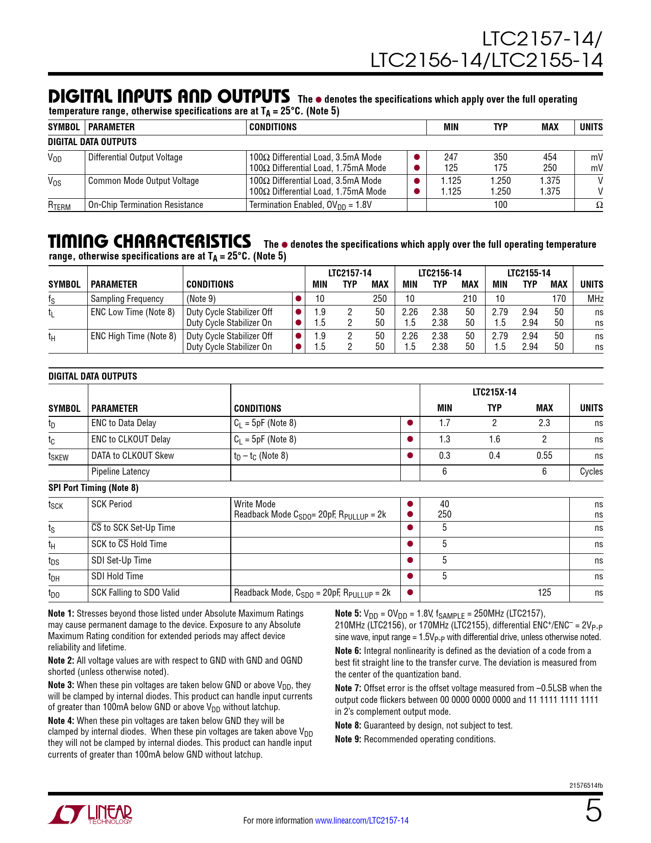

denotes the specifications which apply over the full operating temperature range, otherwise specifications are at TA = 25°C. (Note 5) SYMBOL PARAMETER CONDITIONS MIN TYP MAX UNITS DIGITAL DATA OUTPUTS
VOD Differential Output Voltage 100Ω Differential Load, 3.5mA Mode l 247 350 454 mV 100Ω Differential Load, 1.75mA Mode l 125 175 250 mV VOS Common Mode Output Voltage 100Ω Differential Load, 3.5mA Mode l 1.125 1.250 1.375 V 100Ω Differential Load, 1.75mA Mode l 1.125 1.250 1.375 V RTERM On-Chip Termination Resistance Termination Enabled, OVDD = 1.8V 100 Ω
TIMING CHARACTERISTICS The
l
denotes the specifications which apply over the full operating temperature range, otherwise specifications are at TA = 25°C. (Note 5) LTC2157-14 LTC2156-14 LTC2155-14 SYMBOL PARAMETER CONDITIONS MIN TYP MAX MIN TYP MAX MIN TYP MAX UNITS
fS Sampling Frequency (Note 9) l 10 250 10 210 10 170 MHz tL ENC Low Time (Note 8) Duty Cycle Stabilizer Off l 1.9 2 50 2.26 2.38 50 2.79 2.94 50 ns Duty Cycle Stabilizer On l 1.5 2 50 1.5 2.38 50 1.5 2.94 50 ns tH ENC High Time (Note 8) Duty Cycle Stabilizer Off l 1.9 2 50 2.26 2.38 50 2.79 2.94 50 ns Duty Cycle Stabilizer On l 1.5 2 50 1.5 2.38 50 1.5 2.94 50 ns
DIGITAL DATA OUTPUTS LTC215X-14 SYMBOL PARAMETER CONDITIONS MIN TYP MAX UNITS
tD ENC to Data Delay CL = 5pF (Note 8) l 1.7 2 2.3 ns tC ENC to CLKOUT Delay CL = 5pF (Note 8) l 1.3 1.6 2 ns tSKEW DATA to CLKOUT Skew tD – tC (Note 8) l 0.3 0.4 0.55 ns Pipeline Latency 6 6 Cycles
SPI Port Timing (Note 8)
tSCK SCK Period Write Mode l 40 ns Readback Mode CSDO= 20pF, RPULLUP = 2k l 250 ns tS CS to SCK Set-Up Time l 5 ns tH SCK to CS Hold Time l 5 ns tDS SDI Set-Up Time l 5 ns tDH SDI Hold Time l 5 ns tDO SCK Falling to SDO Valid Readback Mode, CSDO = 20pF, RPULLUP = 2k l 125 ns
