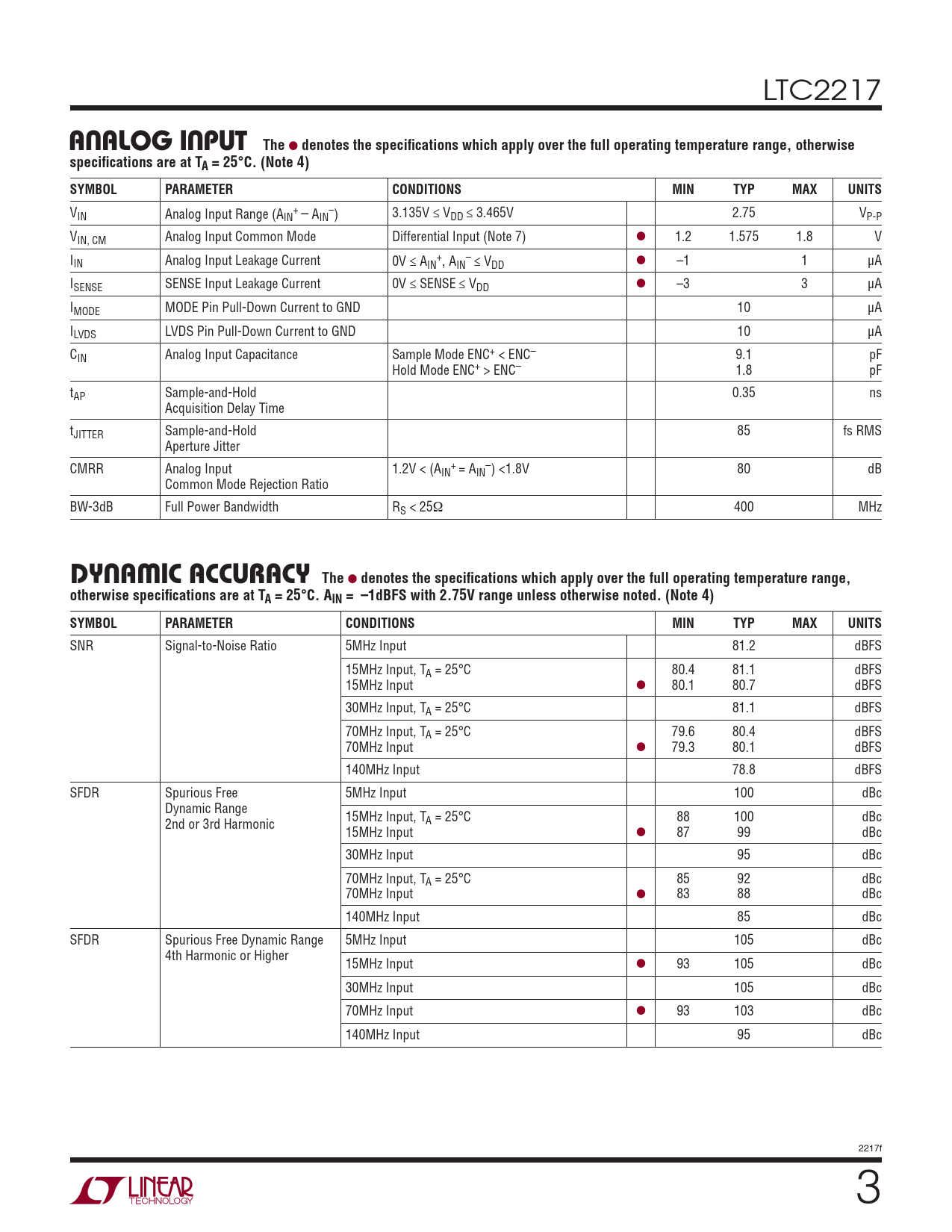

The. ANALOG INPUT. denotes the specifi cations which apply over the full operating temperature range, otherwise
The ANALOG INPUT denotes the specifi cations which apply over the full operating temperature range, otherwise
LTC2217
The ANALOG INPUT
denotes the specifi cations which apply over the full operating temperature range, otherwise specifi cations are at TA = 25°C. (Note 4) SYMBOL PARAMETER CONDITIONS MIN TYP MAX UNITS
V + – IN Analog Input Range (AIN – AIN ) 3.135V ≤ VDD ≤ 3.465V 2.75 VP-P VIN, CM Analog Input Common Mode Differential Input (Note 7) ● 1.2 1.575 1.8 V I + – IN Analog Input Leakage Current 0V ≤ A ● IN , AIN ≤ VDD –1 1 μA ISENSE SENSE Input Leakage Current 0V ≤ SENSE ≤ VDD ● –3 3 μA IMODE MODE Pin Pull-Down Current to GND 10 μA ILVDS LVDS Pin Pull-Down Current to GND 10 μA CIN Analog Input Capacitance Sample Mode ENC+ < ENC– 9.1 pF Hold Mode ENC+ > ENC– 1.8 pF tAP Sample-and-Hold 0.35 ns Acquisition Delay Time tJITTER Sample-and-Hold 85 fs RMS Aperture Jitter CMRR Analog Input 1.2V < (A + – IN = AIN ) <1.8V 80 dB Common Mode Rejection Ratio BW-3dB Full Power Bandwidth RS < 25Ω 400 MHz
The DYNAMIC ACCURACY
denotes the specifi cations which apply over the full operating temperature range, otherwise specifi cations are at TA = 25°C. AIN = –1dBFS with 2.75V range unless otherwise noted. (Note 4) SYMBOL PARAMETER CONDITIONS MIN TYP MAX UNITS
SNR Signal-to-Noise Ratio 5MHz Input 81.2 dBFS 15MHz Input, TA = 25°C 80.4 81.1 dBFS 15MHz Input ● 80.1 80.7 dBFS 30MHz Input, TA = 25°C 81.1 dBFS 70MHz Input, TA = 25°C 79.6 80.4 dBFS 70MHz Input ● 79.3 80.1 dBFS 140MHz Input 78.8 dBFS SFDR Spurious Free 5MHz Input 100 dBc Dynamic Range 15MHz Input, T 88 100 dBc 2nd or 3rd Harmonic A = 25°C 15MHz Input ● 87 99 dBc 30MHz Input 95 dBc 70MHz Input, TA = 25°C 85 92 dBc 70MHz Input ● 83 88 dBc 140MHz Input 85 dBc SFDR Spurious Free Dynamic Range 5MHz Input 105 dBc 4th Harmonic or Higher 15MHz Input ● 93 105 dBc 30MHz Input 105 dBc 70MHz Input ● 93 103 dBc 140MHz Input 95 dBc 2217f 3
