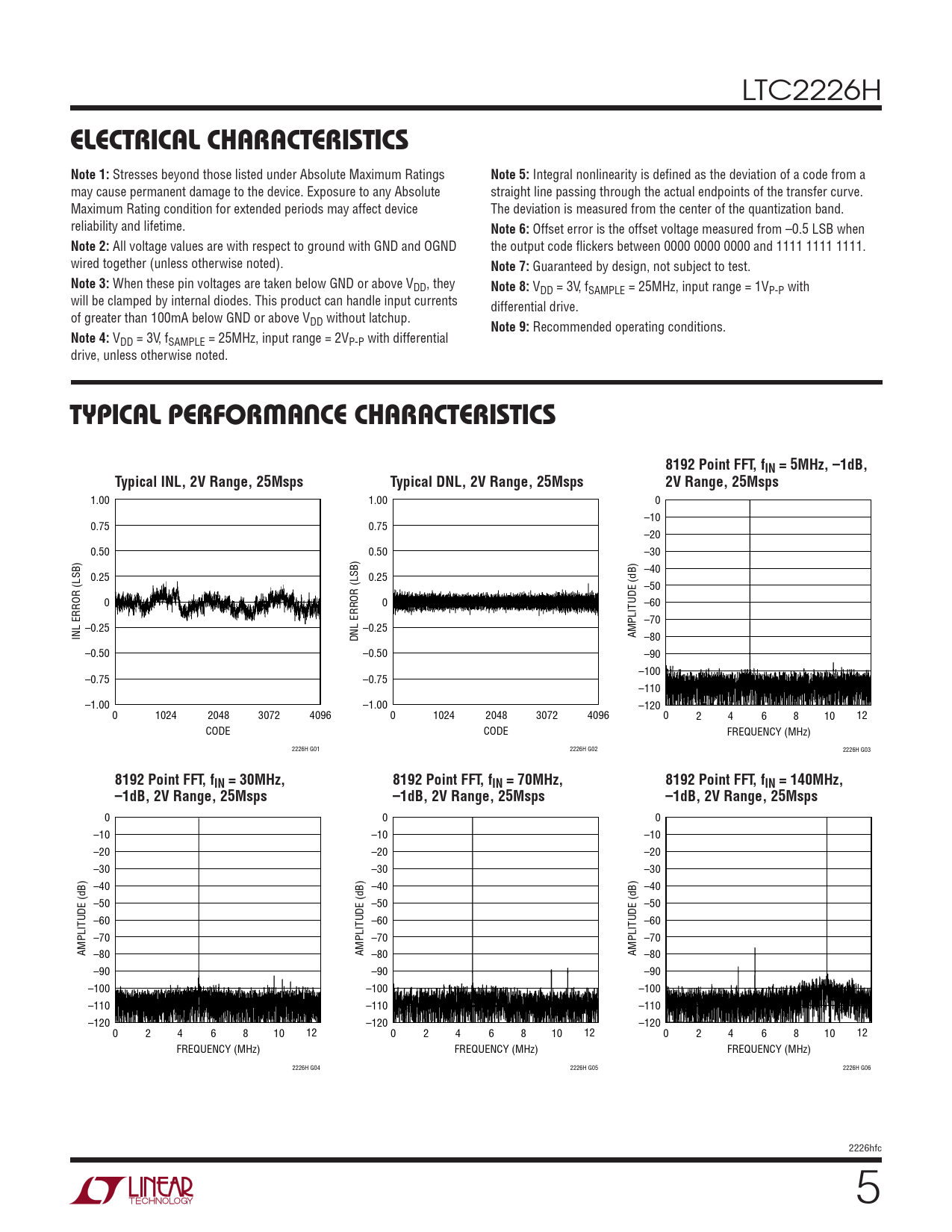

ELECTRICAL CHARACTERISTICS Note 1:
Note 5:
Integral nonlinearity is defined as the deviation of a code from a may cause permanent damage to the device. Exposure to any Absolute straight line passing through the actual endpoints of the transfer curve. Maximum Rating condition for extended periods may affect device The deviation is measured from the center of the quantization band. reliability and lifetime.
Note 6:
Offset error is the offset voltage measured from –0.5 LSB when
Note 2:
All voltage values are with respect to ground with GND and OGND the output code flickers between 0000 0000 0000 and 1111 1111 1111. wired together (unless otherwise noted).
Note 7:
Guaranteed by design, not subject to test.
Note 3:
When these pin voltages are taken below GND or above VDD, they
Note 8:
VDD = 3V, fSAMPLE = 25MHz, input range = 1VP-P with will be clamped by internal diodes. This product can handle input currents differential drive. of greater than 100mA below GND or above VDD without latchup.
Note 9:
Recommended operating conditions.
Note 4:
VDD = 3V, fSAMPLE = 25MHz, input range = 2VP-P with differential drive, unless otherwise noted.
TYPICAL PERFORMANCE CHARACTERISTICS 8192 Point FFT, fIN = 5MHz, –1dB, Typical INL, 2V Range, 25Msps Typical DNL, 2V Range, 25Msps 2V Range, 25Msps
1.00 1.00 0 –10 0.75 0.75 –20 0.50 0.50 –30 –40 0.25 0.25 –50 0 0 –60 –70 –0.25 –0.25 INL ERROR (LSB) DNL ERROR (LSB) AMPLITUDE (dB) –80 –0.50 –0.50 –90 –100 –0.75 –0.75 –110 –1.00 –1.00 –120 0 1024 2048 3072 4096 0 1024 2048 3072 4096 0 2 4 6 8 10 12 CODE CODE FREQUENCY (MHz) 2226H G01 2226H G02 2226H G03
8192 Point FFT, fIN = 30MHz, 8192 Point FFT, fIN = 70MHz, 8192 Point FFT, fIN = 140MHz, –1dB, 2V Range, 25Msps –1dB, 2V Range, 25Msps –1dB, 2V Range, 25Msps
0 0 0 –10 –10 –10 –20 –20 –20 –30 –30 –30 –40 –40 –40 –50 –50 –50 –60 –60 –60 –70 –70 –70 AMPLITUDE (dB) –80 AMPLITUDE (dB) –80 AMPLITUDE (dB) –80 –90 –90 –90 –100 –100 –100 –110 –110 –110 –120 –120 –120 0 2 4 6 8 10 12 0 2 4 6 8 10 12 0 2 4 6 8 10 12 FREQUENCY (MHz) FREQUENCY (MHz) FREQUENCY (MHz) 2226H G04 2226H G05 2226H G06 2226hfc 5
