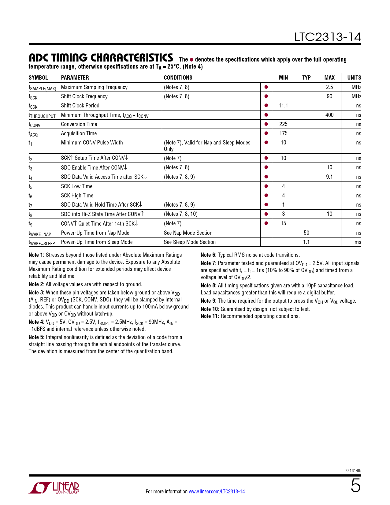

a Dc TiMing characTerisTics The
l
denotes the specifications which apply over the full operating temperature range, otherwise specifications are at TA = 25°C. (Note 4) SYMBOL PARAMETER CONDITIONS MIN TYP MAX UNITS
fSAMPLE(MAX) Maximum Sampling Frequency (Notes 7, 8) l 2.5 MHz fSCK Shift Clock Frequency (Notes 7, 8) l 90 MHz tSCK Shift Clock Period l 11.1 ns tTHROUGHPUT Minimum Throughput Time, tACQ + tCONV l 400 ns tCONV Conversion Time l 225 ns tACQ Acquisition Time l 175 ns t1 Minimum CONV Pulse Width (Note 7), Valid for Nap and Sleep Modes l 10 ns Only t2 SCK↑ Setup Time After CONV↓ (Note 7) l 10 ns t3 SDO Enable Time After CONV↓ (Notes 7, 8) l 10 ns t4 SDO Data Valid Access Time after SCK↓ (Notes 7, 8, 9) l 9.1 ns t5 SCK Low Time l 4 ns t6 SCK High Time l 4 ns t7 SDO Data Valid Hold Time After SCK↓ (Notes 7, 8, 9) l 1 ns t8 SDO into Hi-Z State Time After CONV↑ (Notes 7, 8, 10) l 3 10 ns t9 CONV↑ Quiet Time After 14th SCK↓ (Note 7) l 15 ns tWAKE_NAP Power-Up Time from Nap Mode See Nap Mode Section 50 ns tWAKE_SLEEP Power-Up Time from Sleep Mode See Sleep Mode Section 1.1 ms
Note 1:
Note 6:
Typical RMS noise at code transitions. may cause permanent damage to the device. Exposure to any Absolute
Note 7:
Parameter tested and guaranteed at OVDD = 2.5V. All input signals Maximum Rating condition for extended periods may affect device are specified with tr = tf = 1ns (10% to 90% of OVDD) and timed from a reliability and lifetime. voltage level of OVDD/2.
Note 2
: All voltage values are with respect to ground.
Note 8:
All timing specifications given are with a 10pF capacitance load.
Note 3:
When these pin voltages are taken below ground or above VDD Load capacitances greater than this will require a digital buffer. (AIN, REF) or OVDD (SCK, CONV, SDO) they will be clamped by internal
Note 9:
The time required for the output to cross the VOH or VOL voltage. diodes. This product can handle input currents up to 100mA below ground
Note 10:
Guaranteed by design, not subject to test. or above VDD or OVDD without latch-up.
Note 11:
Recommended operating conditions.
Note 4:
VDD = 5V, OVDD = 2.5V, fSMPL = 2.5MHz, fSCK = 90MHz, AIN = –1dBFS and internal reference unless otherwise noted.
Note 5:
Integral nonlinearity is defined as the deviation of a code from a straight line passing through the actual endpoints of the transfer curve. The deviation is measured from the center of the quantization band. 231314fb For more information www.linear.com/LTC2313-14 5 Document Outline Features Applications Description Typical Application Absolute Maximum Ratings Pin Configuration Order Information Electrical Characteristics Converter Characteristics Dynamic Accuracy Reference Input/Output Digital Inputs and Digital Outputs Power Requirements ADC Timing Characteristics Typical Performance Characteristics Pin Functions Block Diagram Timing Diagrams Applications Information Package Description Related Parts
