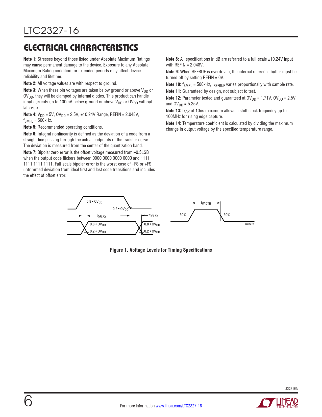

elecTrical characTerisTics Note 1:
Note 8:
All specifications in dB are referred to a full-scale ±10.24V input may cause permanent damage to the device. Exposure to any Absolute with REFIN = 2.048V. Maximum Rating condition for extended periods may affect device
Note 9:
When REFBUF is overdriven, the internal reference buffer must be reliability and lifetime. turned off by setting REFIN = 0V.
Note 2:
All voltage values are with respect to ground.
Note 10:
fSMPL = 500kHz, IREFBUF varies proportionally with sample rate.
Note 3:
When these pin voltages are taken below ground or above VDD or
Note 11:
Guaranteed by design, not subject to test. OVDD, they will be clamped by internal diodes. This product can handle
Note 12:
Parameter tested and guaranteed at OV input currents up to 100mA below ground or above V DD = 1.71V, OVDD = 2.5V DD or OVDD without and OV latch-up. DD = 5.25V.
Note 13:
t
Note 4:
V SCK of 10ns maximum allows a shift clock frequency up to DD = 5V, OVDD = 2.5V, ±10.24V Range, REFIN = 2.048V, 100MHz for rising edge capture. fSMPL = 500kHz.
Note 14:
Temperature coefficient is calculated by dividing the maximum
Note 5:
Recommended operating conditions. change in output voltage by the specified temperature range.
Note 6:
Integral nonlinearity is defined as the deviation of a code from a straight line passing through the actual endpoints of the transfer curve. The deviation is measured from the center of the quantization band.
Note 7:
Bipolar zero error is the offset voltage measured from –0.5LSB when the output code flickers between 0000 0000 0000 0000 and 1111 1111 1111 1111. Full-scale bipolar error is the worst-case of –FS or +FS untrimmed deviation from ideal first and last code transitions and includes the effect of offset error. 0.8 • OVDD tWIDTH 0.2 • OVDD t tDELAY 50% 50% DELAY 232716 F01 0.8 • OVDD 0.8 • OVDD 0.2 • OVDD 0.2 • OVDD
Figure 1. Voltage Levels for Timing Specifications
