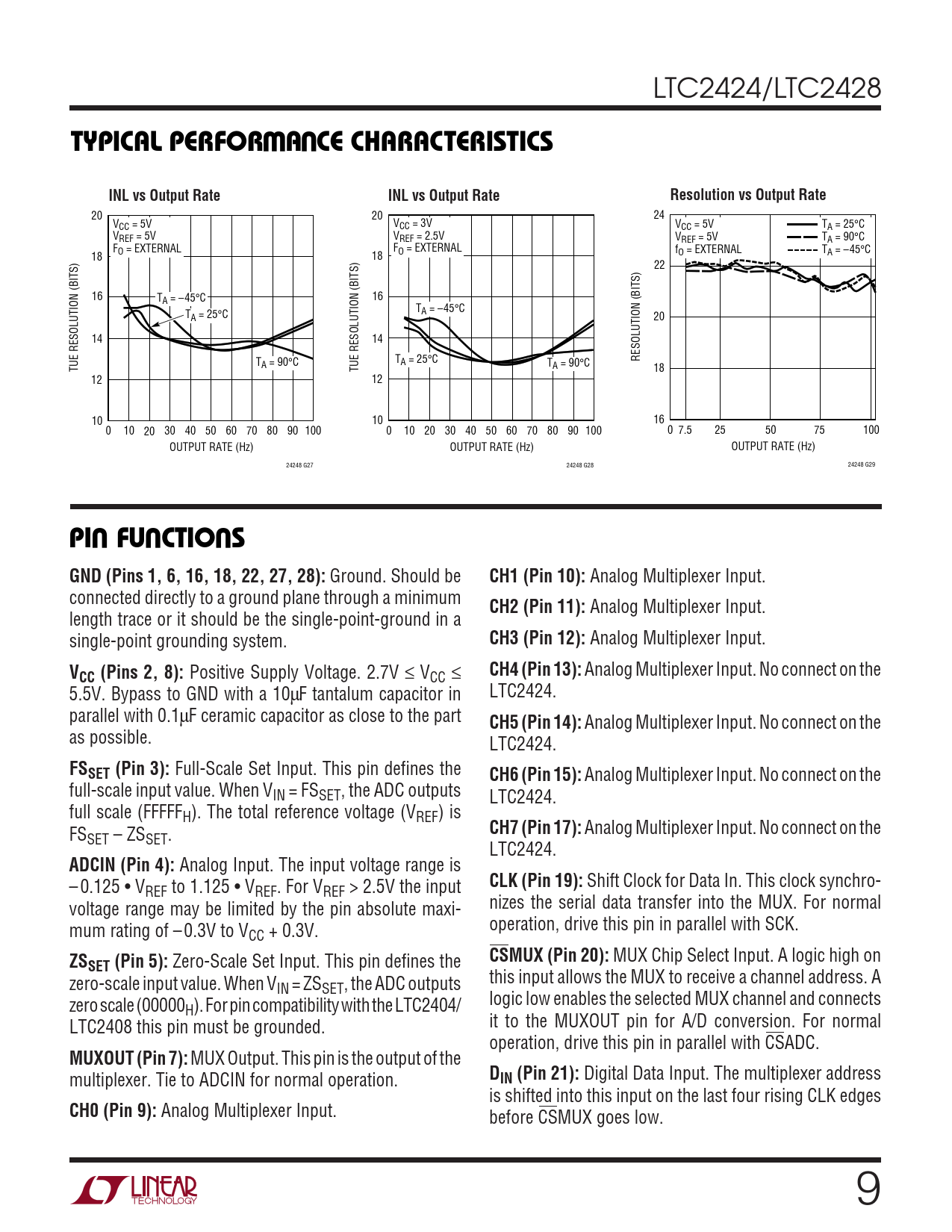

W U TYPICAL PERFOR A CE CHARACTERISTICS INL vs Output Rate INL vs Output Rate Resolution vs Output Rate
20 20 24 VCC = 5V VCC = 3V V T CC = 5V A = 25°C VREF = 5V VREF = 2.5V V T REF = 5V A = 90°C FO = EXTERNAL FO = EXTERNAL f T 18 18 O = EXTERNAL A = –45°C 22 16 T 16 A = –45°C T T A = –45°C A = 25°C 20 14 14 T TA = 25°C RESOLUTION (BITS) T TUE RESOLUTION (BITS) A = 90°C TUE RESOLUTION (BITS) A = 90°C 18 12 12 10 10 16 0 10 20 30 40 50 60 70 80 90 100 0 10 20 30 40 50 60 70 80 90 100 0 7.5 25 50 75 100 OUTPUT RATE (Hz) OUTPUT RATE (Hz) OUTPUT RATE (Hz) 24248 G27 24248 G28 24248 G29
