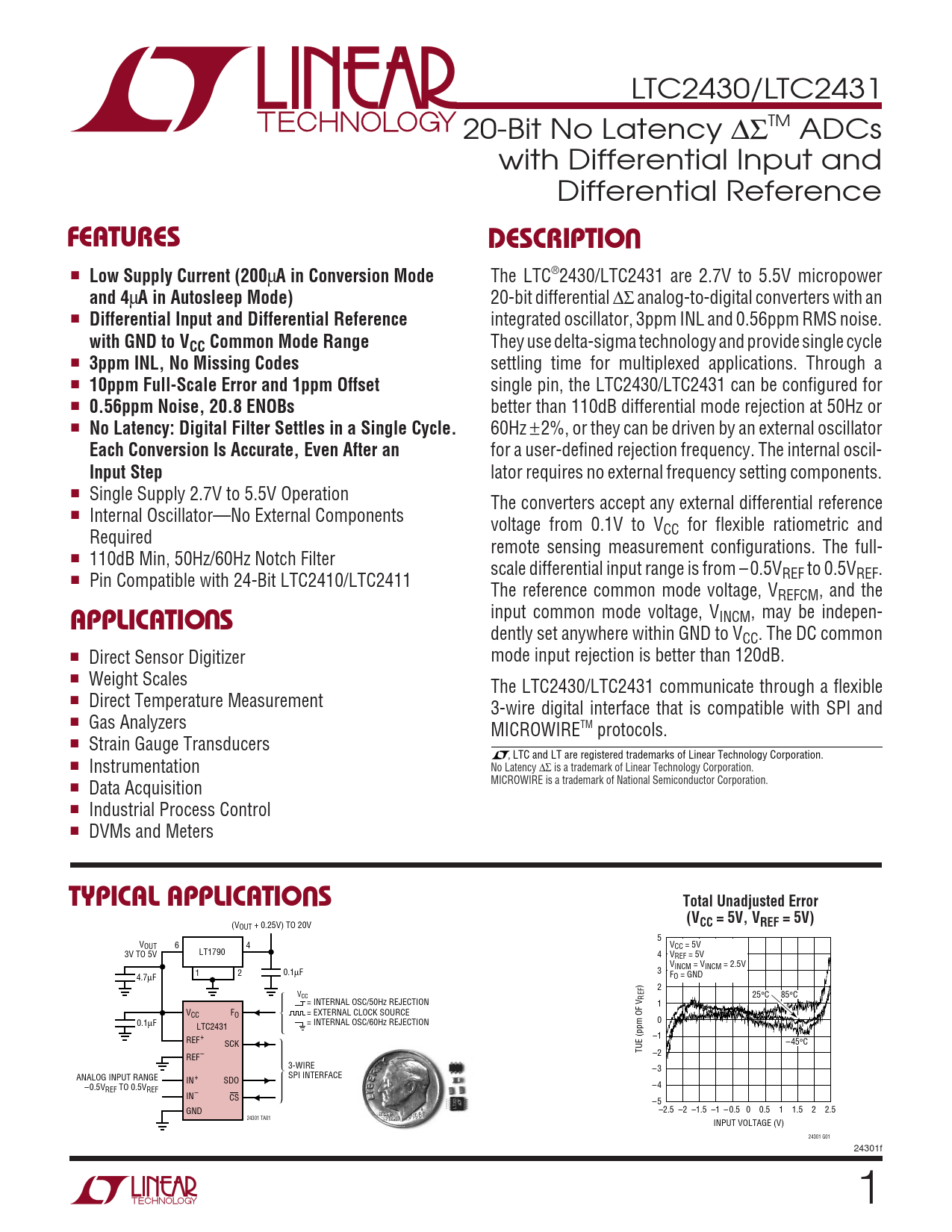

U TYPICAL APPLICATIO S Total Unadjusted Error (V
(V
CC = 5V, VREF = 5V)
OUT + 0.25V) TO 20V 5 VOUT 6 4 VCC = 5V LT1790 3V TO 5V 4 VREF = 5V VINCM = VINCM = 2.5V 1 2 0.1µF 3 4.7µF FO = GND ) 2 VCC REF 25°C 85°C = INTERNAL OSC/50Hz REJECTION 1 VCC FO = EXTERNAL CLOCK SOURCE 0.1µF = INTERNAL OSC/60Hz REJECTION 0 LTC2431 REF+ –1 SCK –45°C TUE (ppm OF V –2 REF– 3-WIRE –3 ANALOG INPUT RANGE SPI INTERFACE IN+ SDO –0.5V –4 REF TO 0.5VREF IN– CS –5 GND –2.5 –2 –1.5 –1 – 0.5 0 0.5 1 1.5 2 2.5 24301 TA01 INPUT VOLTAGE (V) 24301 G01 24301f 1
