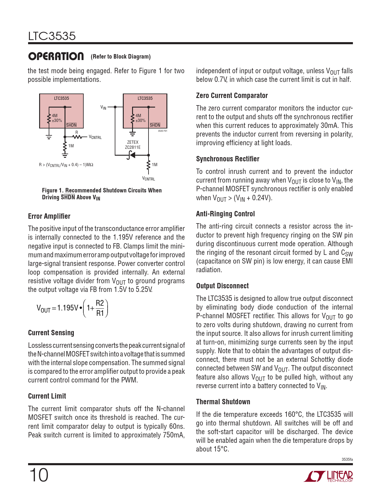

OPERATION (Refer to Block Diagram)
the test mode being engaged. Refer to Figure 1 for two independent of input or output voltage, unless VOUT falls possible implementations. below 0.7V, in which case the current limit is cut in half.
Zero Current Comparator
LTC3535 LTC3535 VIN The zero current comparator monitors the inductor cur- 4M 4M rent to the output and shuts off the synchronous rectifier ±30% ±30% SHDN SHDN when this current reduces to approximately 30mA. This 3535 F01 R V prevents the inductor current from reversing in polarity, CNTRL ZETEX improving efficiency at light loads. 1M ZC2811E
Synchronous Rectifier
R > (VCNTRL/VIN + 0.4) – 1)MΩ 1M To control inrush current and to prevent the inductor VCNTRL current from running away when VOUT is close to VIN, the
Figure 1. Recommended Shutdown Circuits When
P-channel MOSFET synchronous rectifier is only enabled
Driving SHDN Above VIN
when VOUT > (VIN + 0.24V).
