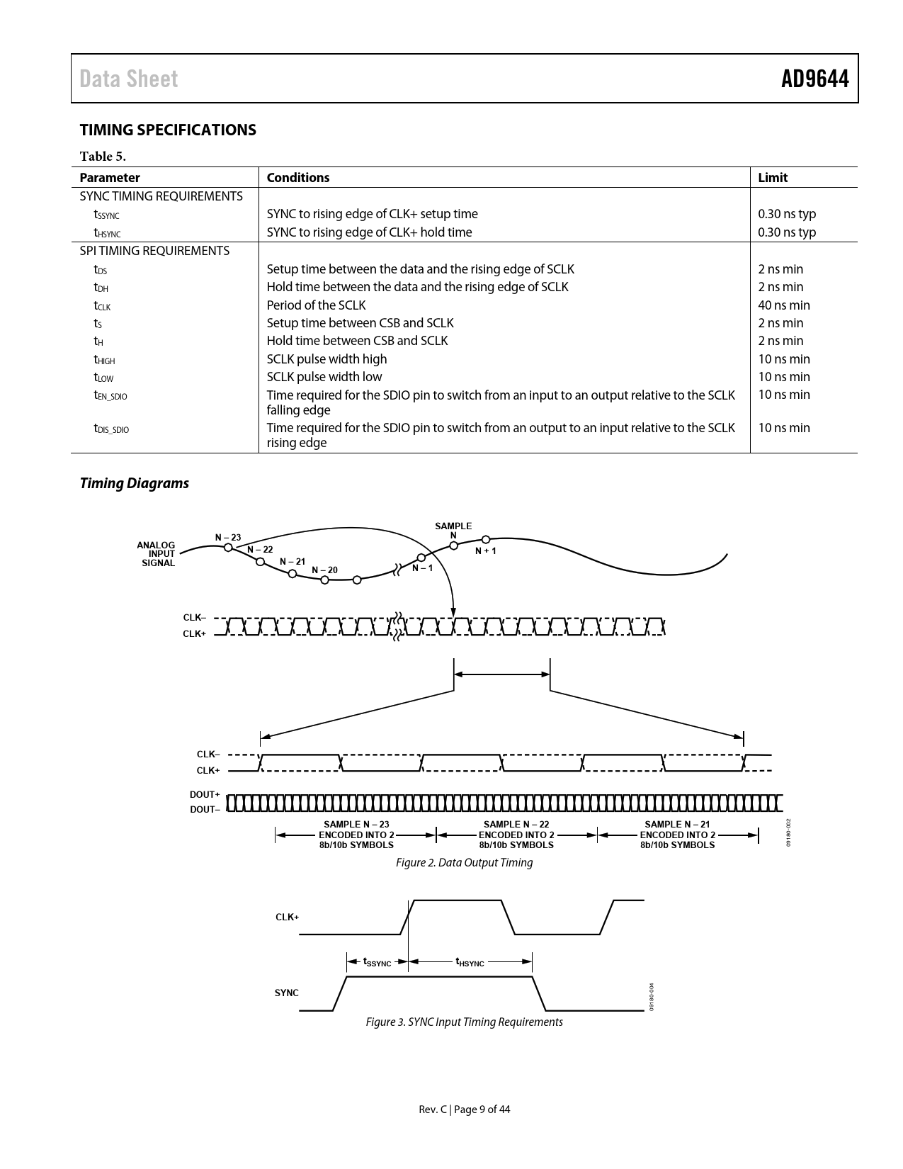

Data Sheet. AD9644. TIMING SPECIFICATIONS. Table 5. Parameter. Conditions. Limit. Timing Diagrams. SAMPLE. N – 23. ANALOG. N – 22. N + 1. INPUT
Data Sheet AD9644 TIMING SPECIFICATIONS Table 5 Parameter Conditions Limit Timing Diagrams SAMPLE N – 23 ANALOG N – 22 N + 1 INPUT
Data Sheet AD9644 TIMING SPECIFICATIONS Table 5. Parameter Conditions Limit
SYNC TIMING REQUIREMENTS tSSYNC SYNC to rising edge of CLK+ setup time 0.30 ns typ tHSYNC SYNC to rising edge of CLK+ hold time 0.30 ns typ SPI TIMING REQUIREMENTS tDS Setup time between the data and the rising edge of SCLK 2 ns min tDH Hold time between the data and the rising edge of SCLK 2 ns min tCLK Period of the SCLK 40 ns min tS Setup time between CSB and SCLK 2 ns min tH Hold time between CSB and SCLK 2 ns min tHIGH SCLK pulse width high 10 ns min tLOW SCLK pulse width low 10 ns min tEN_SDIO Time required for the SDIO pin to switch from an input to an output relative to the SCLK 10 ns min falling edge tDIS_SDIO Time required for the SDIO pin to switch from an output to an input relative to the SCLK 10 ns min rising edge
Timing Diagrams SAMPLE N N – 23 ANALOG N – 22 N + 1 INPUT SIGNAL N – 21 N – 20 N – 1 CLK– CLK+ CLK– CLK+ DOUT+ DOUT–

SAMPLE N – 23 SAMPLE N – 22 SAMPLE N – 21
-00
ENCODED INTO 2 ENCODED INTO 2 ENCODED INTO 2
180
8b/10b SYMBOLS 8b/10b SYMBOLS 8b/10b SYMBOLS
09 Figure 2. Data Output Timing
CLK+ tSSYNC tHSYNC
04
SYNC
0 80- 091 Figure 3. SYNC Input Timing Requirements Rev. C | Page 9 of 44 Document Outline Features Applications Functional Block Diagram Product Highlights Revision History General Description Specifications ADC DC Specifications ADC AC Specifications Digital Specifications Switching Specifications Timing Specifications Timing Diagrams Absolute Maximum Ratings Thermal Characteristics ESD Caution Pin Configuration and Function Descriptions Typical Performance Characteristics Equivalent Circuits Theory of Operation ADC Architecture Analog Input Considerations Input Common Mode Differential Input Configurations Voltage Reference Clock Input Considerations Clock Input Options Input Clock Divider Clock Duty Cycle Jitter Considerations Channel/Chip Synchronization Power Dissipation and Standby Mode Digital Outputs JESD204A Transmit Top Level Description Initial Frame Synchronization Frame and Lane Alignment Monitoring and Correction Digital Outputs and Timing Built-In Self-Test (BIST) and Output Test Built-In Self-Test (BIST) Output Test Modes Serial Port Interface (SPI) Configuration Using the SPI Hardware Interface SPI Accessible Features Memory Map Reading the Memory Map Register Table Open Locations Default Values Logic Levels Transfer Register Map Channel-Specific Registers Memory Map Register Table Memory Map Register Descriptions Sync Control (Register 0x3A) Bits[7:3]—Open Bit 2—Clock Divider Next Sync Only Bit 1—Clock Divider Sync Enable Bit 0—Master Sync Buffer Enable JESD204A Quick Configure (Register 0x5E) Bits[7:3]—Reserved Bits[2:0]—Register Quick Configuration JESD204A Lane Assignment (Register 0x5F) Bits[7:4]—Reserved Bits[3:0]—JESD204A Serial Lane Control JESD204A Link Control Register 1 (Register 0x60) Bit 7—Reserved Bit 6—Serial Tail Bit Enable Bit 5—Serial Test Sample Enable Bit 4—Serial Lane Synchronization Enable Bits[3:2]—Serial Lane Alignment Sequence Mode Bit 1—Frame Alignment Character Insertion Disable Bit 0—Serial Transmit Link Powered Down JESD204A Link Control Register 2 (Register 0x61) Bits[7:6]—Local DSYNC Mode Bit 5—DSYNC Pin Input Inverted Bit 4—CMOS DSYNC Input Bit 3—Open Bit 2—Bypass 8b/10b Encoding Bit 1—Invert Transmit Bits Bit 0—Mirror Serial Output Bits JESD204A Link Control Register 3 (Register 0x62) Bit 7—Disable CHKSUM Bit 6—Open Bits[5:4]—Link Test Generation Input Selection Bit 3—Open Bits[2:0]—Link Test Generation Mode JESD204A Link Control Register 4 (Register 0x63) Bits[7:0]—Initial Lane Alignment Sequence Repeat Count JESD204A Device Identification Number (DID) (Register 0x64) Bits[7:0]—Serial Device Identification (DID) Number JESD204A Bank Identification Number (BID) (Register 0x65) Bits[7:4]—Open Bits[3:0]—Serial Bank Identification (DID) Number JESD204A Lane Identification Number (LID) for Lane 0 (Register 0x66) Bits[7:5]—Open Bits[4:0]—Serial Lane Identification (LID) Number for Lane 0. JESD204A Lane Identification Number (LID) for Lane 1 (Register 0x67) Bits[7:5]—Open Bits[4:0]—Serial Lane Identification (LID) Number for Lane 1. JESD204A Scrambler (SCR) and Lane Configuration Registers (Register 0x6E) Bit 7—Enable Serial Scrambler Mode Bits[6:1]—Open Bit[0]—Serial Lane Control. JESD204A Number of Octets Per Frame (F) (Register 0x6F—Read Only) Bits[7:0]—Number of Octets per Frame (F) JESD204A Number of Frames Per Multiframe (Register 0x70) Bits[7:5]—Reserved Bits[4:0]—Number of Frames per Multiframe (K). JESD204A Number of Converters Per Link (M) (Register 0x71) Bits[7:1]—Reserved Bit 0—Number of Converters per Link per Device (M). JESD204A ADC Resolution (N) and Control Bits Per Sample (CS) (Register 0x72) Bits[7:6]—Number of Control Bits per Sample (CS) Bit 5—Open Bits[4:0]—Converter Resolution (N) JESD204A Total Bits Per Sample (N’) (Register 0x73) Bits[7:5]—Open Bits[4:0]—Total Number of Bits per Sample (N’) JESD204A Samples Per Converter (S) Frame Cycle (Register 0x74) Bits[7:5]—Open Bits[4:0]—Samples per Converter Frame Cycle (S) JESD204A HD and CF Configuration (Register 0x75) Bit 7—Enable High Density Format (Read Only) Bits[6:5]—Reserved Bits[4:0]—Number of Control Words per Frame Clock Cycle per Link (CF) JESD204A Serial Reserved Field 1 (Register 0x76) Bits[7:0]—Serial Reserved Field 1 (RES1) JESD204A Serial Reserved Field 2 (Register 0x77) Bits[7:0]—Serial Reserved Field 2 (RES2) JESD204A Serial Checksum Value for Lane 0 (Register 0x78) Bits[7:0]—Serial Checksum Value for Lane 0 JESD204A Serial Checksum Value for Lane 1 (Register 0x79) Bits[7:0]—Serial Checksum Value for Lane 1 Applications Information Design Guidelines Power and Ground Recommendations Exposed Paddle Thermal Heat Slug Recommendations VCMA and VCMB SPI Port Outline Dimensions Ordering Guide
