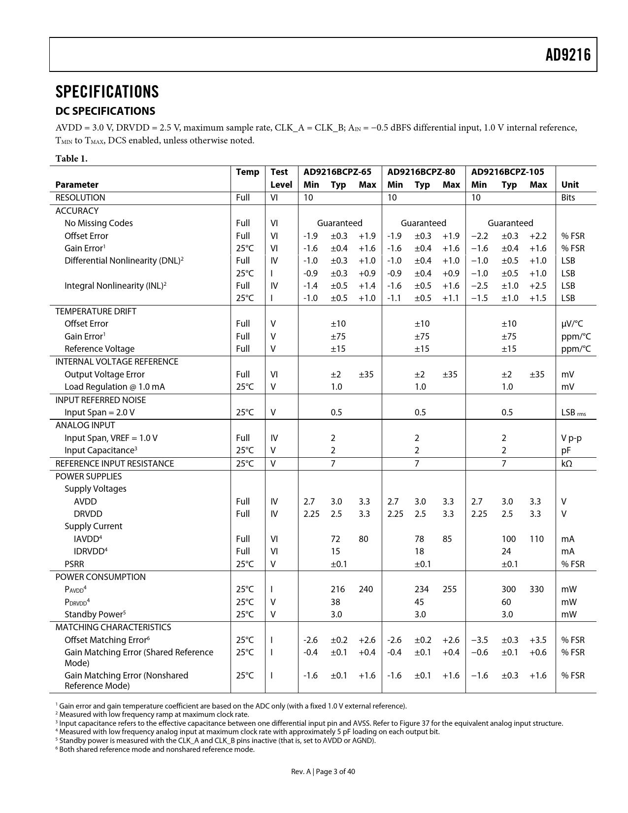

DC SPECIFICATIONS
AVDD = 3.0 V, DRVDD = 2.5 V, maximum sample rate, CLK_A = CLK_B; AIN = −0.5 dBFS differential input, 1.0 V internal reference, TMIN to TMAX, DCS enabled, unless otherwise noted.
Table 1. Temp Test AD9216BCPZ-65 AD9216BCPZ-80 AD9216BCPZ-105 Parameter Level Min Typ Max Min Typ Max Min Typ Max Unit
RESOLUTION Full VI 10 10 10 Bits ACCURACY No Missing Codes Full VI Guaranteed Guaranteed Guaranteed Offset Error Full VI -1.9 ±0.3 +1.9 -1.9 ±0.3 +1.9 −2.2 ±0.3 +2.2 % FSR Gain Error1 25°C VI -1.6 ±0.4 +1.6 -1.6 ±0.4 +1.6 −1.6 ±0.4 +1.6 % FSR Differential Nonlinearity (DNL)2 Full IV -1.0 ±0.3 +1.0 -1.0 ±0.4 +1.0 −1.0 ±0.5 +1.0 LSB 25°C I -0.9 ±0.3 +0.9 -0.9 ±0.4 +0.9 −1.0 ±0.5 +1.0 LSB Integral Nonlinearity (INL)2 Full IV -1.4 ±0.5 +1.4 -1.6 ±0.5 +1.6 −2.5 ±1.0 +2.5 LSB 25°C I -1.0 ±0.5 +1.0 -1.1 ±0.5 +1.1 −1.5 ±1.0 +1.5 LSB TEMPERATURE DRIFT Offset Error Full V ±10 ±10 ±10 µV/°C Gain Error1 Full V ±75 ±75 ±75 ppm/°C Reference Voltage Full V ±15 ±15 ±15 ppm/°C INTERNAL VOLTAGE REFERENCE Output Voltage Error Full VI ±2 ±35 ±2 ±35 ±2 ±35 mV Load Regulation @ 1.0 mA 25°C V 1.0 1.0 1.0 mV INPUT REFERRED NOISE Input Span = 2.0 V 25°C V 0.5 0.5 0.5 LSB rms ANALOG INPUT Input Span, VREF = 1.0 V Full IV 2 2 2 V p-p Input Capacitance3 25°C V 2 2 2 pF REFERENCE INPUT RESISTANCE 25°C V 7 7 7 kΩ POWER SUPPLIES Supply Voltages AVDD Full IV 2.7 3.0 3.3 2.7 3.0 3.3 2.7 3.0 3.3 V DRVDD Full IV 2.25 2.5 3.3 2.25 2.5 3.3 2.25 2.5 3.3 V Supply Current IAVDD4 Full VI 72 80 78 85 100 110 mA IDRVDD4 Full VI 15 18 24 mA PSRR 25°C V ±0.1 ±0.1 ±0.1 % FSR POWER CONSUMPTION P 4 AVDD 25°C I 216 240 234 255 300 330 mW P 4 DRVDD 25°C V 38 45 60 mW Standby Power5 25°C V 3.0 3.0 3.0 mW MATCHING CHARACTERISTICS Offset Matching Error6 25°C I -2.6 ±0.2 +2.6 -2.6 ±0.2 +2.6 −3.5 ±0.3 +3.5 % FSR Gain Matching Error (Shared Reference 25°C I -0.4 ±0.1 +0.4 -0.4 ±0.1 +0.4 −0.6 ±0.1 +0.6 % FSR Mode) Gain Matching Error (Nonshared 25°C I -1.6 ±0.1 +1.6 -1.6 ±0.1 +1.6 −1.6 ±0.3 +1.6 % FSR Reference Mode) 1 Gain error and gain temperature coefficient are based on the ADC only (with a fixed 1.0 V external reference). 2 Measured with low frequency ramp at maximum clock rate. 3 Input capacitance refers to the effective capacitance between one differential input pin and AVSS. Refer to Figure 3 f 7 or the equivalent analog input structure. 4 Measured with low frequency analog input at maximum clock rate with approximately 5 pF loading on each output bit. 5 Standby power is measured with the CLK_A and CLK_B pins inactive (that is, set to AVDD or AGND). 6 Both shared reference mode and nonshared reference mode. Rev. A | Page 3 of 40 Document Outline FEATURES APPLICATIONS FUNCTIONAL BLOCK GENERAL DESCRIPTION PRODUCT HIGHLIGHTS SPECIFICATIONS DC SPECIFICATIONS AC SPECIFICATIONS LOGIC SPECIFICATIONS SWITCHING SPECIFICATIONS TIMING DIAGRAM ABSOLUTE MAXIMUM RATINGS EXPLANATION OF TEST LEVELS ESD CAUTION PIN CONFIGURATION AND FUNCTION DESCRIPTIONS TERMINOLOGY TYPICAL PERFORMANCE CHARACTERISTICS EQUIVALENT CIRCUITS THEORY OF OPERATION ANALOG INPUT Differential Input Configurations Single-Ended Input Configuration CLOCK INPUT AND CONSIDERATIONS POWER DISSIPATION AND STANDBY MODE DIGITAL OUTPUTS OUTPUT CODING TIMING DATA FORMAT VOLTAGE REFERENCE Internal Reference Connection External Reference Operation Shared Reference Mode DUAL ADC LFCSP PCB POWER CONNECTOR ANALOG INPUTS OPTIONAL OPERATIONAL AMPLIFIER CLOCK VOLTAGE REFERENCE DATA OUTPUTS LFCSP EVALUATION BOARD BILL OF MATERIALS (BOM) LFCSP PCB SCHEMATICS LFCSP PCB LAYERS THERMAL CONSIDERATIONS OUTLINE DIMENSIONS ORDERING GUIDE
