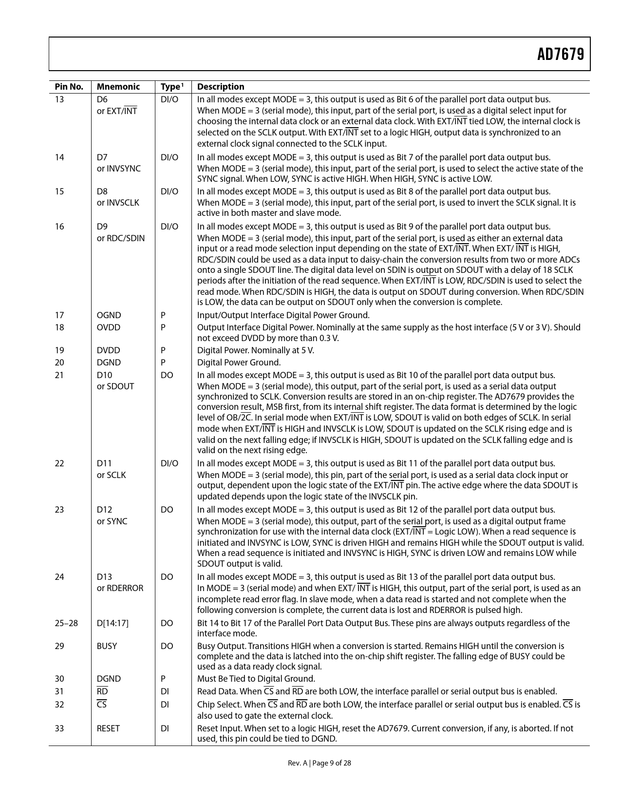

AD7679 Pin No. Mnemonic Type1 Description
13 D6 DI/O In all modes except MODE = 3, this output is used as Bit 6 of the parallel port data output bus. or EXT/INT When MODE = 3 (serial mode), this input, part of the serial port, is used as a digital select input for choosing the internal data clock or an external data clock. With EXT/INT tied LOW, the internal clock is selected on the SCLK output. With EXT/INT set to a logic HIGH, output data is synchronized to an external clock signal connected to the SCLK input. 14 D7 DI/O In all modes except MODE = 3, this output is used as Bit 7 of the parallel port data output bus. or INVSYNC When MODE = 3 (serial mode), this input, part of the serial port, is used to select the active state of the SYNC signal. When LOW, SYNC is active HIGH. When HIGH, SYNC is active LOW. 15 D8 DI/O In all modes except MODE = 3, this output is used as Bit 8 of the parallel port data output bus. or INVSCLK When MODE = 3 (serial mode), this input, part of the serial port, is used to invert the SCLK signal. It is active in both master and slave mode. 16 D9 DI/O In all modes except MODE = 3, this output is used as Bit 9 of the parallel port data output bus. or RDC/SDIN When MODE = 3 (serial mode), this input, part of the serial port, is used as either an external data input or a read mode selection input depending on the state of EXT/INT. When EXT/ INT is HIGH, RDC/SDIN could be used as a data input to daisy-chain the conversion results from two or more ADCs onto a single SDOUT line. The digital data level on SDIN is output on SDOUT with a delay of 18 SCLK periods after the initiation of the read sequence. When EXT/INT is LOW, RDC/SDIN is used to select the read mode. When RDC/SDIN is HIGH, the data is output on SDOUT during conversion. When RDC/SDIN is LOW, the data can be output on SDOUT only when the conversion is complete. 17 OGND P Input/Output Interface Digital Power Ground. 18 OVDD P Output Interface Digital Power. Nominally at the same supply as the host interface (5 V or 3 V). Should not exceed DVDD by more than 0.3 V. 19 DVDD P Digital Power. Nominally at 5 V. 20 DGND P Digital Power Ground. 21 D10 DO In all modes except MODE = 3, this output is used as Bit 10 of the parallel port data output bus. or SDOUT When MODE = 3 (serial mode), this output, part of the serial port, is used as a serial data output synchronized to SCLK. Conversion results are stored in an on-chip register. The AD7679 provides the conversion result, MSB first, from its internal shift register. The data format is determined by the logic level of OB/2C. In serial mode when EXT/INT is LOW, SDOUT is valid on both edges of SCLK. In serial mode when EXT/INT is HIGH and INVSCLK is LOW, SDOUT is updated on the SCLK rising edge and is valid on the next falling edge; if INVSCLK is HIGH, SDOUT is updated on the SCLK falling edge and is valid on the next rising edge. 22 D11 DI/O In all modes except MODE = 3, this output is used as Bit 11 of the parallel port data output bus. or SCLK When MODE = 3 (serial mode), this pin, part of the serial port, is used as a serial data clock input or output, dependent upon the logic state of the EXT/INT pin. The active edge where the data SDOUT is updated depends upon the logic state of the INVSCLK pin. 23 D12 DO In all modes except MODE = 3, this output is used as Bit 12 of the parallel port data output bus. or SYNC When MODE = 3 (serial mode), this output, part of the serial port, is used as a digital output frame synchronization for use with the internal data clock (EXT/INT = Logic LOW). When a read sequence is initiated and INVSYNC is LOW, SYNC is driven HIGH and remains HIGH while the SDOUT output is valid. When a read sequence is initiated and INVSYNC is HIGH, SYNC is driven LOW and remains LOW while SDOUT output is valid. 24 D13 DO In all modes except MODE = 3, this output is used as Bit 13 of the parallel port data output bus. or RDERROR In MODE = 3 (serial mode) and when EXT/ INT is HIGH, this output, part of the serial port, is used as an incomplete read error flag. In slave mode, when a data read is started and not complete when the following conversion is complete, the current data is lost and RDERROR is pulsed high. 25–28 D[14:17] DO Bit 14 to Bit 17 of the Parallel Port Data Output Bus. These pins are always outputs regardless of the interface mode. 29 BUSY DO Busy Output. Transitions HIGH when a conversion is started. Remains HIGH until the conversion is complete and the data is latched into the on-chip shift register. The falling edge of BUSY could be used as a data ready clock signal. 30 DGND P Must Be Tied to Digital Ground. 31 RD DI Read Data. When CS and RD are both LOW, the interface parallel or serial output bus is enabled. 32 CS DI Chip Select. When CS and RD are both LOW, the interface parallel or serial output bus is enabled. CS is also used to gate the external clock. 33 RESET DI Reset Input. When set to a logic HIGH, reset the AD7679. Current conversion, if any, is aborted. If not used, this pin could be tied to DGND. Rev. A | Page 9 of 28 Document Outline FEATURES APPLICATIONS FUNCTIONAL BLOCK DIAGRAM GENERAL DESCRIPTION PRODUCT HGHLIGHTS TABLE OF CONTENTS REVISION HISTORY SPECIFICATIONS TIMING SPECIFICATIONS ABSOLUTE MAXIMUM RATINGS ESD CAUTION PIN CONFIGURATION AND FUNCTION DESCRIPTIONS DEFINITION OF SPECIFICATIONS TYPICAL PERFORMANCE CHARACTERISTICS CIRCUIT INFORMATION CONVERTER OPERATION Transfer Functions TYPICAL CONNECTION DIAGRAM Analog Inputs Driver Amplifier Choice Single-to-Differential Driver Voltage Reference Power Supply POWER DISSIPATION VERSUS THROUGHPUT CONVERSION CONTROL DIGITAL INTERFACE PARALLEL INTERFACE SERIAL INTERFACE MASTER SERIAL INTERFACE Internal Clock SLAVE SERIAL INTERFACE External Clock External Discontinuous Clock Data Read after Conversion External Clock Data Read during Conversion MICROPROCESSOR INTERFACING SPI Interface (ADSP-219x) APPLICATION HINTS LAYOUT EVALUATING THE AD7679’S PERFORMANCE OUTLINE DIMENSIONS ORDERING GUIDE
