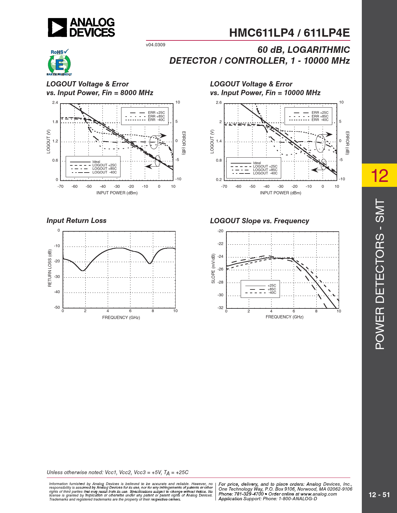

DescriptionLogarithmic Detector Controller SMT, 0.001 - 10.0 GHz
Pages / Page10 / 4 — HMC611LP4 / 611LP4E. 60 dB, LOGARITHMIC. DETECTOR / CONTROLLER, 1 - 10000 …
File Format / SizePDF / 569 Kb
HMC611LP4 / 611LP4E. 60 dB, LOGARITHMIC. DETECTOR / CONTROLLER, 1 - 10000 MHz. LOGOUT Voltage & Error
HMC611LP4 / 611LP4E 60 dB, LOGARITHMIC DETECTOR / CONTROLLER, 1 - 10000 MHz LOGOUT Voltage & Error
HMC611LP4 / 611LP4E
v04.0309
60 dB, LOGARITHMIC DETECTOR / CONTROLLER, 1 - 10000 MHz LOGOUT Voltage & Error LOGOUT Voltage & Error vs. Input Power, Fin = 8000 MHz vs. Input Power, Fin = 10000 MHz
2.4 10 2.6 10 ERR +25C ERR +25C ERR +85C ERR +85C ERR -40C ERR -40C 1.8 5 2 5 ERROR (dB) ERROR (dB) 1.2 0 1.4 0 LOGOUT (V) LOGOUT (V) 0.6 -5 -5 Ideal 0.8 Ideal LOGOUT +25C LOGOUT +25C LOGOUT +85C LOGOUT +85C LOGOUT -40C LOGOUT -40C 0 -10 0.2 -10 12 -70 -60 -50 -40 -30 -20 -10 0 10 -70 -60 -50 -40 -30 -20 -10 0 10 INPUT POWER (dBm) INPUT POWER (dBm) T
Input Return Loss LOGOUT Slope vs. Frequency
0 -20 S - SM -22 -10 R -24 O -20 T -26 C -30 E SLOPE (mV/dB) -28 RETURN LOSS (dB) +25C T +85C -40 -40C -30 E -50 -32 0 2 4 6 8 10 0 2 4 6 8 10 R D FREQUENCY (GHz) FREQUENCY (GHz) E W O P Unless otherwise noted: Vcc1, Vcc2, Vcc3 = +5V, TA = +25C Information furnis F heod r pri by An ce, de alog Devi lcievs eir s y b , a eliev nd to pla ed to be accu ce o rate anrder d relia sbl, pl e. H ease co owever, no For price, delivery, and to place orders: Analog Devices, Inc., responsibility is assumed by Analog Devices for its use, nor for any infringements of patents or other ntact Hittite Microwave Corporation: One Technology Way, P.O. Box 9106, Norwood, MA 02062-9106 20 Alpha Road, Chelmsford, MA 01824 Phone: 978 rights of third parties that may result from its use. Specifications subject to change without notice. No Ph - o 25 ne 0 : 7 -3 81- 3 3 4 29 3 F -470 ax: 978 0 • Orde - r o 25 nlin 0- e a3 t 373 license is granted by implication or otherwise under any patent or patent rights of Analog Devices. www.analog.com
