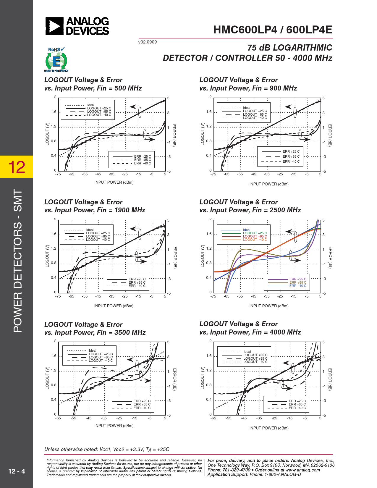

Description75 dB Logarithmic Detector/Controller SMT, 0.05 - 4.0 GHz
Pages / Page10 / 5 — HMC600LP4 / 600LP4E. 75 dB LOGARITHMIC. DETECTOR / CONTROLLER 50 - 4000 …
File Format / SizePDF / 569 Kb
HMC600LP4 / 600LP4E. 75 dB LOGARITHMIC. DETECTOR / CONTROLLER 50 - 4000 MHz. LOGOUT Voltage & Error
HMC600LP4 / 600LP4E 75 dB LOGARITHMIC DETECTOR / CONTROLLER 50 - 4000 MHz LOGOUT Voltage & Error
HMC600LP4 / 600LP4E
v02.0909
75 dB LOGARITHMIC DETECTOR / CONTROLLER 50 - 4000 MHz LOGOUT Voltage & Error LOGOUT Voltage & Error vs. Input Power, Fin = 500 MHz vs. Input Power, Fin = 900 MHz
2 5 2 5 Ideal LOGOUT +25 C Ideal 1.6 LOGOUT +85 C 3 1.6 LOGOUT +25 C 3 LOGOUT -40 C LOGOUT +85 C LOGOUT -40 C ERROR (dB) ERROR (dB) 1.2 1 1.2 1 0.8 -1 0.8 LOGOUT (V) -1 LOGOUT (V) ERR +25 C 0.4 ERR +25 C -3 0.4 ERR +85 C -3 ERR +85 C 12 ERR -40 C ERR -40 C 0 -5 0 -5 -75 -65 -55 -45 -35 -25 -15 -5 5 -75 -65 -55 -45 -35 -25 -15 -5 5 INPUT POWER (dBm) INPUT POWER (dBm) T
LOGOUT Voltage & Error LOGOUT Voltage & Error vs. Input Power, Fin = 1900 MHz vs. Input Power, Fin = 2500 MHz
2 2 5 5 S - SM R Ideal Ideal 1.6 LOGOUT +25 C 1.6 LOGOUT +25 C 3 3 LOGOUT +85 C LOGOUT +85 C O LOGOUT -40 C LOGOUT -40 C T ERROR (dB) ERROR (dB) 1.2 1.2 1 1 C E 0.8 0.8 -1 -1 T LOGOUT (V) LOGOUT (V) E 0.4 0.4 ERR +25 C -3 ERR +25 C -3 ERR +85 C ERR +85 C ERR -40 C ERR -40 C R D 0 0 -5 -5 -75 -65 -55 -45 -35 -25 -15 -5 5 -75 -65 -55 -45 -35 -25 -15 -5 5 E INPUT POWER (dBm) INPUT POWER (dBm) W O
P
LOGOUT Voltage & Error vs. Input Power, Fin = 3500 MHz vs. Input Power, Fin = 4000 MHz
2 2 5 5 Ideal Ideal 1.6 LOGOUT +25 C 1.6 LOGOUT +25 C LOGOUT +85 C 3 3 LOGOUT +85 C LOGOUT -40 C LOGOUT -40 C ERROR (dB) ERROR (dB) 1.2 1.2 1 1 0.8 0.8 -1 -1 LOGOUT (V) LOGOUT (V) 0.4 0.4 ERR +25 C -3 ERR +25 C -3 ERR +85 C ERR +85 C ERR -40 C ERR -40 C 0 0 -5 -5 -65 -55 -45 -35 -25 -15 -5 5 -65 -55 -45 -35 -25 -15 -5 5 INPUT POWER (dBm) INPUT POWER (dBm) Unless otherwise noted: Vcc1, Vcc2 = +3.3V, TA = +25C Information furnis F heod r pri by An ce, de alog Devi lcievs eir s y b , a eliev nd to pla ed to be accu ce o rate anrder d relia sbl, pl e. H ease co owever, no For price, delivery, and to place orders: Analog Devices, Inc., responsibility is assumed by Analog Devices for its use, nor for any infringements of patents or other ntact Hittite Microwave Corporation: One Technology Way, P.O. Box 9106, Norwood, MA 02062-9106 20 Alpha Road, Chelmsford, MA 01824 Phone: 978 rights of third parties that may result from its use. Specifications subject to change without notice. No Ph - o 25 ne 0 : 7 -3 81- 3 3 4 29 3 F -470 ax: 978 0 • Orde - r o 25 nlin 0- e a3 t 373
