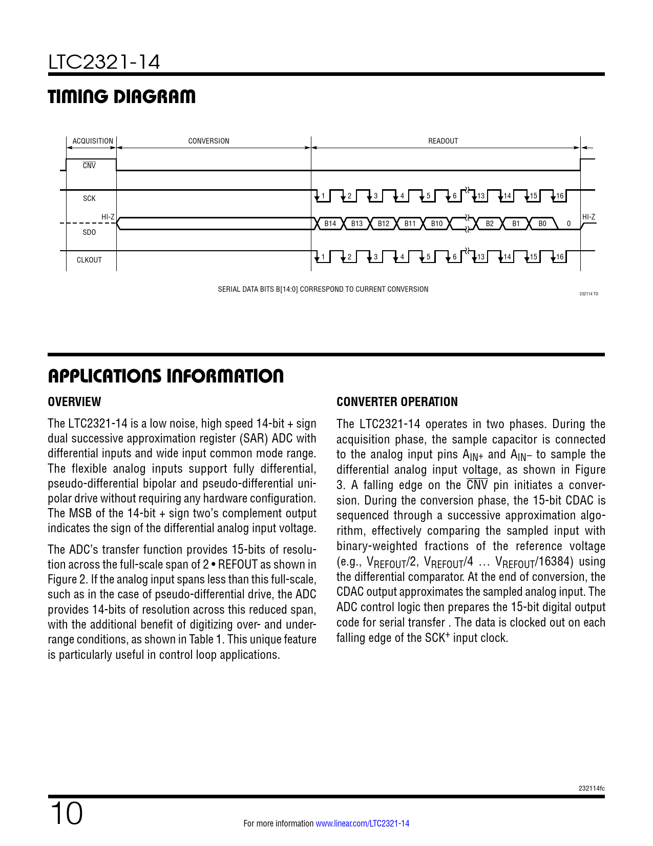

TiMing DiagraM
ACQUISITION CONVERSION READOUT CNV 1 2 3 4 5 6 13 14 15 16 SCK HI-Z HI-Z B14 B13 B12 B11 B10 B2 B1 B0 0 SDO CLKOUT 1 2 3 4 5 6 13 14 15 16 SERIAL DATA BITS B[14:0] CORRESPOND TO CURRENT CONVERSION 232114 TD
