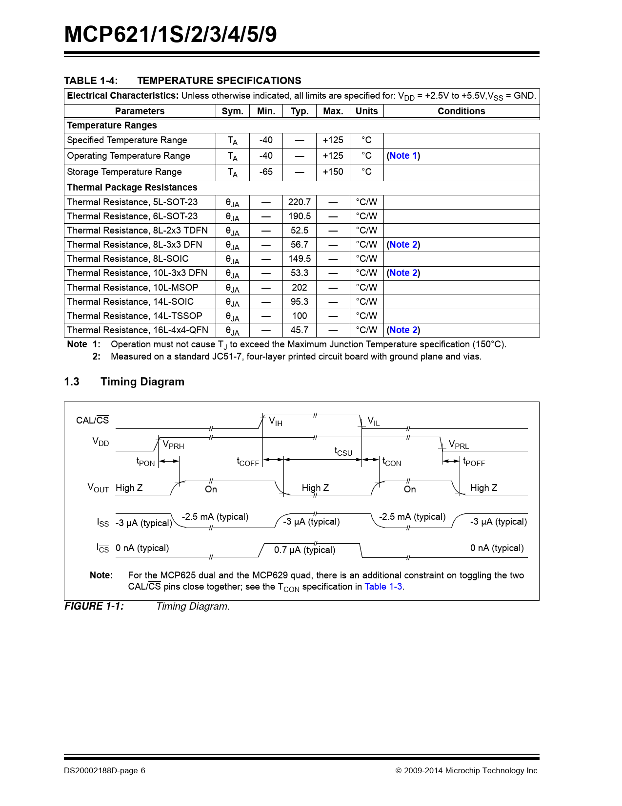

MCP621/1S/2/3/4/5/9 TABLE 1-4: TEMPERATURE SPECIFICATIONS Electrical Characteristics:
Unless otherwise indicated, all limits are specified for: VDD = +2.5V to +5.5V,VSS = GND.
Parameters Sym. Min. Typ. Max. Units Conditions Temperature Ranges
Specified Temperature Range TA -40 — +125 °C Operating Temperature Range TA -40 — +125 °C
(Note 1 )
Storage Temperature Range TA -65 — +150 °C
Thermal Package Resistances
Thermal Resistance, 5L-SOT-23 θJA — 220.7 — °C/W Thermal Resistance, 6L-SOT-23 θJA — 190.5 — °C/W Thermal Resistance, 8L-2x3 TDFN θJA — 52.5 — °C/W Thermal Resistance, 8L-3x3 DFN θJA — 56.7 — °C/W
(Note 2 )
Thermal Resistance, 8L-SOIC θJA — 149.5 — °C/W Thermal Resistance, 10L-3x3 DFN θJA — 53.3 — °C/W
(Note 2 )
Thermal Resistance, 10L-MSOP θJA — 202 — °C/W Thermal Resistance, 14L-SOIC θJA — 95.3 — °C/W Thermal Resistance, 14L-TSSOP θJA — 100 — °C/W Thermal Resistance, 16L-4x4-QFN θJA — 45.7 — °C/W
(Note 2 ) Note 1:
Operation must not cause TJ to exceed the Maximum Junction Temperature specification (150°C).
2:
Measured on a standard JC51-7, four-layer printed circuit board with ground plane and vias.
1.3 Timing Diagram
CAL/CS VIH VIL VDD VPRH VPRL tCSU tPON t t COFF tCON POFF VOUT High Z On High Z On High Z I -2.5 mA (typical) SS -3 µA (typical) -3 µA (typical) -2.5 mA (typical) -3 µA (typical) ICS 0 nA (typical) 0.7 µA (typical) 0 nA (typical)
Note:
For the MCP625 dual and the MCP629 quad, there is an additional constraint on toggling the two CAL/CS pins close together; see the TCON specification in Table 1-3.
FIGURE 1-1:
