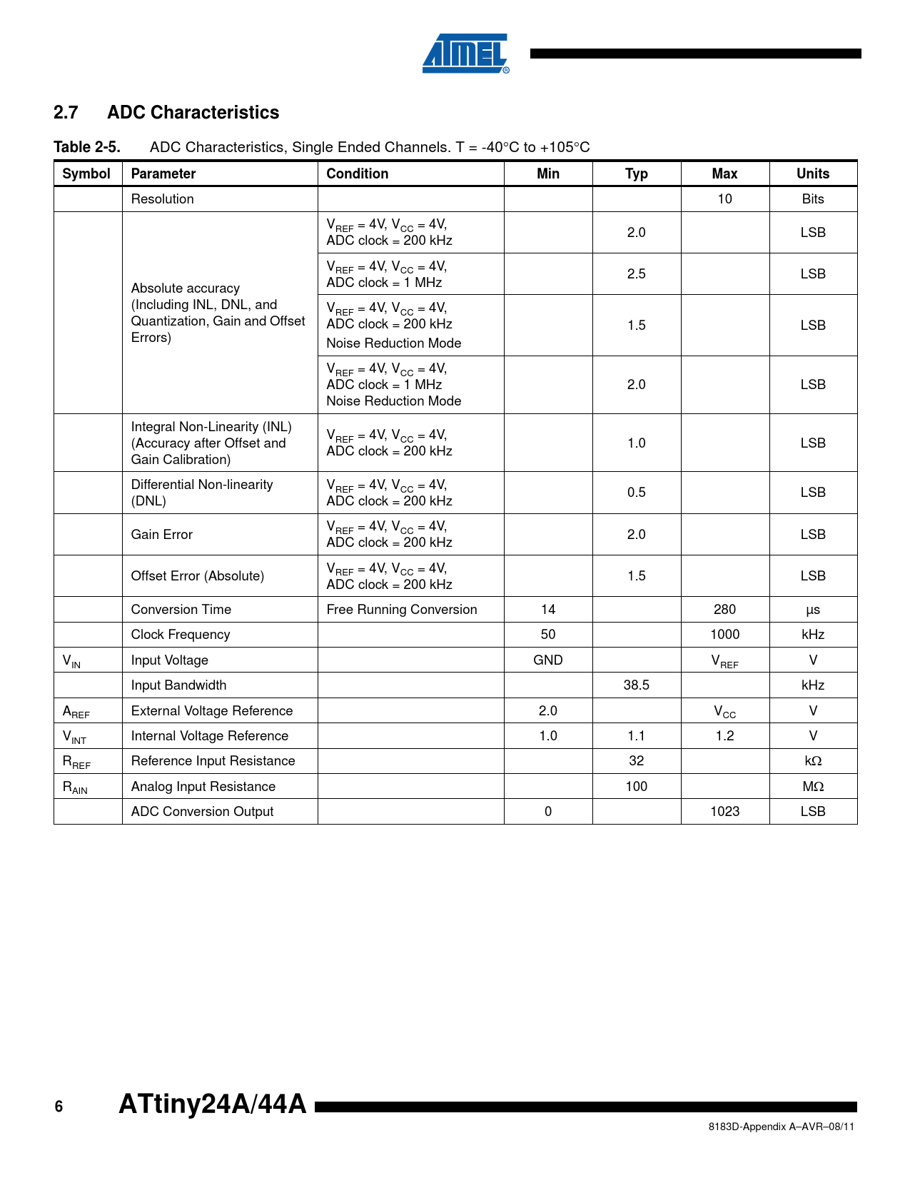

2.7. ADC Characteristics. Table 2-5. Symbol. Parameter. Condition. Min. Typ. Max. Units. ATtiny24A/44A
2.7 ADC Characteristics Table 2-5 Symbol Parameter Condition Min Typ Max Units ATtiny24A/44A
2.7 ADC Characteristics Table 2-5.
ADC Characteristics, Single Ended Channels. T = -40°C to +105°C
Resolution 10 Bits VREF = 4V, VCC = 4V, 2.0 LSB ADC clock = 200 kHz V = 4V, V = 4V, REF CC 2.5 LSB Absolute accuracy ADC clock = 1 MHz (Including INL, DNL, and VREF = 4V, VCC = 4V, Quantization, Gain and Offset ADC clock = 200 kHz 1.5 LSB Errors) Noise Reduction Mode V = 4V, V = 4V, REF CC ADC clock = 1 MHz 2.0 LSB Noise Reduction Mode Integral Non-Linearity (INL) V (Accuracy after Offset and REF = 4V, VCC = 4V, 1.0 LSB ADC clock = 200 kHz Gain Calibration) Differential Non-linearity V = 4V, V = 4V, REF CC 0.5 LSB (DNL) ADC clock = 200 kHz V Gain Error REF = 4V, VCC = 4V, 2.0 LSB ADC clock = 200 kHz V Offset Error (Absolute) REF = 4V, VCC = 4V, 1.5 LSB ADC clock = 200 kHz Conversion Time Free Running Conversion 14 280 µs Clock Frequency 50 1000 kHz V Input Voltage GND V V IN REF Input Bandwidth 38.5 kHz AREF External Voltage Reference 2.0 VCC V V Internal Voltage Reference 1.0 1.1 1.2 V INT R Reference Input Resistance 32 kΩ REF RAIN Analog Input Resistance 100 MΩ ADC Conversion Output 0 1023 LSB
