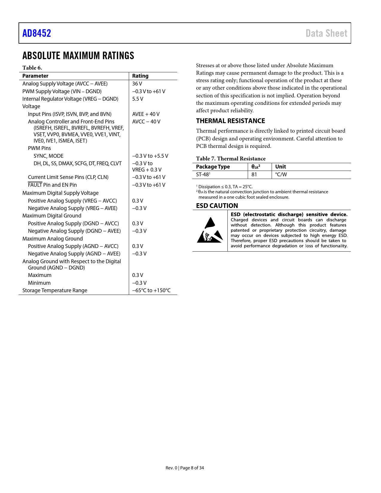

AD8452. Data Sheet. ABSOLUTE MAXIMUM RATINGS Table 6. Parameter. Rating. THERMAL RESISTANCE. Table 7. Thermal Resistance
AD8452 Data Sheet ABSOLUTE MAXIMUM RATINGS Table 6 Parameter Rating THERMAL RESISTANCE Table 7 Thermal Resistance
AD8452 Data Sheet ABSOLUTE MAXIMUM RATINGS Table 6.
Stresses at or above those listed under Absolute Maximum
Parameter Rating
Ratings may cause permanent damage to the product. This is a stress rating only; functional operation of the product at these Analog Supply Voltage (AVCC − AVEE) 36 V or any other conditions above those indicated in the operational PWM Supply Voltage (VIN – DGND) −0.3 V to +61 V section of this specification is not implied. Operation beyond Internal Regulator Voltage (VREG − DGND) 5.5 V the maximum operating conditions for extended periods may Voltage affect product reliability. Input Pins (ISVP, ISVN, BVP, and BVN) AVEE + 40 V Analog Controller and Front-End Pins AVCC − 40 V
THERMAL RESISTANCE
(ISREFH, ISREFL, BVREFL, BVREFH, VREF, Thermal performance is directly linked to printed circuit board VSET, VVP0, BVMEA, VVE0, VVE1, VINT, IVE0, IVE1, ISMEA, ISET) (PCB) design and operating environment. Careful attention to PWM Pins PCB thermal design is required. SYNC, MODE −0.3 V to +5.5 V
DH, DL, SS, DMAX, SCFG, DT, FREQ, CLVT −0.3 V to
2
VREG + 0.3 V
Package Type θJA Unit
Current Limit Sense Pins (CLP, CLN) −0.3 V to +61 V ST-481 81 °C/W FAULT Pin and EN Pin −0.3 V to +61 V 1 Dissipation ≤ 0.3, TA = 25°C. Maximum Digital Supply Voltage 2 θJA is the natural convection junction to ambient thermal resistance measured in a one cubic foot sealed enclosure. Positive Analog Supply (VREG − AVCC) 0.3 V Negative Analog Supply (VREG − AVEE) −0.3 V
