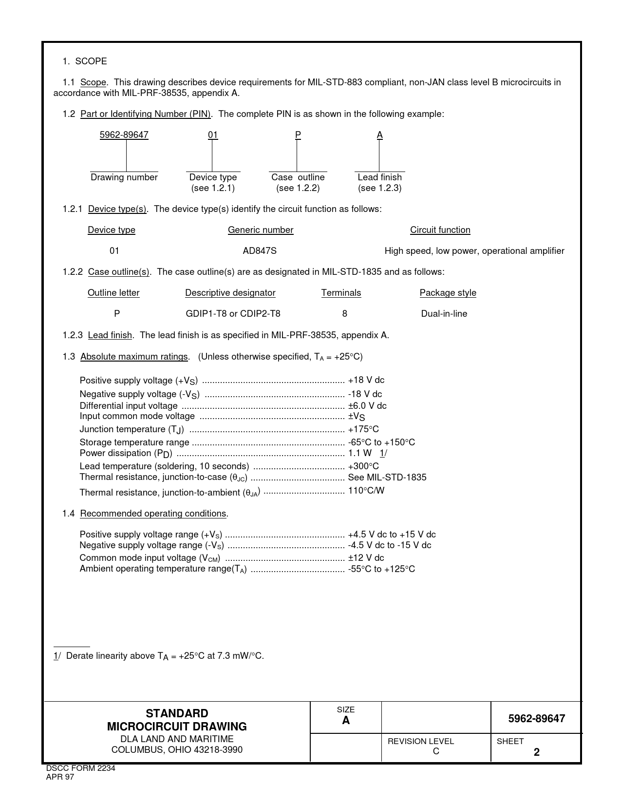

STANDARD. 5962-89647. MICROCIRCUIT DRAWING
STANDARD 5962-89647 MICROCIRCUIT DRAWING
1. SCOPE 1.1 Scope. This drawing describes device requirements for MIL-STD-883 compliant, non-JAN class level B microcircuits in accordance with MIL-PRF-38535, appendix A. 1.2 Part or Identifying Number (PIN). The complete PIN is as shown in the following example: 5962-89647 01 P A Drawing number Device type Case outline Lead finish (see 1.2.1) (see 1.2.2) (see 1.2.3) 1.2.1 Device type(s). The device type(s) identify the circuit function as follows: Device type Generic number Circuit function 01 AD847S High speed, low power, operational amplifier 1.2.2 Case outline(s). The case outline(s) are as designated in MIL-STD-1835 and as follows: Outline letter Descriptive designator Terminals Package style P GDIP1-T8 or CDIP2-T8 8 Dual-in-line 1.2.3 Lead finish. The lead finish is as specified in MIL-PRF-38535, appendix A. 1.3 Absolute maximum ratings. (Unless otherwise specified, TA = +25°C) Positive supply voltage (+VS) .. +18 V dc Negative supply voltage (-VS) ... -18 V dc Differential input voltage .. ±6.0 V dc Input common mode voltage ... ±VS Junction temperature (TJ) ... +175°C Storage temperature range .. -65°C to +150°C Power dissipation (PD) .. 1.1 W 1/ Lead temperature (soldering, 10 seconds) .. +300°C Thermal resistance, junction-to-case (θJC) ... See MIL-STD-1835 Thermal resistance, junction-to-ambient (θ ) .. 110°C/W JA 1.4 Recommended operating conditions. Positive supply voltage range (+VS) ... +4.5 V dc to +15 V dc Negative supply voltage range (-VS) .. -4.5 V dc to -15 V dc Common mode input voltage (VCM) ... ±12 V dc Ambient operating temperature range(TA) ... -55°C to +125°C 1/ Derate linearity above TA = +25°C at 7.3 mW/°C.
