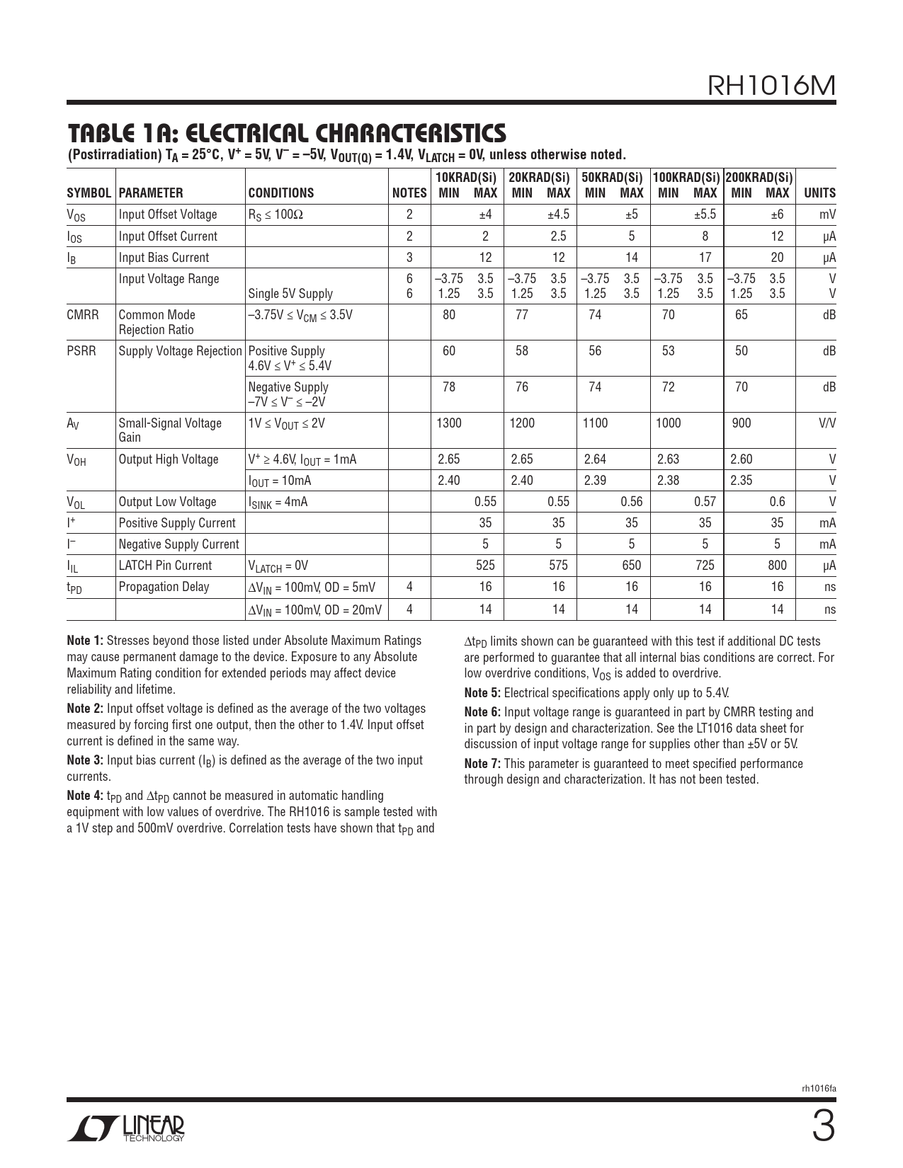

RH1016M
TABLE 1A: ELECTRICAL CHARACTERISTICS (Postirradiation) TA = 25°C, V+ = 5V, V– = –5V, VOUT(Q) = 1.4V, VLATCH = 0V, unless otherwise noted. 10KRAD(Si) 20KRAD(Si) 50KRAD(Si) 100KRAD(Si) 200KRAD(Si) SYMBOL PARAMETER CONDITIONS NOTES MIN MAX MIN MAX MIN MAX MIN MAX MIN MAX UNITS
VOS Input Offset Voltage RS ≤ 100Ω 2 ±4 ±4.5 ±5 ±5.5 ±6 mV IOS Input Offset Current 2 2 2.5 5 8 12 μA IB Input Bias Current 3 12 12 14 17 20 μA Input Voltage Range 6 –3.75 3.5 –3.75 3.5 –3.75 3.5 –3.75 3.5 –3.75 3.5 V Single 5V Supply 6 1.25 3.5 1.25 3.5 1.25 3.5 1.25 3.5 1.25 3.5 V CMRR Common Mode –3.75V ≤ VCM ≤ 3.5V 80 77 74 70 65 dB Rejection Ratio PSRR Supply Voltage Rejection Positive Supply 60 58 56 53 50 dB 4.6V ≤ V+ ≤ 5.4V Negative Supply 78 76 74 72 70 dB –7V ≤ V– ≤ –2V AV Small-Signal Voltage 1V ≤ VOUT ≤ 2V 1300 1200 1100 1000 900 V/V Gain VOH Output High Voltage V+ ≥ 4.6V, IOUT = 1mA 2.65 2.65 2.64 2.63 2.60 V IOUT = 10mA 2.40 2.40 2.39 2.38 2.35 V VOL Output Low Voltage ISINK = 4mA 0.55 0.55 0.56 0.57 0.6 V I+ Positive Supply Current 35 35 35 35 35 mA I– Negative Supply Current 5 5 5 5 5 mA IIL LATCH Pin Current VLATCH = 0V 525 575 650 725 800 μA tPD Propagation Delay ΔVIN = 100mV, OD = 5mV 4 16 16 16 16 16 ns ΔVIN = 100mV, OD = 20mV 4 14 14 14 14 14 ns
Note 1:
Stresses beyond those listed under Absolute Maximum Ratings ΔtPD limits shown can be guaranteed with this test if additional DC tests may cause permanent damage to the device. Exposure to any Absolute are performed to guarantee that all internal bias conditions are correct. For Maximum Rating condition for extended periods may affect device low overdrive conditions, VOS is added to overdrive. reliability and lifetime.
Note 5:
Electrical specifi cations apply only up to 5.4V.
Note 2:
Input offset voltage is defi ned as the average of the two voltages
Note 6:
Input voltage range is guaranteed in part by CMRR testing and measured by forcing fi rst one output, then the other to 1.4V. Input offset in part by design and characterization. See the LT1016 data sheet for current is defi ned in the same way. discussion of input voltage range for supplies other than ±5V or 5V.
Note 3:
Input bias current (IB) is defi ned as the average of the two input
Note 7:
This parameter is guaranteed to meet specifi ed performance currents. through design and characterization. It has not been tested.
Note 4:
tPD and ΔtPD cannot be measured in automatic handling equipment with low values of overdrive. The RH1016 is sample tested with a 1V step and 500mV overdrive. Correlation tests have shown that tPD and rh1016fa 3
