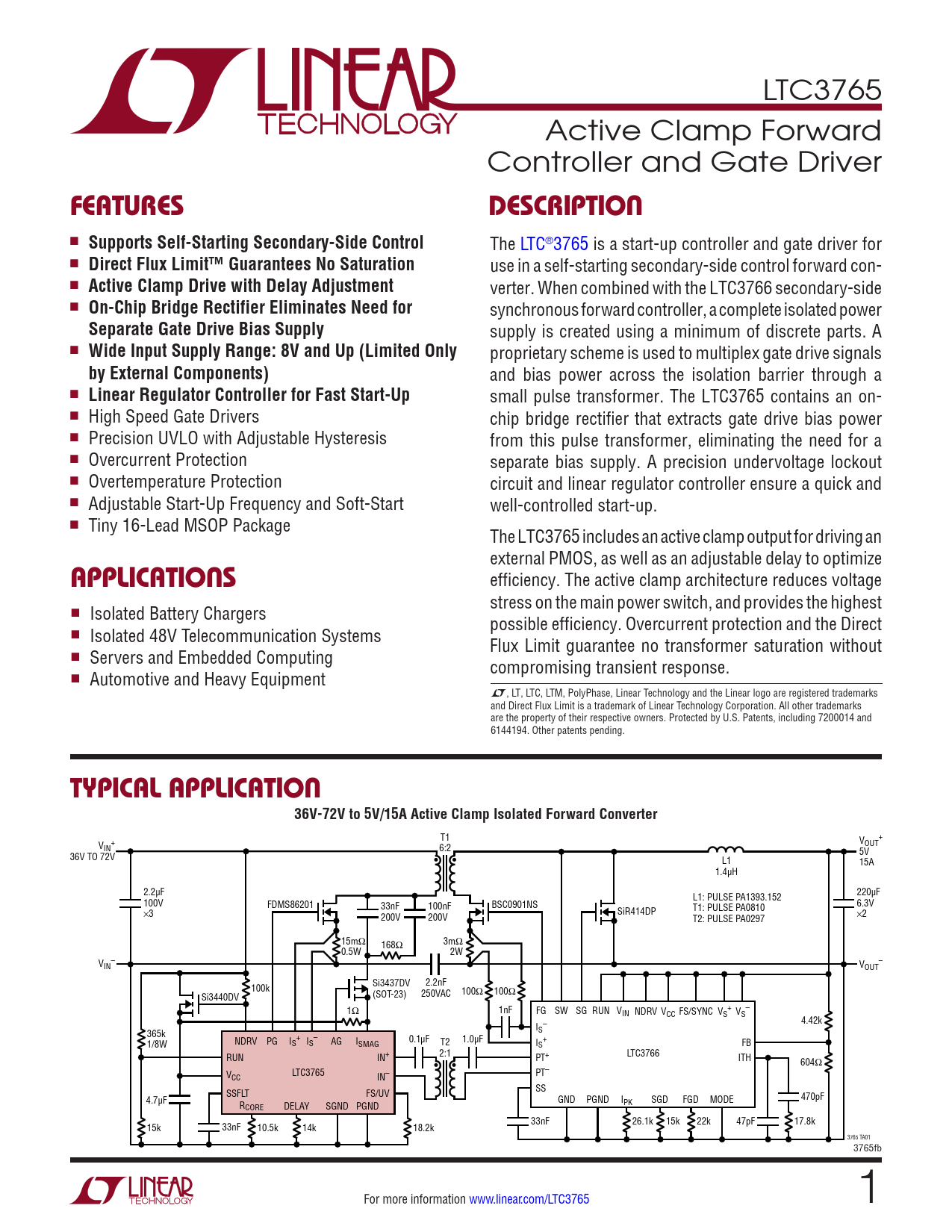

DescriptionActive Clamp Forward Controller and Gate Driver

FEATURES. DESCRIPTION. Supports Self-Starting Secondary-Side Control. Direct Flux Limit™ Guarantees No Saturation
Datasheet LTC3765 Analog Devices
LTC3765 Active Clamp Forward Controller and Gate Driver
FEATURES DESCRIPTION
n
The LTC®3765 is a start-up controller and gate driver for n
use in a self-starting secondary-side control forward con- n
Active Clamp Drive with Delay Adjustment
verter. When combined with the LTC3766 secondary-side n
On-Chip Bridge Rectifier Eliminates Need for
synchronous forward control er, a complete isolated power
Separate Gate Drive Bias Supply
supply is created using a minimum of discrete parts. A n
Wide Input Supply Range: 8V and Up (Limited Only
proprietary scheme is used to multiplex gate drive signals
by External Components)
and bias power across the isolation barrier through a n
Linear Regulator Controller for Fast Start-Up
small pulse transformer. The LTC3765 contains an on- n High Speed Gate Drivers chip bridge rectifier that extracts gate drive bias power n Precision UVLO with Adjustable Hysteresis from this pulse transformer, eliminating the need for a n Overcurrent Protection separate bias supply. A precision undervoltage lockout n Overtemperature Protection circuit and linear regulator controller ensure a quick and n Adjustable Start-Up Frequency and Soft-Start well-controlled start-up. n Tiny 16-Lead MSOP Package The LTC3765 includes an active clamp output for driving an external PMOS, as well as an adjustable delay to optimize

TYPICAL APPLICATION 36V-72V to 5V/15A Active Clamp Isolated Forward Converter
