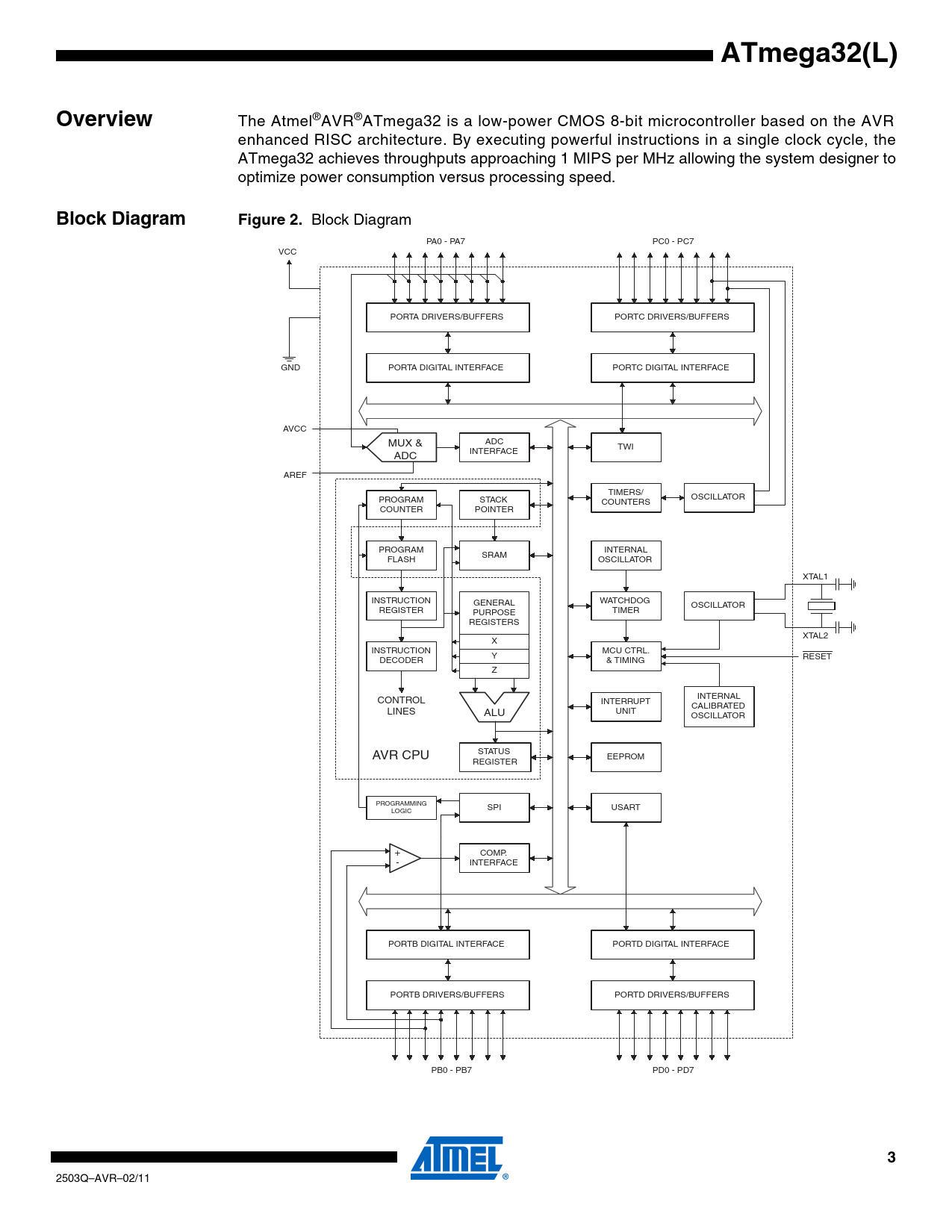

The Atmel®AVR®ATmega32 is a low-power CMOS 8-bit microcontroller based on the AVR enhanced RISC architecture. By executing powerful instructions in a single clock cycle, the ATmega32 achieves throughputs approaching 1 MIPS per MHz allowing the system designer to optimize power consumption versus processing speed.
Block Diagram Figure 2.
Block Diagram PA0 - PA7 PC0 - PC7 VCC PORTA DRIVERS/BUFFERS PORTC DRIVERS/BUFFERS GND PORTA DIGITAL INTERFACE PORTC DIGITAL INTERFACE AVCC ADC MUX & TWI INTERFACE ADC AREF TIMERS/ OSCILLATOR PROGRAM STACK COUNTERS COUNTER POINTER PROGRAM INTERNAL SRAM FLASH OSCILLATOR XTAL1 INSTRUCTION WATCHDOG GENERAL OSCILLATOR REGISTER TIMER PURPOSE REGISTERS XTAL2 X INSTRUCTION MCU CTRL. Y RESET DECODER & TIMING Z CONTROL INTERNAL INTERRUPT CALIBRATED LINES UNIT ALU OSCILLATOR STATUS AVR CPU EEPROM REGISTER PROGRAMMING SPI USART LOGIC + COMP. - INTERFACE PORTB DIGITAL INTERFACE PORTD DIGITAL INTERFACE PORTB DRIVERS/BUFFERS PORTD DRIVERS/BUFFERS PB0 - PB7 PD0 - PD7
