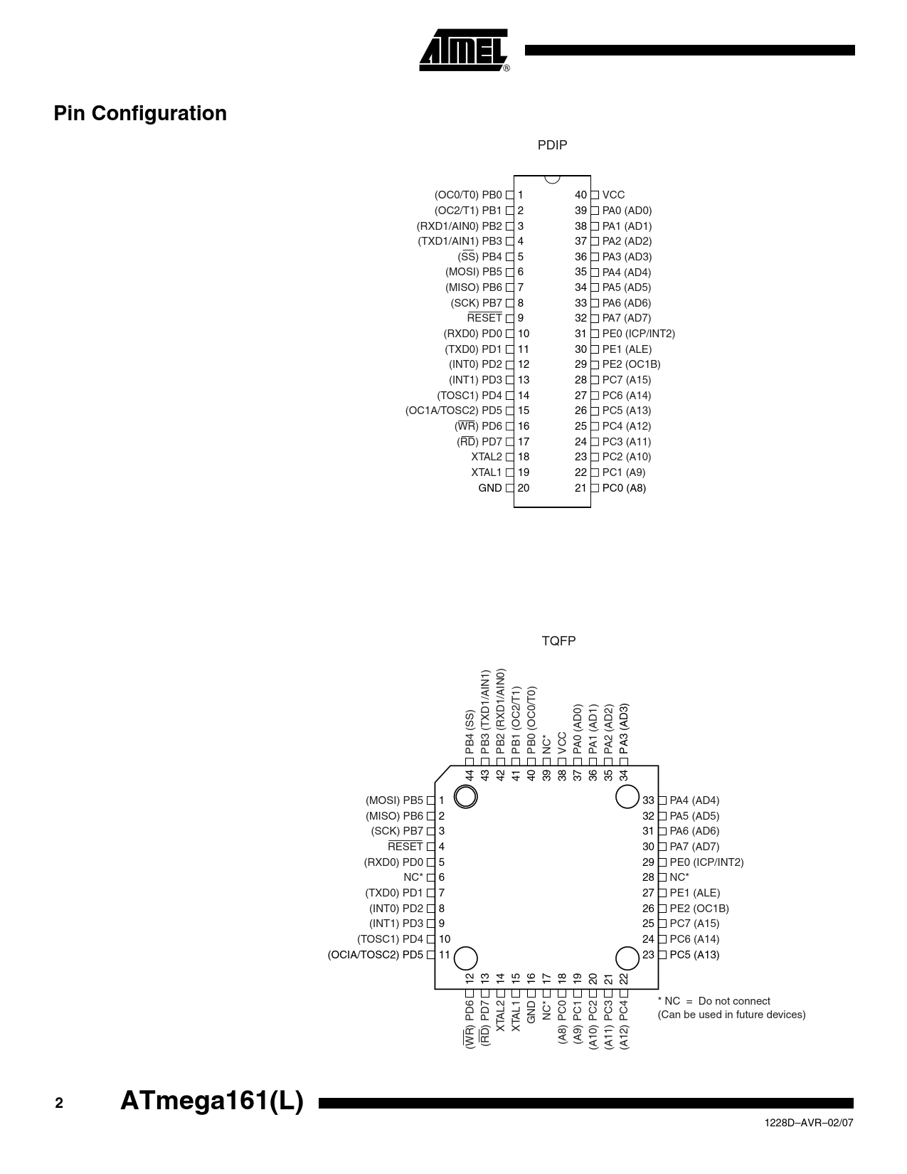

Pin Configuration. ATmega161(L)
Pin Configuration ATmega161(L)
Pin Configuration
PDIP (OC0/T0) PB0 1 40 VCC (OC2/T1) PB1 2 39 PA0 (AD0) (RXD1/AIN0) PB2 3 38 PA1 (AD1) (TXD1/AIN1) PB3 4 37 PA2 (AD2) (SS) PB4 5 36 PA3 (AD3) (MOSI) PB5 6 35 PA4 (AD4) (MISO) PB6 7 34 PA5 (AD5) (SCK) PB7 8 33 PA6 (AD6) RESET 9 32 PA7 (AD7) (RXD0) PD0 10 31 PE0 (ICP/INT2) (TXD0) PD1 11 30 PE1 (ALE) (INT0) PD2 12 29 PE2 (OC1B) (INT1) PD3 13 28 PC7 (A15) (TOSC1) PD4 14 27 PC6 (A14) (OC1A/TOSC2) PD5 15 26 PC5 (A13) (WR) PD6 16 25 PC4 (A12) (RD) PD7 17 24 PC3 (A11) XTAL2 18 23 PC2 (A10) XTAL1 19 22 PC1 (A9) GND 20 21 PC0 (A8) TQFP A0 (AD0) A1 (AD1) A2 (AD2) PB4 (SS) PB3 (TXD1/AIN1) PB2 (RXD1/AIN0) PB1 (OC2/T1) PB0 (OC0/T0) NC* VCC P P P PA3 (AD3) 44 43 42 41 40 39 38 37 36 35 34 (MOSI) PB5 1 33 PA4 (AD4) (MISO) PB6 2 32 PA5 (AD5) (SCK) PB7 3 31 PA6 (AD6) RESET 4 30 PA7 (AD7) (RXD0) PD0 5 29 PE0 (ICP/INT2) NC* 6 28 NC* (TXD0) PD1 7 27 PE1 (ALE) (INT0) PD2 8 26 PE2 (OC1B) (INT1) PD3 9 25 PC7 (A15) (TOSC1) PD4 10 24 PC6 (A14) (OCIA/TOSC2) PD5 11 23 PC5 (A13) 12 13 14 15 16 17 18 19 20 21 22 * NC = Do not connect AL2 AL1 (Can be used in future devices) GND NC* XT XT (WR) PD6 (RD) PD7 (A8) PC0 (A9) PC1 (A10) PC2 (A11) PC3 (A12) PC4
2 ATmega161(L)
