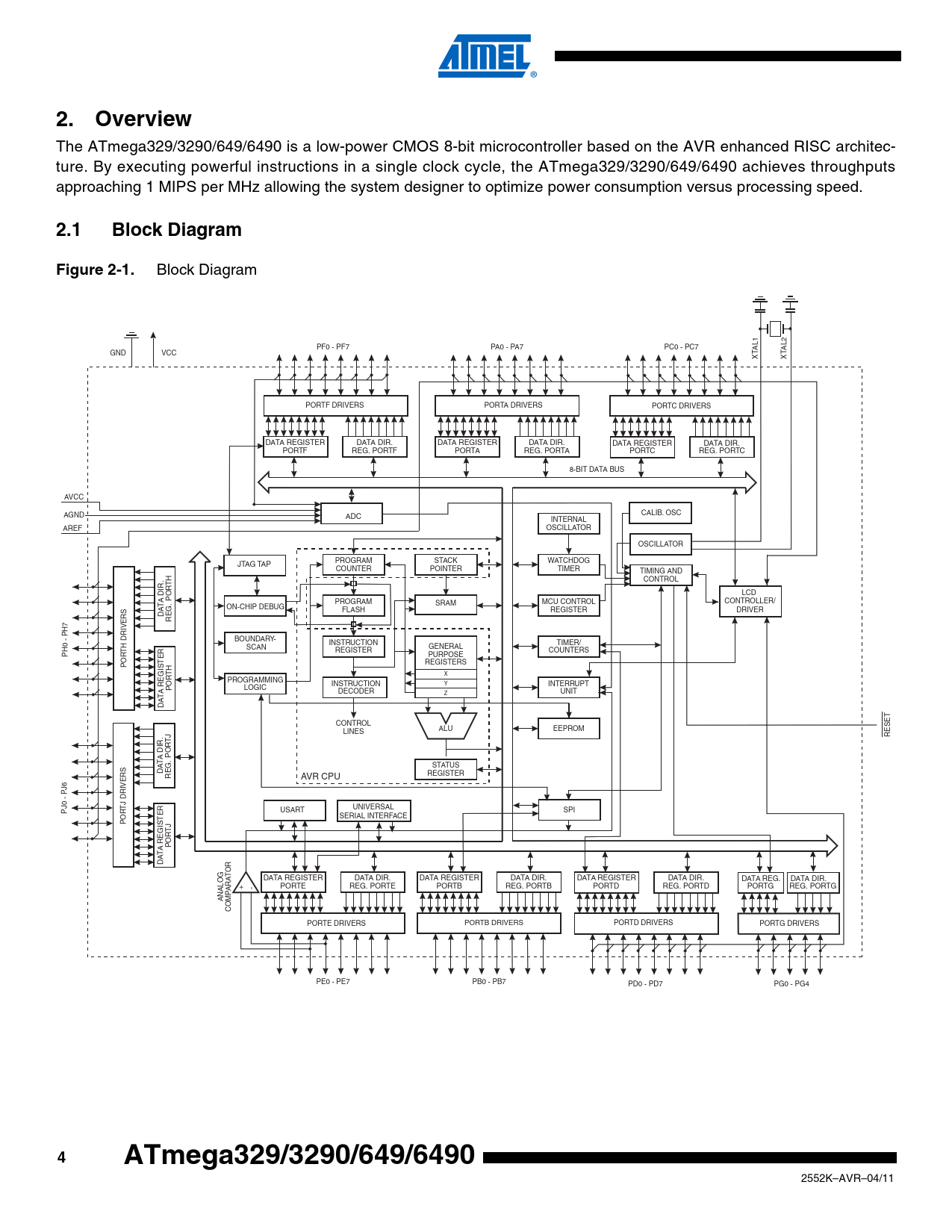

Overview. 2.1. Block Diagram. Figure 2-1. ATmega329/3290/649/6490
Overview 2.1 Block Diagram Figure 2-1 ATmega329/3290/649/6490
2. Overview
The ATmega329/3290/649/6490 is a low-power CMOS 8-bit microcontroller based on the AVR enhanced RISC architec- ture. By executing powerful instructions in a single clock cycle, the ATmega329/3290/649/6490 achieves throughputs approaching 1 MIPS per MHz allowing the system designer to optimize power consumption versus processing speed.
2.1 Block Diagram Figure 2-1.
Block Diagram PF0 - PF7 PA0 - PA7 PC0 - PC7 AL1 AL2 GND VCC XT XT PORTF DRIVERS PORTA DRIVERS PORTC DRIVERS DATA REGISTER DATA DIR. DATA REGISTER DATA DIR. DATA REGISTER DATA DIR. PORTF REG. PORTF PORTA REG. PORTA PORTC REG. PORTC 8-BIT DATA BUS AVCC CALIB. OSC AGND ADC INTERNAL AREF OSCILLATOR OSCILLATOR PROGRAM STACK WATCHDOG JTAG TAP COUNTER POINTER TIMER TIMING AND H CONTROL T DIR. LCD A POR PROGRAM SRAM MCU CONTROL CONTROLLER/ T ON-CHIP DEBUG A FLASH REGISTER DRIVER D REG. BOUNDARY- INSTRUCTION TIMER/ SCAN GENERAL TH DRIVERS REGISTER COUNTERS PH0 - PH7 PURPOSE REGISTERS POR H T X PROGRAMMING REGISTER INSTRUCTION Y INTERRUPT POR LOGIC A DECODER Z UNIT T A D CONTROL ALU EEPROM LINES J RESET T DIR. A POR T A STATUS D REGISTER REG. AVR CPU TJ DRIVERS PJ0 - PJ6 USART UNIVERSAL SPI SERIAL INTERFACE POR J T REGISTER A POR T A D R O T DATA REGISTER DATA DIR. DATA REGISTER DATA DIR. DATA REGISTER DATA DIR. DATA REG. DATA DIR. ARA + - PORTE REG. PORTE PORTB REG. PORTB PORTD REG. PORTD PORTG REG. PORTG ANALOG COMP PORTE DRIVERS PORTB DRIVERS PORTD DRIVERS PORTG DRIVERS PE0 - PE7 PB0 - PB7 PD0 - PD7 PG0 - PG4
