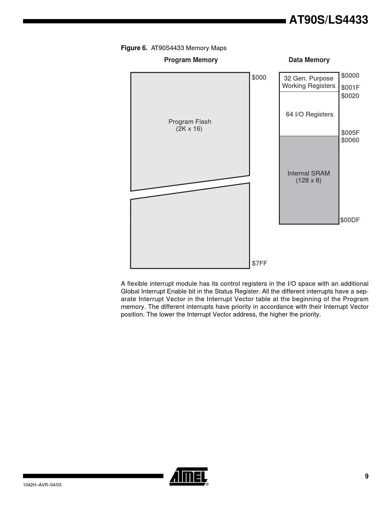

AT90S/LS4433. Figure 6. Program Memory. Data Memory
AT90S/LS4433 Figure 6 Program Memory Data Memory
AT90S/LS4433 Figure 6.
AT90S4433 Memory Maps
$000 32 Gen. Purpose $0000 Working Registers $001F $0020 64 I/O Registers Program Flash (2K x 16) $005F $0060 Internal SRAM (128 x 8) $00DF $7FF A flexible interrupt module has its control registers in the I/O space with an additional Global Interrupt Enable bit in the Status Register. All the different interrupts have a sep- arate Interrupt Vector in the Interrupt Vector table at the beginning of the Program memory. The different interrupts have priority in accordance with their Interrupt Vector position. The lower the Interrupt Vector address, the higher the priority.
