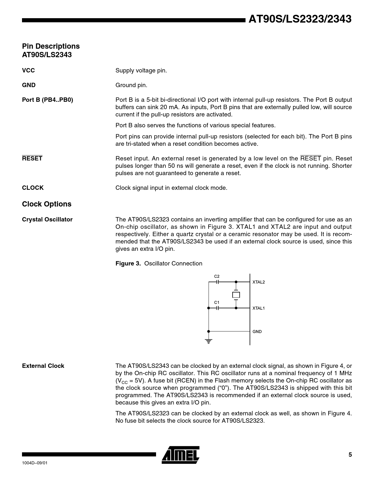

Crystal Oscillator The AT90S/LS2323 contains an inverting amplifier that can be configured for use as an
On-chip oscillator, as shown in Figure 3. XTAL1 and XTAL2 are input and output
respectively. Either a quartz crystal or a ceramic resonator may be used. It is recommended that the AT90S/LS2343 be used if an external clock source is used, since this
gives an extra I/O pin.
Figure 3. Oscillator Connection External Clock The AT90S/LS2343 can be clocked by an external clock signal, as shown in Figure 4, or
