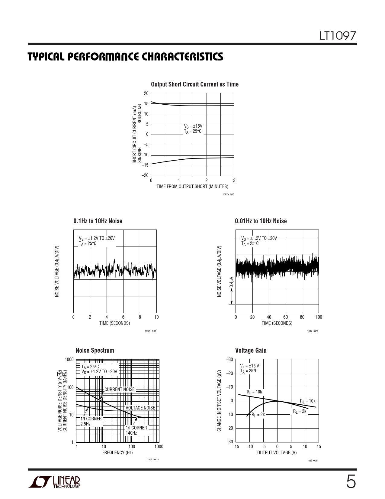

TYPICAL PERFORMANCE CHARACTERISTICS. Output Short Circuit Current vs Time. 0.1Hz to 10Hz Noise. 0.01Hz to 10Hz Noise
TYPICAL PERFORMANCE CHARACTERISTICS Output Short Circuit Current vs Time 0.1Hz to 10Hz Noise 0.01Hz to 10Hz Noise
LT1097
W U TYPICAL PERFORMANCE CHARACTERISTICS Output Short Circuit Current vs Time
20 15 10 SOURCING 5 VS = ±15V TA = 25°C 0 –5 –10 SHORT CIRCUIT CURRENT (mA) SINKING –15 –20 0 1 2 3 TIME FROM OUTPUT SHORT (MINUTES) 1097 • G07
VS = ±1.2V TO ±20V VS = ±1.2V TO ±20V TA = 25°C TA = 25°C µV/DIV) µV/DIV) µV 0.4 NOISE VOLTAGE (0.4 NOISE VOLTAGE (0.4 0 2 4 6 8 10 0 20 40 60 80 100 TIME (SECONDS) TIME (SECONDS) 1097 • G08 1097 • G09
Noise Spectrum Voltage Gain
1000 –30 T V A = 25°C s = ±15 V V T S = ±1.2V TO ±20V –20 A = 25°C √Hz) √Hz) µV) 100 –10 CURRENT NOISE RL = 10k 0 RL = 10k VOLTAGE NOISE RL = 2k 10 10 RL = 2k 1/f CORNER 2.5Hz 1/f CORNER VOLTAGE NOISE DENSITY (nV CURRENT NOISE DENSITY (fA CHANGE IN OFFSET VOLTAGE ( 20 140Hz 1 30 1 10 100 1000 –15 –10 –5 0 5 10 15 FREQUENCY (Hz) OUTPUT VOLTAGE (V) 1097 • G10 1097 • G11 5
