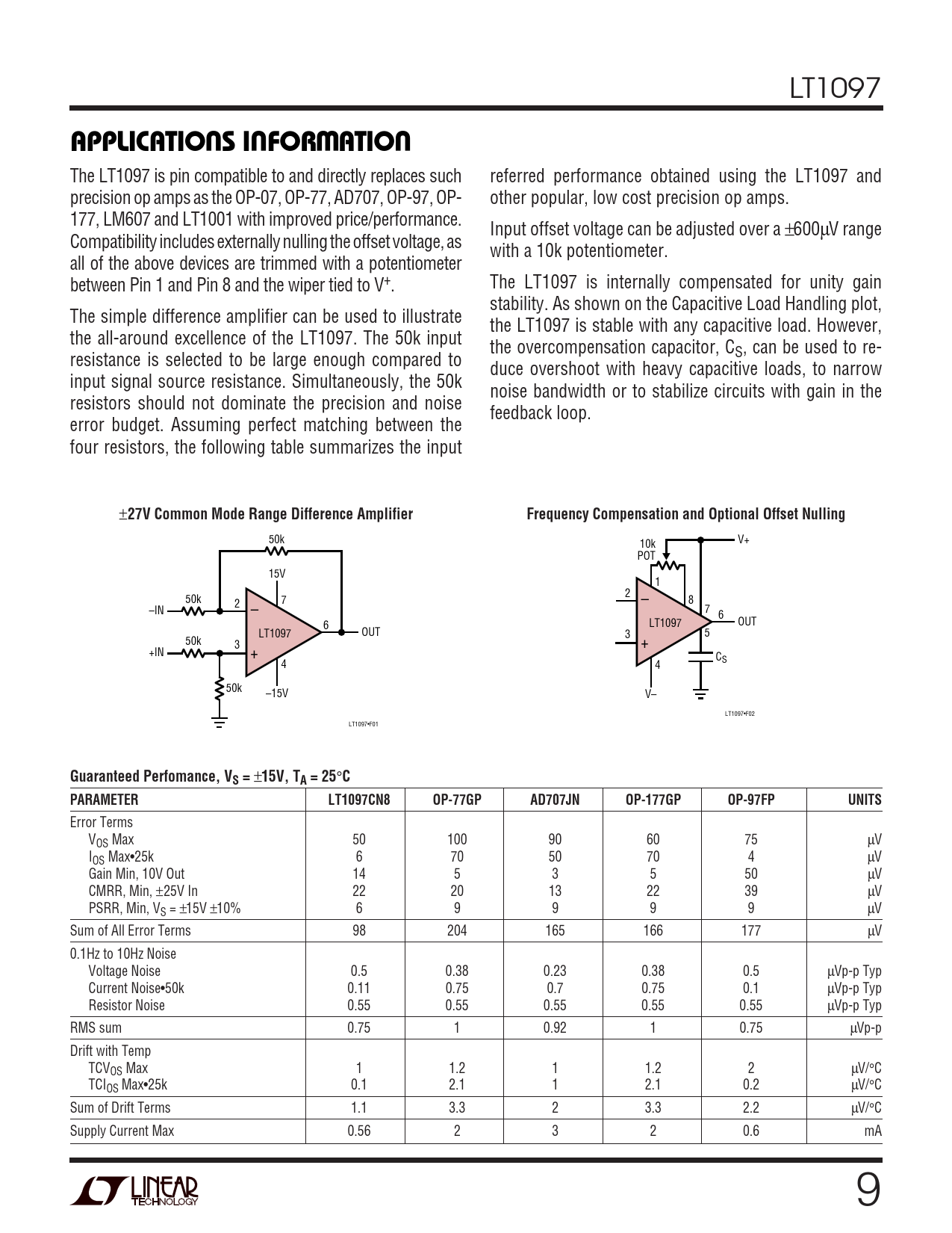

U U W U APPLICATIONS INFORMATION
The LT1097 is pin compatible to and directly replaces such referred performance obtained using the LT1097 and precision op amps as the OP-07, OP-77, AD707, OP-97, OP- other popular, low cost precision op amps. 177, LM607 and LT1001 with improved price/performance. Input offset voltage can be adjusted over a ±600µV range Compatibility includes externally nulling the offset voltage, as with a 10k potentiometer. all of the above devices are trimmed with a potentiometer between Pin 1 and Pin 8 and the wiper tied to V+. The LT1097 is internally compensated for unity gain stability. As shown on the Capacitive Load Handling plot, The simple difference amplifier can be used to illustrate the LT1097 is stable with any capacitive load. However, the all-around excellence of the LT1097. The 50k input the overcompensation capacitor, C resistance is selected to be large enough compared to S, can be used to re- duce overshoot with heavy capacitive loads, to narrow input signal source resistance. Simultaneously, the 50k noise bandwidth or to stabilize circuits with gain in the resistors should not dominate the precision and noise feedback loop. error budget. Assuming perfect matching between the four resistors, the following table summarizes the input ±
27V Common Mode Range Difference Amplifier Frequency Compensation and Optional Offset Nulling
50k V+ 10k POT 15V 1 2 50k 2 7 – 8 –IN – 7 6 6 LT1097 OUT LT1097 OUT 3 5 50k 3 + +IN + C 4 S 4 50k –15V V– LT1097•F02 LT1097•F01
Guaranteed Perfomance, VS =
15V, TA = 25
C PARAMETER LT1097CN8 OP-77GP AD707JN OP-177GP OP-97FP UNITS
