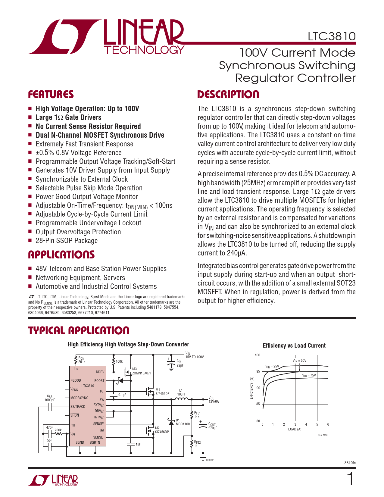

LTC3810 100V Current Mode Synchronous Switching Regulator Controller
FEATURES DESCRIPTION
n
High Voltage Operation: Up to 100V
The LTC3810 is a synchronous step-down switching n
Large 1
Ω
Gate Drivers
regulator controller that can directly step-down voltages n
No Current Sense Resistor Required
from up to 100V, making it ideal for telecom and automo- n
Dual N-Channel MOSFET Synchronous Drive
tive applications. The LTC3810 uses a constant on-time n Extremely Fast Transient Response valley current control architecture to deliver very low duty n ±0.5% 0.8V Voltage Reference cycles with accurate cycle-by-cycle current limit, without n Programmable Output Voltage Tracking/Soft-Start requiring a sense resistor. n Generates 10V Driver Supply from Input Supply A precise internal reference provides 0.5% DC accuracy. A n Synchronizable to External Clock high bandwidth (25MHz) error amplifi er provides very fast n Selectable Pulse Skip Mode Operation line and load transient response. Large 1Ω gate drivers n Power Good Output Voltage Monitor allow the LTC3810 to drive multiple MOSFETs for higher n Adjustable On-Time/Frequency: tON(MIN) < 100ns current applications. The operating frequency is selected n Adjustable Cycle-by-Cycle Current Limit by an external resistor and is compensated for variations n Programmable Undervoltage Lockout in VIN and can also be synchronized to an external clock n Output Overvoltage Protection for switching-noise sensitive applications. A shutdown pin n 28-Pin SSOP Package allows the LTC3810 to be turned off, reducing the supply current to 240μA.
APPLICATIONS
Integrated bias control generates gate drive power from the n 48V Telecom and Base Station Power Supplies input supply during start-up and when an output short- n Networking Equipment, Servers circuit occurs, with the addition of a small external SOT23 n Automotive and Industrial Control Systems MOSFET. When in regulation, power is derived from the L, LT, LTC, LTM, Linear Technology, Burst Mode and the Linear logo are registered trademarks and No RSENSE is a trademark of Linear Technology Corporation. All other trademarks are the output for higher effi ciency. property of their respective owners. Protected by U.S. Patents including 5481178, 5847554, 6304066, 6476589, 6580258, 6677210, 6774611.
TYPICAL APPLICATION High Effi ciency High Voltage Step-Down Converter Effi ciency vs Load Current
