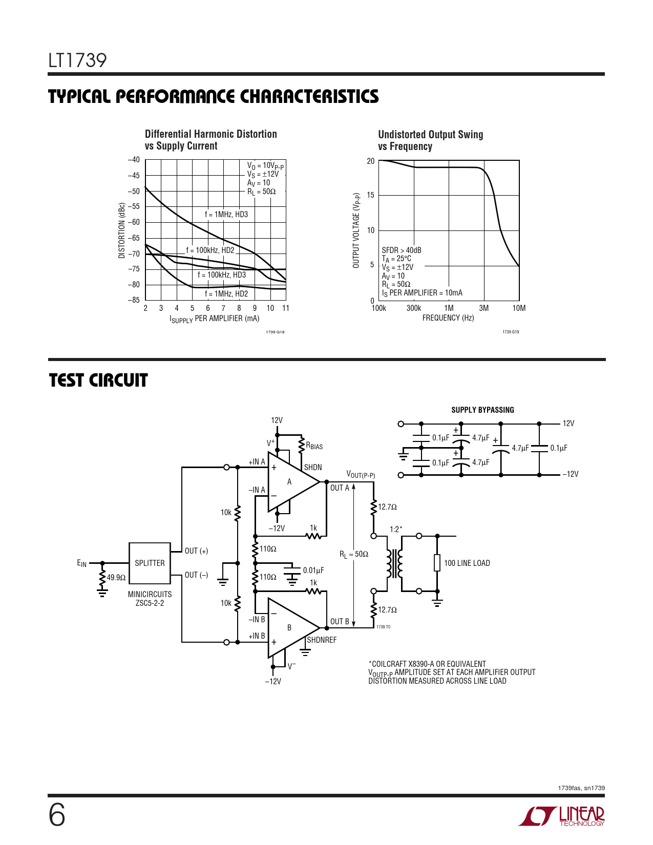

TYPICAL PERFOR A CE CHARACTERISTICS. Differential Harmonic Distortion. Undistorted Output Swing. vs Supply Current
TYPICAL PERFOR A CE CHARACTERISTICS Differential Harmonic Distortion Undistorted Output Swing vs Supply Current
LT1739
W U TYPICAL PERFOR A CE CHARACTERISTICS Differential Harmonic Distortion Undistorted Output Swing vs Supply Current vs Frequency
–40 20 VO = 10VP-P –45 VS = ±12V AV = 10 –50 RL = 50Ω ) 15 P-P –55 f = 1MHz, HD3 –60 10 –65 f = 100kHz, HD2 SFDR > 40dB DISTORTION (dBc) –70 TA = 25°C OUTPUT VOLTAGE (V 5 V –75 S = ±12V f = 100kHz, HD3 AV = 10 –80 RL = 50Ω f = 1MHz, HD2 IS PER AMPLIFIER = 10mA –85 0 2 3 4 5 6 7 8 9 10 11 100k 300k 1M 3M 10M I FREQUENCY (Hz) SUPPLY PER AMPLIFIER (mA) 1739 G18 1739 G19
TEST CIRCUIT SUPPLY BYPASSING
