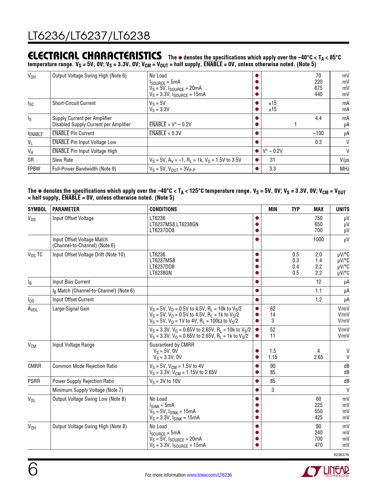

e lecTrical characTerisTics The. denotes the specifications which apply over the –40°C < TA < 85°C
e lecTrical characTerisTics The denotes the specifications which apply over the –40°C < TA < 85°C
LT6236/LT6237/LT6238
l
denotes the specifications which apply over the –40°C < TA < 85°C temperature range. VS = 5V, 0V; VS = 3.3V, 0V; VCM = VOUT = half supply, ENABLE = 0V, unless otherwise noted. (Note 5)
VOH Output Voltage Swing High (Note 6) No Load l 70 mV ISOURCE = 5mA l 220 mV VS = 5V, ISOURCE = 20mA l 675 mV VS = 3.3V, ISOURCE = 15mA l 440 mV ISC Short-Circuit Current VS = 5V l ±15 mA VS = 3.3V l ±15 mA IS Supply Current per Amplifier l 4.4 mA Disabled Supply Current per Amplifier ENABLE = V+ – 0.2V l 1 µA IENABLE ENABLE Pin Current ENABLE = 0.3V l –100 µA VL ENABLE Pin Input Voltage Low l 0.3 V VH ENABLE Pin Input Voltage High l V+ – 0.2V V SR Slew Rate VS = 5V, AV = –1, RL = 1k, VO = 1.5V to 3.5V l 31 V/µs FPBW Full-Power Bandwidth (Note 9) VS = 5V, VOUT = 3VP-P l 3.3 MHz
The
l
denotes the specifications which apply over the –40°C < TA < 125°C temperature range. VS = 5V, 0V; VS = 3.3V, 0V; VCM = VOUT = half supply, ENABLE = 0V, unless otherwise noted. (Note 5) SYMBOL PARAMETER CONDITIONS MIN TYP MAX UNITS
VOS Input Offset Voltage LT6236 l 750 µV LT6237MS8,LT6238GN l 650 µV LT6237DD8 l 700 µV Input Offset Voltage Match l 1000 µV (Channel-to-Channel) (Note 6) VOS TC Input Offset Voltage Drift (Note 10) LT6236 l 0.5 2.0 µV/°C LT6237MS8 l 0.3 1.4 µV/°C LT6237DD8 l 0.4 2.2 µV/°C LT6238GN l 0.5 2.2 µV/°C IB Input Bias Current l 12 µA IB Match (Channel-to-Channel) (Note 6) l 1.1 µA IOS Input Offset Current l 1.2 µA AVOL Large-Signal Gain VS = 5V, VO = 0.5V to 4.5V, RL = 10k to VS/2 l 62 V/mV VS = 5V, VO = 0.5V to 4.5V, RL = 1k to VS/2 l 14 V/mV VS = 5V, VO = 1V to 4V, RL = 100Ω to VS/2 l 3 V/mV VS = 3.3V, VO = 0.65V to 2.65V, RL = 10k to VS/2 l 52 V/mV VS = 3.3V, VO = 0.65V to 2.65V, RL = 1k to VS/2 l 11 V/mV VCM Input Voltage Range Guaranteed by CMRR VS = 5V, 0V l 1.5 4 V VS = 3.3V, 0V l 1.15 2.65 V CMRR Common Mode Rejection Ratio VS = 5V, VCM = 1.5V to 4V l 90 dB VS = 3.3V, VCM = 1.15V to 2.65V l 85 dB PSRR Power Supply Rejection Ratio VS = 3V to 10V l 85 dB Minimum Supply Voltage (Note 7) l 3 V VOL Output Voltage Swing Low (Note 8) No Load l 60 mV ISINK = 5mA l 225 mV VS = 5V, ISINK = 15mA l 550 mV VS = 3.3V, ISINK = 15mA l 425 mV VOH Output Voltage Swing High (Note 8) No Load l 80 mV ISOURCE = 5mA l 240 mV VS = 5V, ISOURCE = 20mA l 700 mV VS = 3.3V, ISOURCE = 15mA l 470 mV 623637fb 6 For more information www.linear.com/LT6236
