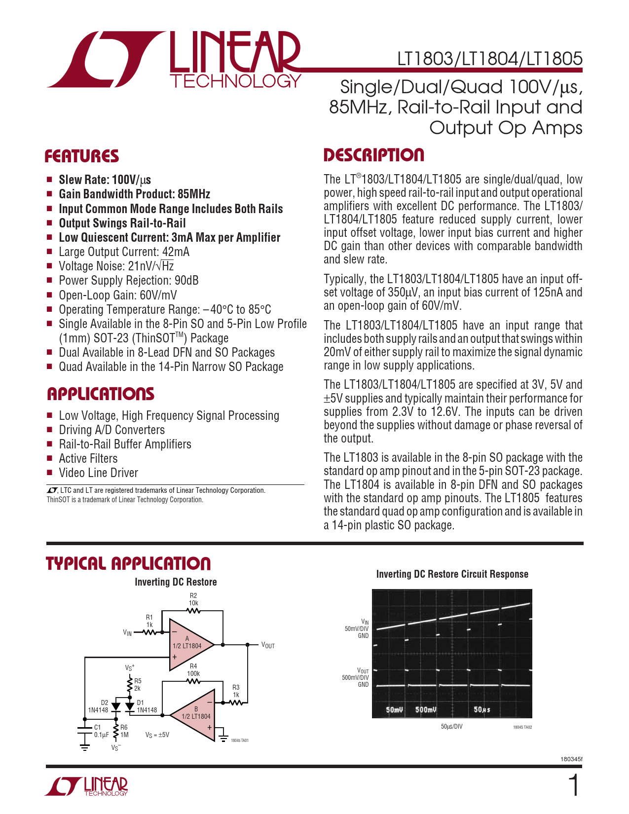

U TYPICAL APPLICATIO Inverting DC Restore Circuit Response Inverting DC Restore
R2 10k R1 V 1k – IN 50mV/DIV VIN A GND 1/2 LT1804 VOUT + + R4 VS V 100k OUT 500mV/DIV R5 GND 2k R3 – 1k D2 D1 1N4148 1N4148 B 1/2 LT1804 + C1 R6 50µs/DIV 18045 TA02 0.1µF 1M VS = ±5V 18045 TA01 V – S 180345f 1
