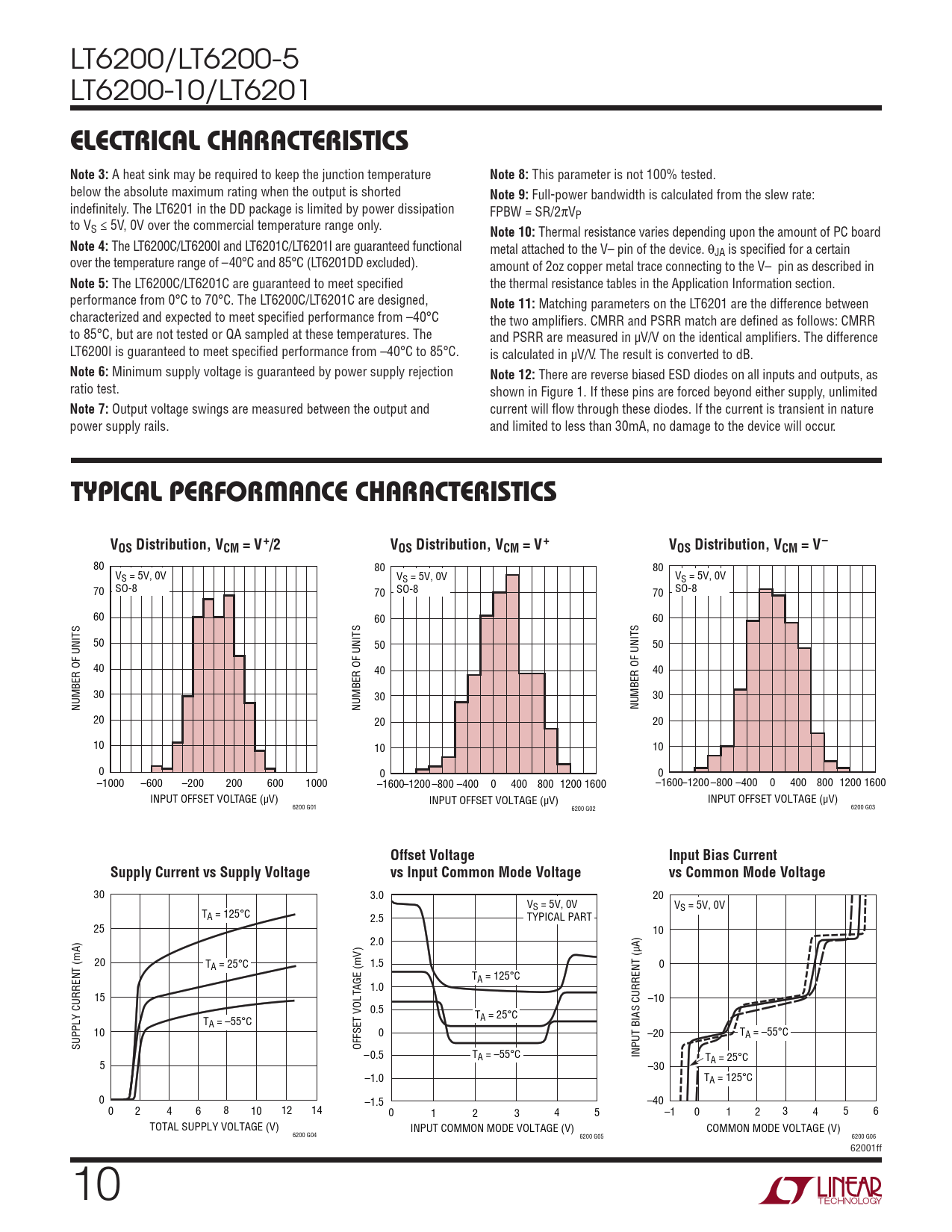

elecTrical characTerisTics Note 3:. Note 8:. Note 9:. Note 10:. Note 4:. Note 5:. Note 11:. Note 6:. Note 12:. Note 7:
elecTrical characTerisTics Note 3: Note 8: Note 9: Note 10: Note 4: Note 5: Note 11: Note 6: Note 12: Note 7:
LT6200/LT6200-5 LT6200-10/LT6201
A heat sink may be required to keep the junction temperature
Note 8:
This parameter is not 100% tested. below the absolute maximum rating when the output is shorted
Note 9:
Full-power bandwidth is calculated from the slew rate: indefinitely. The LT6201 in the DD package is limited by power dissipation FPBW = SR/2πVP to VS ≤ 5V, 0V over the commercial temperature range only.
Note 10:
Thermal resistance varies depending upon the amount of PC board
Note 4:
The LT6200C/LT6200I and LT6201C/LT6201I are guaranteed functional metal attached to the V– pin of the device. θJA is specified for a certain over the temperature range of –40°C and 85°C (LT6201DD excluded). amount of 2oz copper metal trace connecting to the V– pin as described in
Note 5:
The LT6200C/LT6201C are guaranteed to meet specified the thermal resistance tables in the Application Information section. performance from 0°C to 70°C. The LT6200C/LT6201C are designed,
Note 11:
Matching parameters on the LT6201 are the difference between characterized and expected to meet specified performance from –40°C the two amplifiers. CMRR and PSRR match are defined as follows: CMRR to 85°C, but are not tested or QA sampled at these temperatures. The and PSRR are measured in µV/V on the identical amplifiers. The difference LT6200I is guaranteed to meet specified performance from –40°C to 85°C. is calculated in µV/V. The result is converted to dB.
Note 6:
Minimum supply voltage is guaranteed by power supply rejection
Note 12:
There are reverse biased ESD diodes on all inputs and outputs, as ratio test. shown in Figure 1. If these pins are forced beyond either supply, unlimited
Note 7:
Output voltage swings are measured between the output and current will flow through these diodes. If the current is transient in nature power supply rails. and limited to less than 30mA, no damage to the device will occur.
Typical perForMance characTerisTics VOS Distribution, VCM = V+/2 VOS Distribution, VCM = V+ VOS Distribution, VCM = V–
80 80 80 VS = 5V, 0V VS = 5V, 0V VS = 5V, 0V 70 SO-8 70 SO-8 70 SO-8 60 60 60 50 50 50 40 40 40 30 30 30 NUMBER OF UNITS NUMBER OF UNITS NUMBER OF UNITS 20 20 20 10 10 10 0 0 0 –1000 –600 –200 200 600 1000 –1600–1200 –800 –400 0 400 800 1200 1600 –1600–1200 –800 –400 0 400 800 1200 1600 INPUT OFFSET VOLTAGE (µV) INPUT OFFSET VOLTAGE (µV) INPUT OFFSET VOLTAGE (µV) 6200 G01 6200 G02 6200 G03
Offset Voltage Input Bias Current Supply Current vs Supply Voltage vs Input Common Mode Voltage vs Common Mode Voltage
30 3.0 20 VS = 5V, 0V V T S = 5V, 0V A = 125°C 2.5 TYPICAL PART 25 10 2.0 20 TA = 25°C 1.5 0 TA = 125°C 1.0 15 –10 0.5 T T A = 25°C A = –55°C 10 0 –20 TA = –55°C SUPPLY CURRENT (mA) OFFSET VOLTAGE (mV) –0.5 TA = –55°C INPUT BIAS CURRENT (µA) T 5 –30 A = 25°C –1.0 TA = 125°C 0 –1.5 –40 0 2 4 6 8 10 12 14 0 1 2 3 4 5 –1 0 1 2 3 4 5 6 TOTAL SUPPLY VOLTAGE (V) INPUT COMMON MODE VOLTAGE (V) COMMON MODE VOLTAGE (V) 6200 G04 6200 G05 6200 G06 62001ff 10 Document Outline Features Applications Description Typical Application Absolute Maximum Ratings Pin Configuration Order Information Electrical Characteristics Typical Performance Characteristics Applications Information Package Description Revision History Typical Application Related Parts
