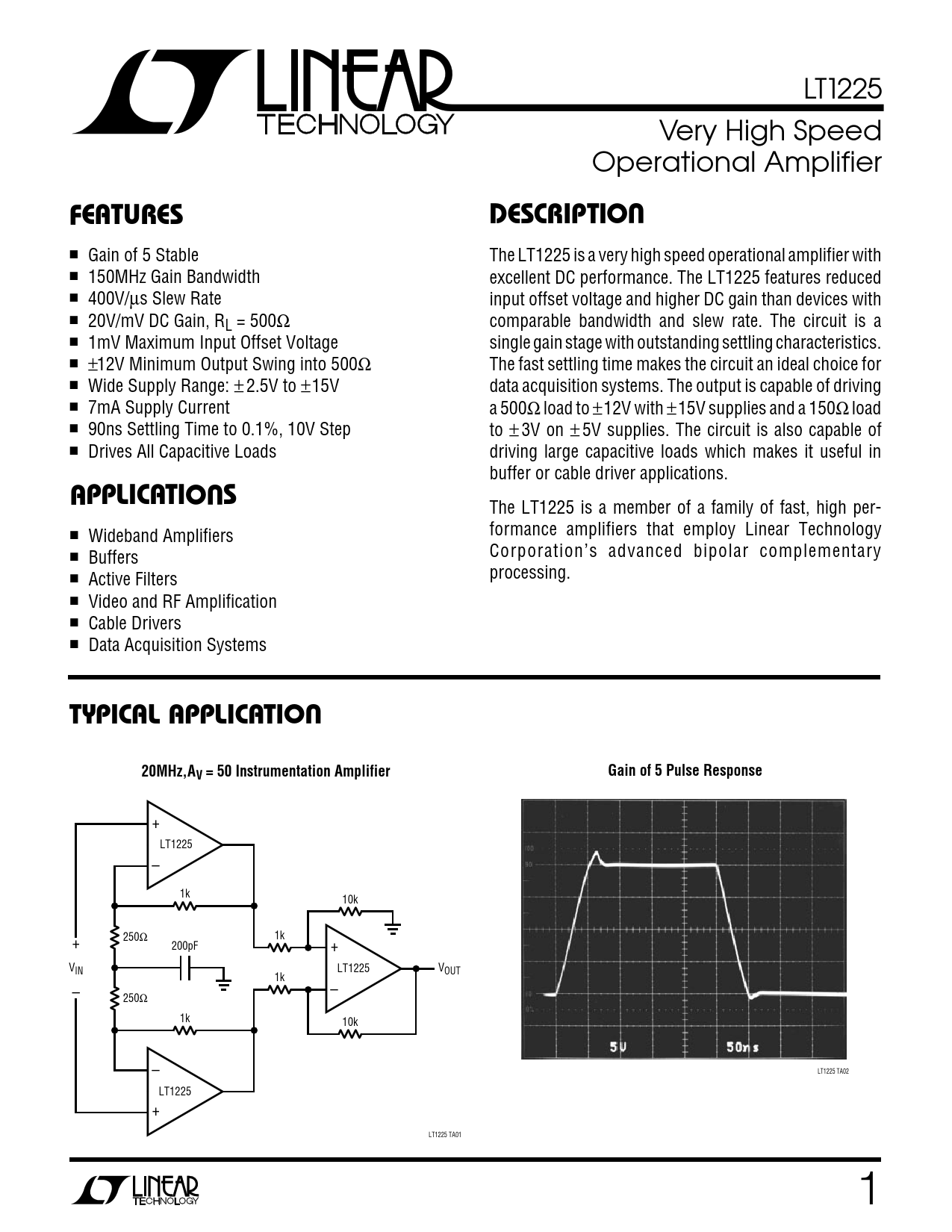

FEATU. DESCRIPTIO. APPLICATI. TYPICAL APPLICATI. 20MHz,AV = 50 Instrumentation Amplifier. Gain of 5 Pulse Response

LT1225 Very High Speed Operational Amplifier
U FEATU S RE DESCRIPTIO
■ Gain of 5 Stable The LT1225 is a very high speed operational amplifier with ■ 150MHz Gain Bandwidth excellent DC performance. The LT1225 features reduced ■ 400V/µs Slew Rate input offset voltage and higher DC gain than devices with ■ 20V/mV DC Gain, RL = 500Ω comparable bandwidth and slew rate. The circuit is a ■ 1mV Maximum Input Offset Voltage single gain stage with outstanding settling characteristics. ■ ±12V Minimum Output Swing into 500Ω The fast settling time makes the circuit an ideal choice for ■ Wide Supply Range: ± 2.5V to ±15V data acquisition systems. The output is capable of driving ■ 7mA Supply Current a 500Ω load to ±12V with ±15V supplies and a 150Ω load ■ 90ns Settling Time to 0.1%, 10V Step to ± 3V on ± 5V supplies. The circuit is also capable of ■ Drives All Capacitive Loads driving large capacitive loads which makes it useful in buffer or cable driver applications.
O U APPLICATI S
The LT1225 is a member of a family of fast, high per- ■ formance amplifiers that employ Linear Technology Wideband Amplifiers ■ Corporation’s advanced bipolar complementary Buffers ■ processing. Active Filters ■ Video and RF Amplification ■ Cable Drivers ■ Data Acquisition Systems
O U TYPICAL APPLICATI 20MHz,AV = 50 Instrumentation Amplifier Gain of 5 Pulse Response
+ LT1225 – 1k 10k 250Ω 1k + 200pF + VIN LT1225 VOUT 1k – – 250Ω 1k 10k – LT1225 TA02 LT1225 + LT1225 TA01 1
