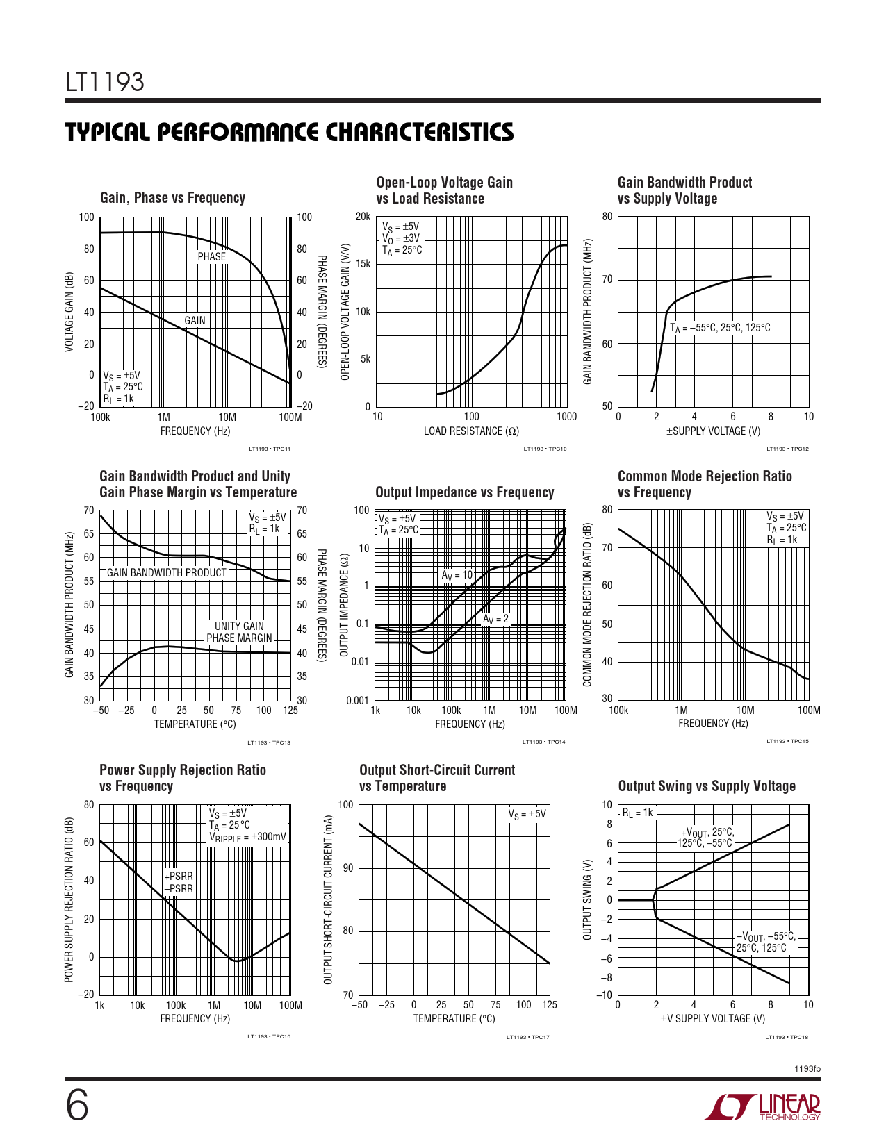

TYPICAL PERFOR A CE CHARACTERISTICS. Open-Loop Voltage Gain. Gain Bandwidth Product. Gain, Phase vs Frequency
TYPICAL PERFOR A CE CHARACTERISTICS Open-Loop Voltage Gain Gain Bandwidth Product Gain, Phase vs Frequency
LT1193
W U TYPICAL PERFOR A CE CHARACTERISTICS Open-Loop Voltage Gain Gain Bandwidth Product Gain, Phase vs Frequency vs Load Resistance vs Supply Voltage
100 100 20k 80 VS = ±5V VO = ±3V 80 80 PHASE MARGIN (DEGREES) T PHASE A = 25°C 15k 60 60 70 40 40 10k GAIN T TAGE GAIN (dB) A = –55°C, 25°C, 125°C VOL 20 20 60 5k 0 V 0 S = ±5V OPEN-LOOP VOLTAGE GAIN (V/V) GAIN BANDWIDTH PRODUCT (MHz) TA = 25°C RL = 1k –20 –20 0 50 100k 1M 10M 100M 10 100 1000 0 2 4 6 8 10 FREQUENCY (Hz) LOAD RESISTANCE (Ω) ±SUPPLY VOLTAGE (V) LT1193 • TPC11 LT1193 • TPC10 LT1193 • TPC12
Gain Bandwidth Product and Unity Common Mode Rejection Ratio Gain Phase Margin vs Temperature Output Impedance vs Frequency vs Frequency
70 70 100 80 VS = ±5V V V S = ±5V S = ±5V R T 65 L = 1k 65 TA = 25°C A = 25°C R PHASE MARGIN (DEGREES) L = 1k 10 70 TIO (dB) 60 60 Ω GAIN BANDWIDTH PRODUCT A 55 55 V = 10 1 60 50 50 A 0.1 V = 2 50 45 UNITY GAIN 45 PHASE MARGIN 40 40 OUTPUT IMPEDANCE ( ) 0.01 40 GAIN BANDWIDTH PRODUCT (MHz) 35 35 COMMON MODE REJECTION RA 30 30 0.001 30 –50 –25 0 25 50 75 100 125 1k 10k 100k 1M 10M 100M 100k 1M 10M 100M TEMPERATURE (°C) FREQUENCY (Hz) FREQUENCY (Hz) LT1193 • TPC13 LT1193 • TPC14 LT1193 • TPC15
Power Supply Rejection Ratio Output Short-Circuit Current vs Frequency vs Temperature Output Swing vs Supply Voltage
80 100 10 V V R S = ±5V L = 1k S = ± 5V T ° 8 A = 25 C +VOUT, 25°C, V 60 RIPPLE = ±300mV 6 125°C, –55°C 4 90 40 +PSRR 2 –PSRR 0 20 –2 80 OUTPUT SWING (V) –4 –VOUT, –55°C, 25°C, 125°C 0 –6 POWER SUPPLY REJECTION RATIO (dB) –8 OUTPUT SHORT-CIRCUIT CURRENT (mA) –20 70 –10 1k 10k 100k 1M 10M 100M –50 –25 0 25 50 75 100 125 0 2 4 6 8 10 FREQUENCY (Hz) TEMPERATURE (°C) ±V SUPPLY VOLTAGE (V) LT1193 • TPC16 LT1193 • TPC17 LT1193 • TPC18 1193fb 6
